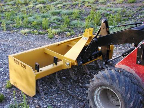

Thanks for the pics and taking time to "eyeball" your setup, in addition to your responses. I think I'll be modifying my Keen Kutter! /forums/images/graemlins/wink.gif
I'm trying to "think through" this whole lift/tilt/angle thing, because one of my "chores" will likely be smoothing down the freshly dozed road banks and getting them in good enough shape to sow some fescue seed to help prevent erosion. So, the ability to reach up onto the bank and drag down would be important...
I'm not ready to go buy a 4-in-1, having just bought a grapple bucket for clearing work and the minihoe for ditching. I'm sure I could do some of this smoothing with the mini-hoe, but it would be SLOW going...

<font color="red"> I'm trying to "think through" this whole lift/tilt/angle thing, because one of my "chores" will likely be smoothing down the freshly dozed road banks and getting them in good enough shape to sow some fescue seed to help prevent erosion. So, the ability to reach up onto the bank and drag down would be important...
</font>
Let's see if these pics help. I went out and set up these quickies. They're not very good but should illustrate the range of motion I have with the QA mounted about 20 degrees back from vertical.
This first one shows the box blade at normal level grading position.
Sedgewood

Wow! That was a great help! Thanks so much for going out and taking pics just to address my questions...
I think I agree that I can "tilt" the QA plate closer to 30-45% or so, and still get the range of motion that I'll need. I'll have to look closer at my boxblade, but I think I can loosen and tilt the existing 3-pt hitch setup backward, then shorten the reinforcing bars that run back to the back of the box -- my 3-pt setup isn't welded like your heavier-duty blade. (This blade weighs just under 300 lbs.)
