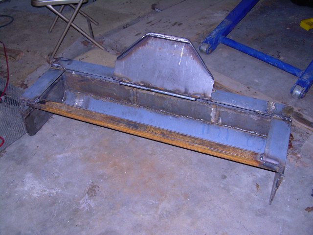

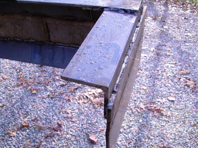

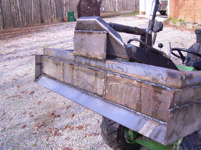

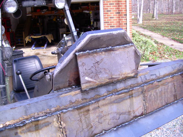

I have the box scrapper operational and testrf it out today. It seems to work as good as the PT one and no welds or metal were damaged during use. I have attached a few pictures. I always wonder if it will be strong enough. Any comments on that would be appreciated. I have not put the two inch receiver on it yet. I am concerned it might interfere with the operation.
I still need to put the little scape blades and support bar on. Does anyone know where I can get these or a good way to make them

Very nice job. With the weight you have a perfect scrapper.
PJ
   / Box scraper questions #68
I picked it up today with the help of a neghbor and it feels like about 150 pounds. I don't have a way to weigh it.

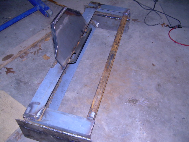

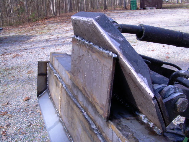

I added a brace across the back. PT has one and even though it seems very strong without, I did not like having the side wings floating in the back. See the attached picture.

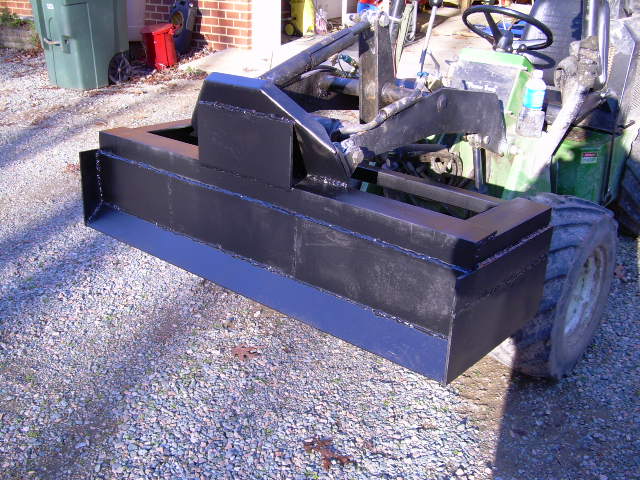

   / Box scraper questions #70

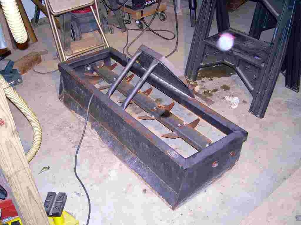

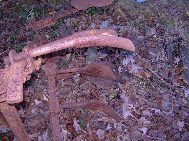

I painted the box scraper. I still need to add the scarcifiers. Does anyone have any suggestions on getting these. I have an old cultivator that I could take the blades off of. Would this work?
Edited: Added picture of cultivator at 4:01 PM EST

Why not use the ripper shanks that are made for box blades. Most any tractor place will have them, or go to TSC. You would have to fabricate something to set them in. On my box blade, the shanks are stored in the slots that are used for digging. A 5/8 pin slides through the shank to store or dig. The shanks cost between $15 and $22.
   / Box scraper questions #72
A guess cost is the main reason. If I can use what I have that's better.
I did a search on TSC and did not find ripper shanks or scarifiers.
We do have some tractor places close by, and I can look there. Do you see anything wrong with the little cultivator blades? The look pretty tough. The shaft is about 3/4 diameter or larger.

Beechwood, thanks. I looked at the site and they look pretty good. I still hoping to get some comments on my cultivator parts. May father-in-law kept this thing for 40 or 50 years and I hope to get some use out of it. I think he would have liked that. I may try it anyway and see how it works. It will be bolted in and can be changed if needed.

I took a few closeups of the cultivator blades today. I think that I can use the blades and the main bar as part of the box scraper.

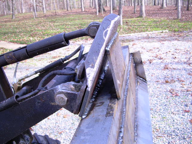

I have added three of the cultivator blades to the box scraper. It looks to me that it could use two more. What do you think? See attached pictures.
