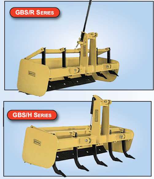

A couple of things here.
First, all these pictures in this thread show roll over box blades.(ROBB) I have to assume that you have NEVER used a ROBB. I hydraulic top link does NOTHING to facilitate the use of a ROBB.
Second, the blue and red tractors have complete top & tilt sets on them, so not sure where you get all these loaded box blades with no hydraulic top links? :confused3:

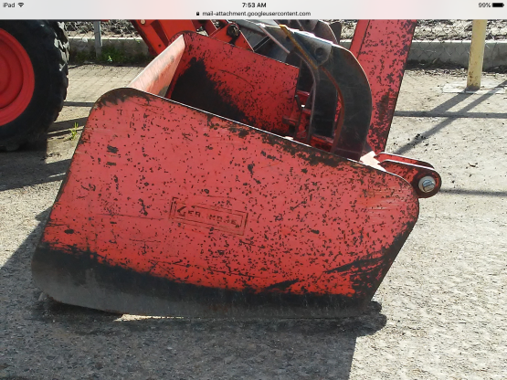

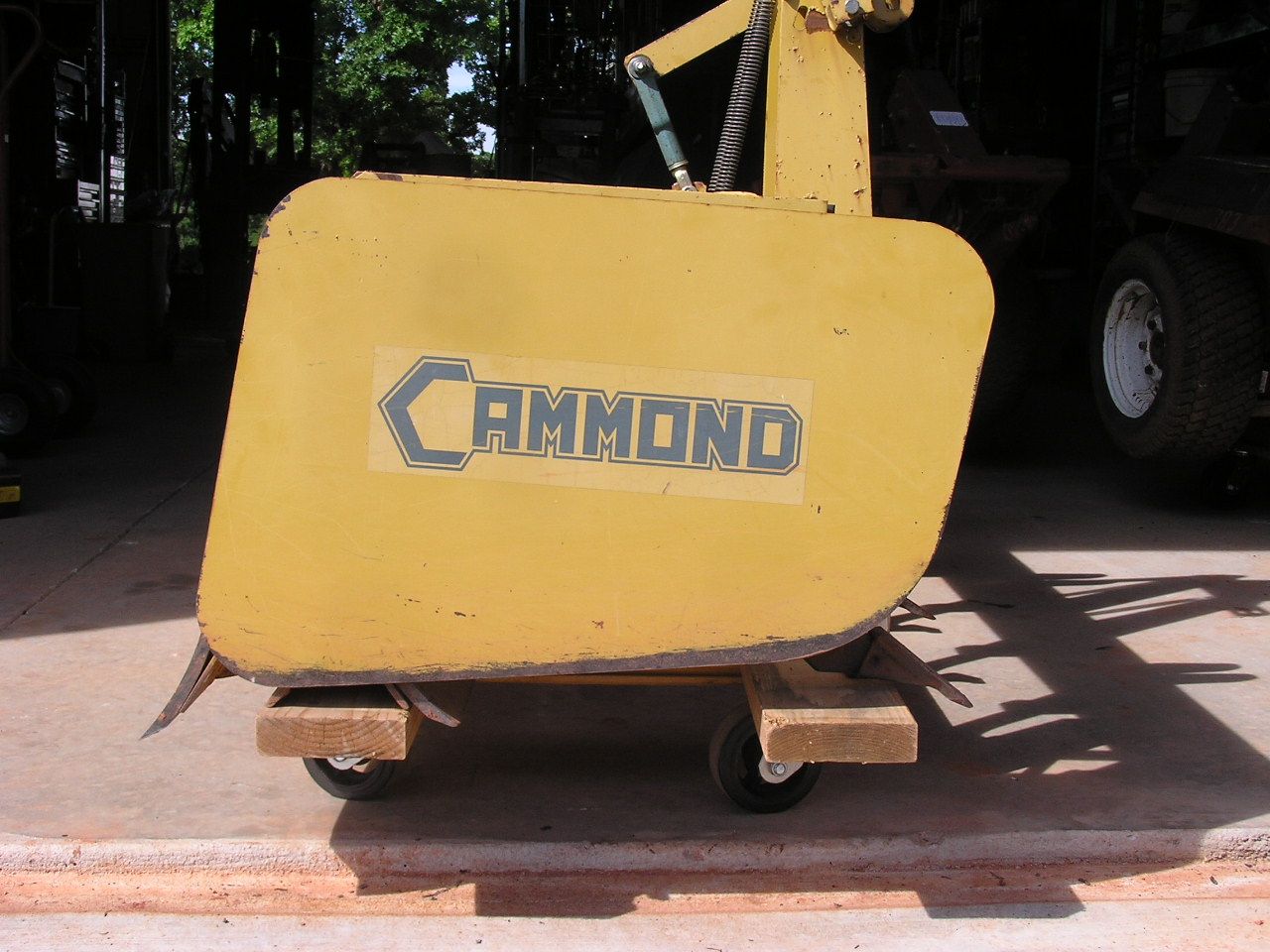

I just bought a Box Blade and have no experiance using it yet, and when I was at a rental yard I noticed how warn down this one was. So when does a box blade become unusable, and if they get ground down this much why don't they have replaceable edges or hard facing on the bottoms.
If the front is doing more than just touching the ground the top link is too short. By pressing down on front you are lifting the cutting blade.
You will need to verify the forward cutting edge length before you attempt to extend the side back to factory length. From the picture it looks like that cutting edges are about an inch or so below the side. That is about right. Raising the sides could pull the front cutting edge off the ground and it would ride on the back blade- not good for cutting.
It might not have much wear. Look at some new ones, most side plate top and bottoms are not parallel.
Mine has some wear, but still works well. :thumbsup:

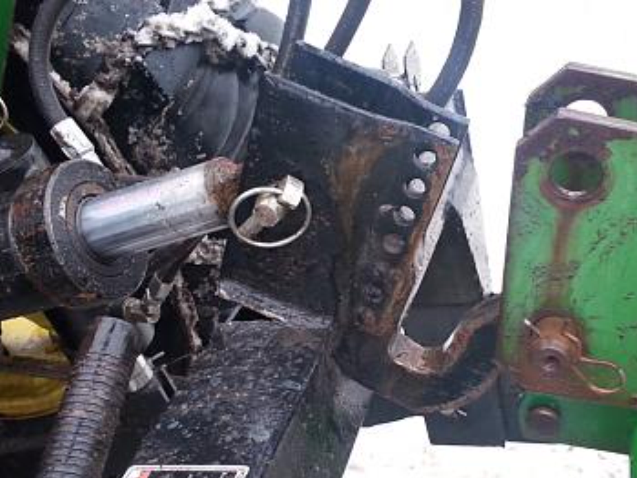

When you install a hydraulic top or side link dont you have to be careful that you don't do something like this. This was a photo I found on google images from another forum and if I remember correctly he said he was backing up and caught his blade on the ground and this was the result to his HF quick hitch.
