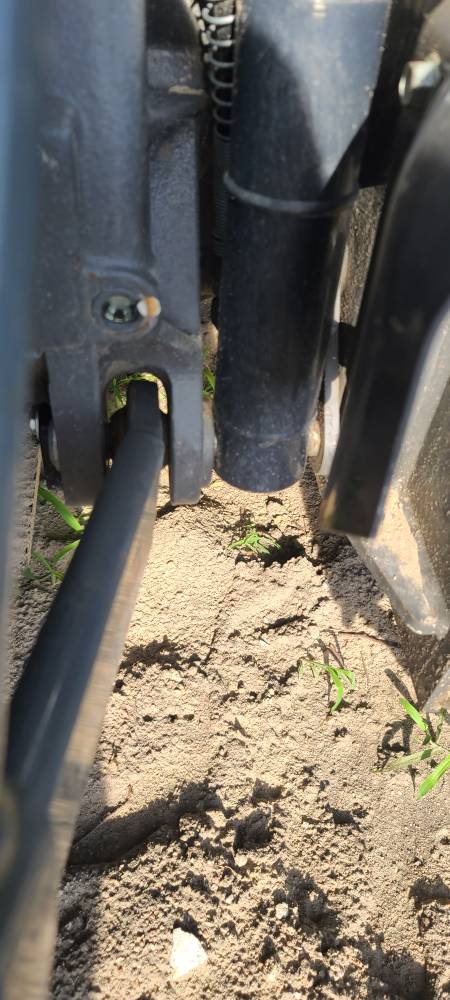

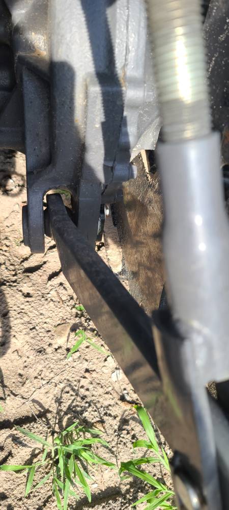

Looking at the op first pic, comparing to pg 3, post 25. The arm is on the opposite side of the casting. Which is correct? Have to look at my 1742 to see how mine is mounted. Has me concerned.
   / Brand new 1735M broke after ~3hrs of use. Is this a freak occurrence? #120
If you blow up pic in post #1 to maximum, on big screen it appears the stud has a step (shoulder) on it so stud can lock into mount and arm can still pivot on stud, it appears it will assemble only one way, the way it was done....
And it does appear that on both sides the 3PH arms are on inside of tabs....Don't think your observation is valid....
