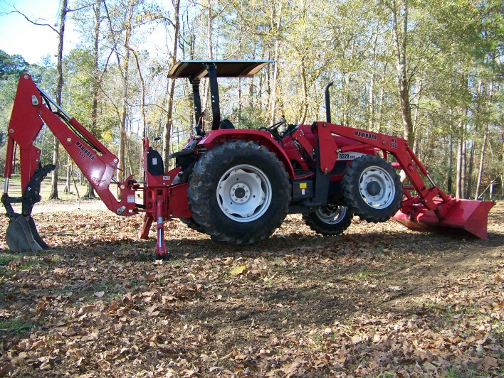

Oh no the boom wont come close to lifting that tractor its no industrial machine.. I just meant the outriggers
just out of curiosity the rear remotes for the back they are both in the neutral position right? If im thinking right one has a detent its not hard to bump one out and it keep trying to push fluid
Uh...................... 12-31-07 Tractor jacks.jpg..................... I respectfully disagree with that. Photo is of my 6520 lifted completely off the ground. I can lift the rear end off the ground with the outriggers OR the boom.
