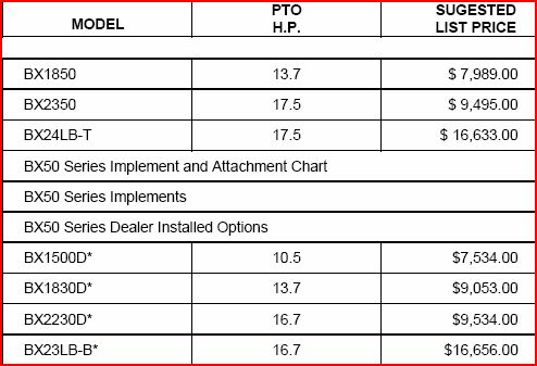

   / Brand new BX 1500 (well almost) #23
Looked at 2007 whole goods price lists which has the crossover years. Difference in HP between all 3 or the BX series. 2200 has more HP than 1800 and 1800 more than 1500. The 1800 is not a re badged 1500.
9*Difference in HP between all 3 of the BX series.
10*The 1800 is not a re badged 1500.
