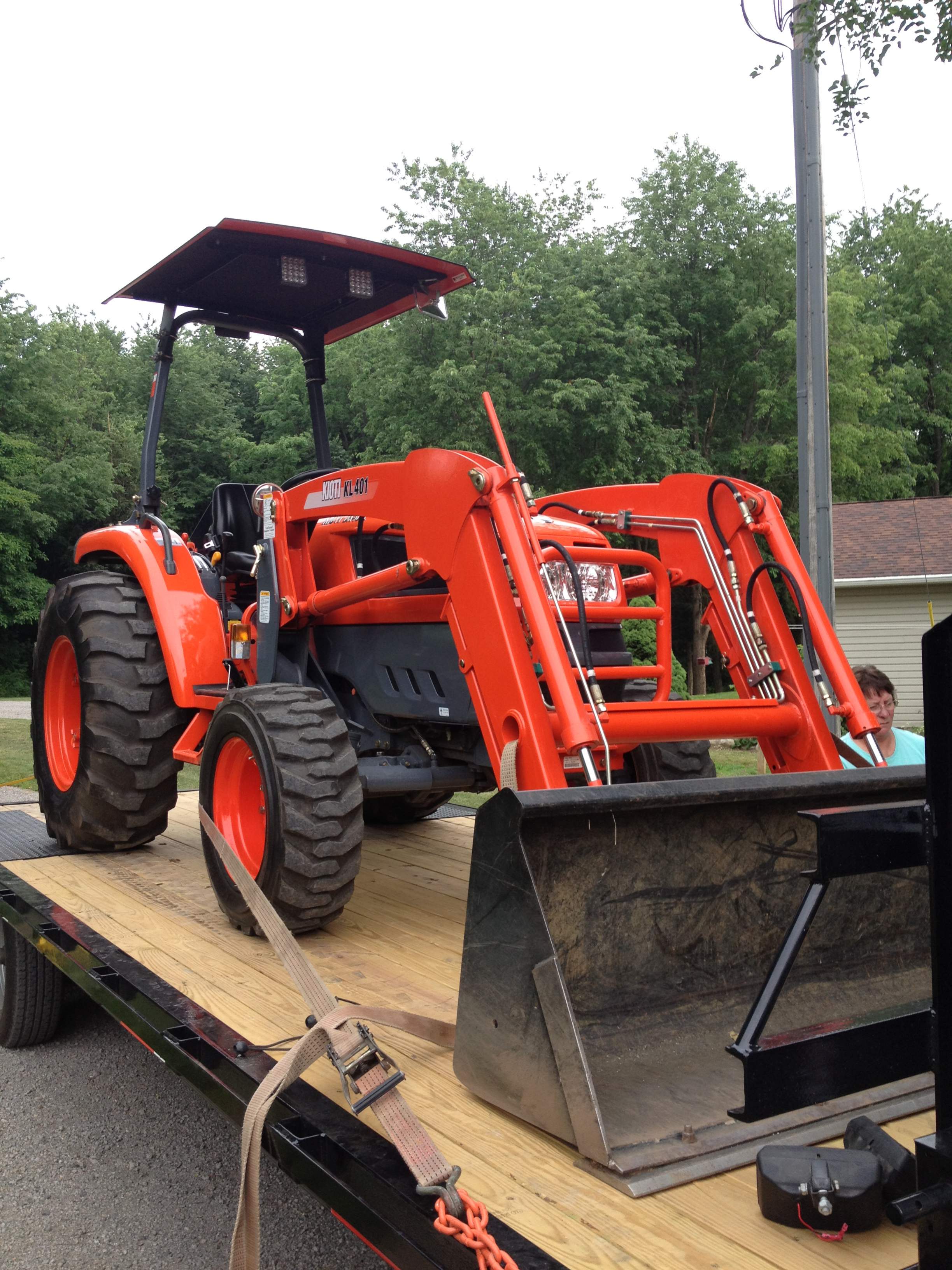

Hey guys, just bought my first tractor, KIOTI CK3510 HST and wanted to see if anyone has any better ideas to resolve problems with KIOTI. I bought it brand new off the dealer lot. Started it up for just a minute and drove it on my trailer. Got it home and the unit shut off and check engine light came on. Ran it 2 hours away back to the dealer and they replaced the fuel rail. It ran fine idling for 30 min so I trailered it up and brought it home. Used it for an hour driving around and tractor shut off with check engine light. Now days later dealer hasnt even looked at it yet and said they wont expedite parts. KIOTI wont answer my voicemails or emails. They answered facebook and just said "talk to your dealer". Anyone deal with this before and know how to handle it? The tractor has less than 5 hours on it and over half of those were the dealer testing and make ready.
I'm really sorry you are running into these issues. I'm a new tractor owner and have had my KIOTI CK3510 HST for a year now, and while I've made some new tractor owner mistakes, everything has been very reasonable with my dealer up here in Northern Kentucky. I get that COVID-19 might be to blame for the wait times and inability for dealer to look at it but how they appear to be treating you sounds downright criminal. Your dealer should be working with you. I have to agree with some of the other comments on documenting this case, and letting the dealer know you expect resolution. These machines cost too much for someone to take a hands off approach especially with a brand new tractor. Good luck, and yes, Kioti would refer you back to the Dealer since this is the dealer's liability, which then becomes Kioti's where machine fault is found, which is why we have warranties on these machines. Best of luck with your job and getting your situation taken care of. /Jeff

Got to the dealer today. They did get KIOTI involved and ended up finding a short in the harness. I talked to a service manager at a different dealer and they mentioned it seems to be getting much worse QC lately since the dealers are short on inventory they're rushing units. Either way I'm out hundreds in rentals to get the job done I bought this tractor for and therefor going to sell it and get a Kubota or mahindra etc that I trust more.
And now that the bug is worked out, you are gonna try your luck again? Pretty foolish, IMO. What this really seems like (and I suspected from the start, since you didn't have the thing but a few days(?) before riling everyone up about 'how bad Kioti is') is that you didn't *really* want the Kioti and only bought the tractor 'cause it was available when you needed one.

Well from my perspective, the Kioti dealer and Kioti Corporate advisor did a great job getting this new Kioti up and running. However, dealer preparation should have identified the electrical harness issue before delivery. I always like to see 3 or 4 hours on the machine before delivery. Typically that implies those hours of run time were for dealer preparation.
I seriously doubt the fuel delivery rail needed replacement on the tractor. They are rated at 6000 hours before failure.
