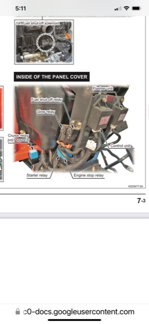

I was looking on the service manual and looks like there may be another relay to test. Can you confirm you see the blue relays below the ones we Have been testing?
   / Branson 2400H fuel shutoff solenoid troubles #38
If you can confirm the two blue relays try swapping those as a quick test to see if the solenoid plunger stays in when you cycle the switch. I believe the one we were testing was the pull and not the hold relay based off your description of the last test.
Our focus needs to shift to the blue relay labeled Engine stop in the screenshot I posted.
#39
Yes the 2 blue relays are below the pull relays. I'll test that this morning. I did remove one then the other and it didn't affect power to the solenoid. I didn't swap them though.
   / Branson 2400H fuel shutoff solenoid troubles #40
Ok now I a good idea what you are dealing with. When you are checking power to the solenoid what color is the wire that has power?
