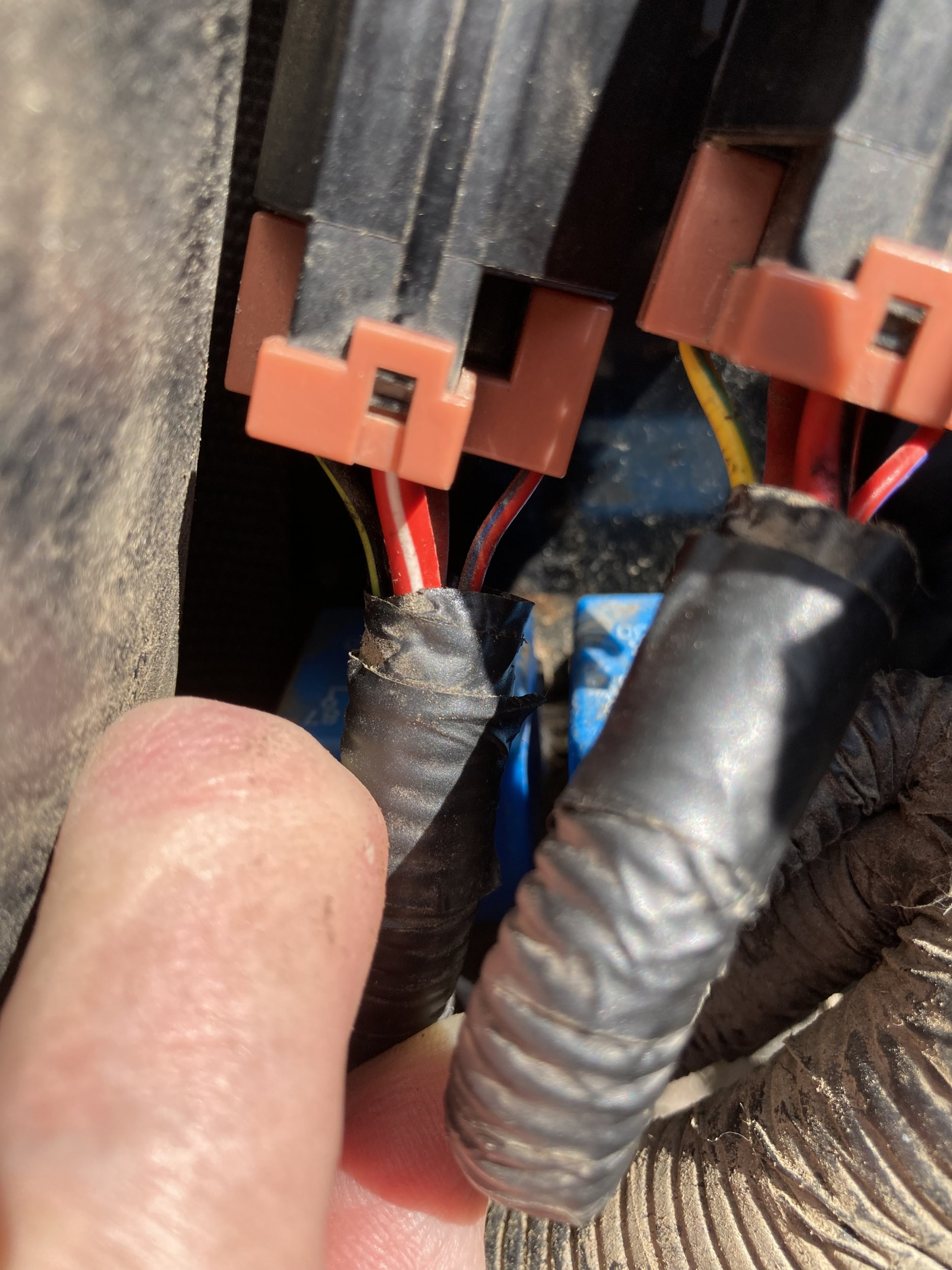

Yes the test light was clamped to the positive battery post and the pin on the brown wire. Are you saying that the solenoid plunger should stay in? I tried it again, I can hear it click in then out.

Now we will need to confirm the stop relay stays powered. Have you identified which one is the stop relay?
One is the pull side and on the wiring diagram it is labeled as a glow relay. We need to find the one marked stop relay on the diagram. I need to see the color wires going to it.

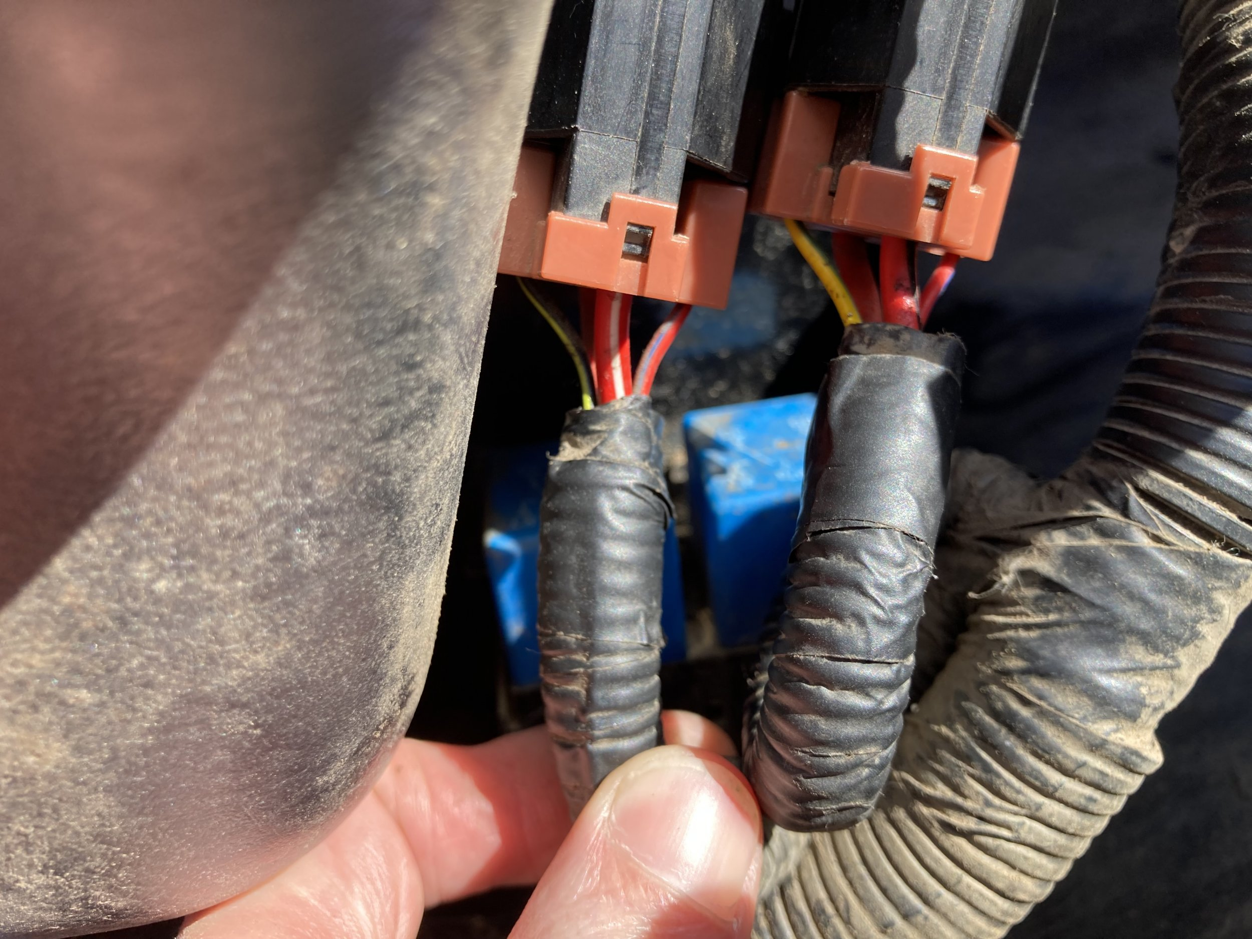

There are 2 relays that attach under the Controller, both are 12v 70A, one of them I disconnected yesterday and the Solenoid had no power. The other relay didn't affect the Solendoid when I disconnected it.
   / Branson 2400H fuel shutoff solenoid troubles #24
Ok can you get a picture of the wires going to both then?

The relay on the left when disconnected causes loss of power to the Solenoid.
   / Branson 2400H fuel shutoff solenoid troubles #27
Ok so the one on the right is the hold relay and the one on the left is the pull relay.
   / Branson 2400H fuel shutoff solenoid troubles #28
So after you turn switch to start and back to on, with the test light clamp on a good ground, do you have power to the small red wire with the blue line on the right relay?

I just looked at what I typed and had left and right reversed. 😂 I fixed it. Been a long day
