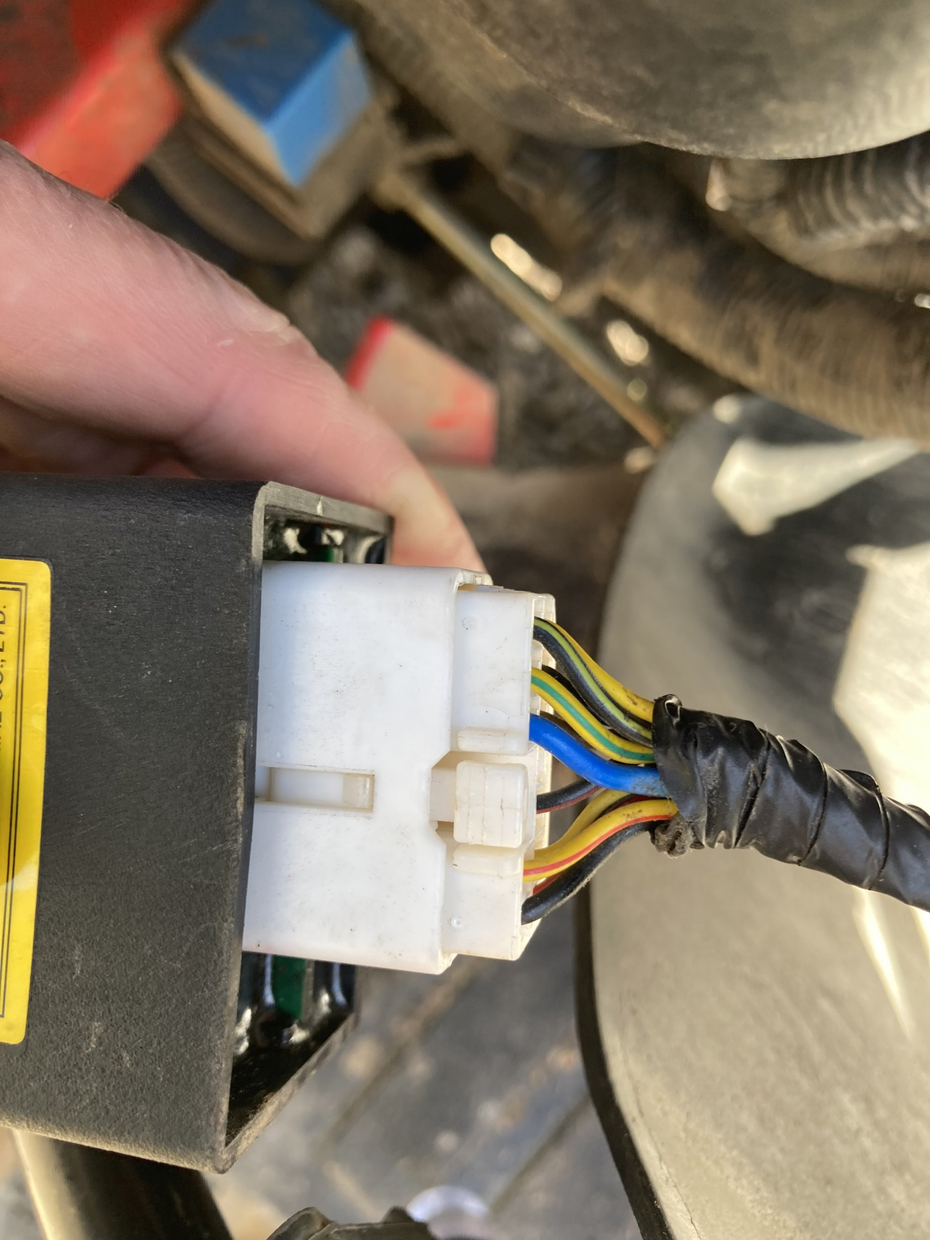

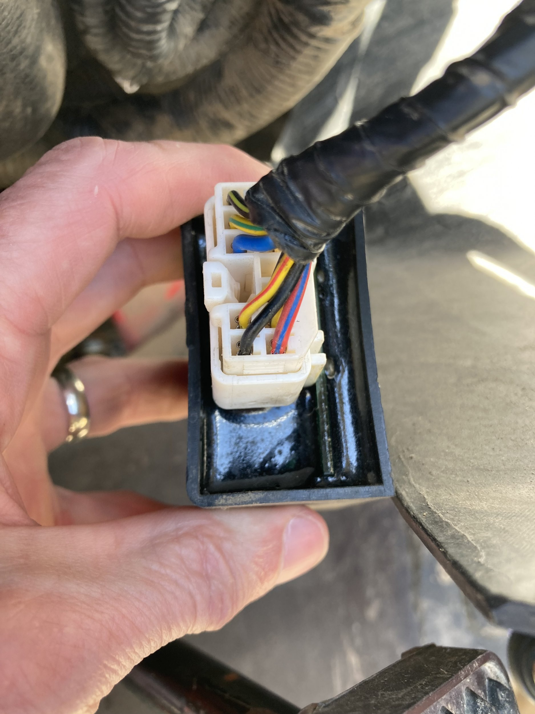

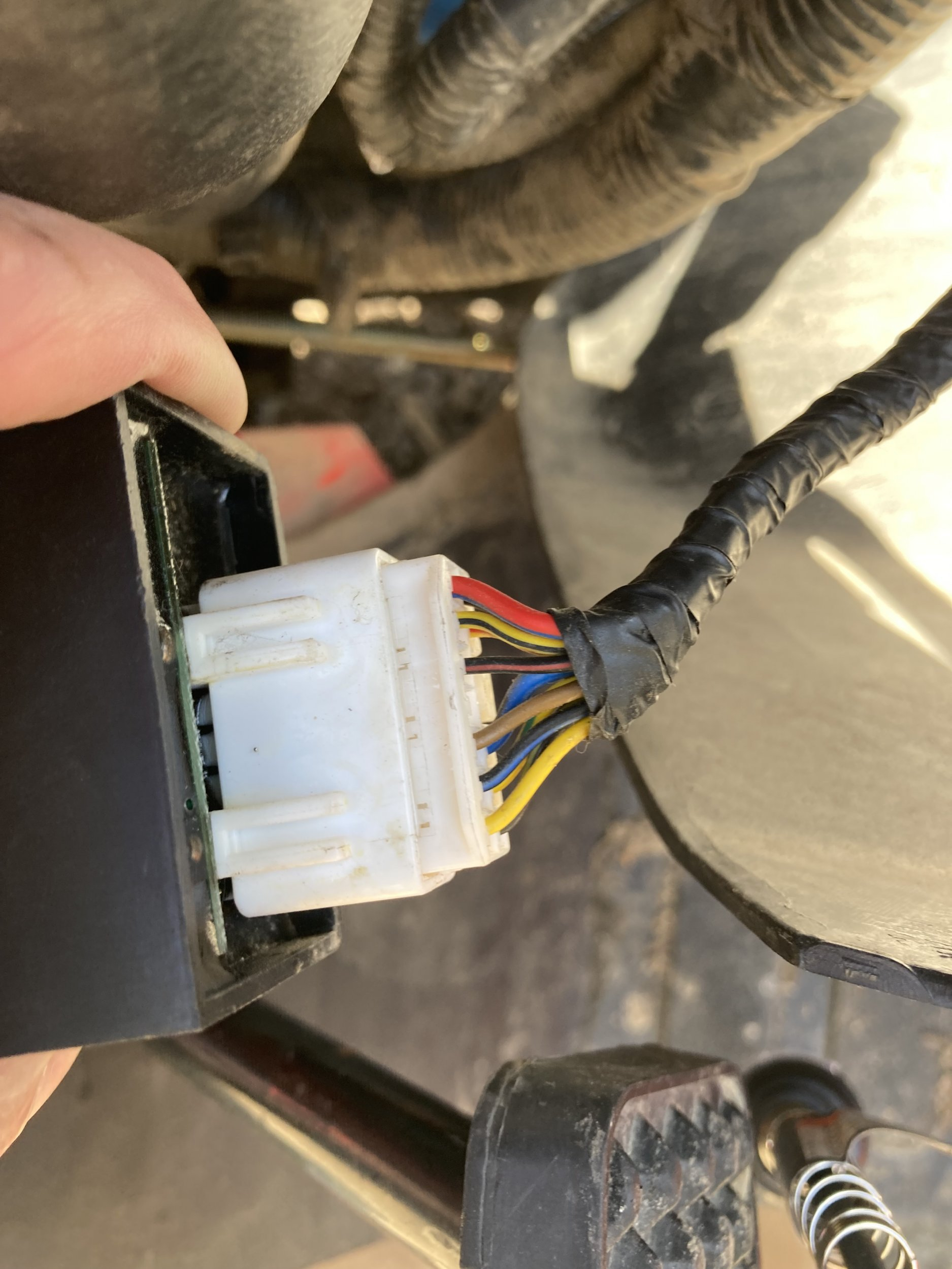

I'm getting power through fuse 4. On the controller, 3 wires light up. A black wire, a yellow with red stripe wire and a brown wire. Not sure which wire on the plug would be number 10. I've attached pics.
   / Branson 2400H fuel shutoff solenoid troubles #18
Brown should be number 10
#19
Ok. That wire lights up.
   / Branson 2400H fuel shutoff solenoid troubles #20
So it lights up with the clamp on positive and using the pin on the wire? If so then the relay should stay in.
