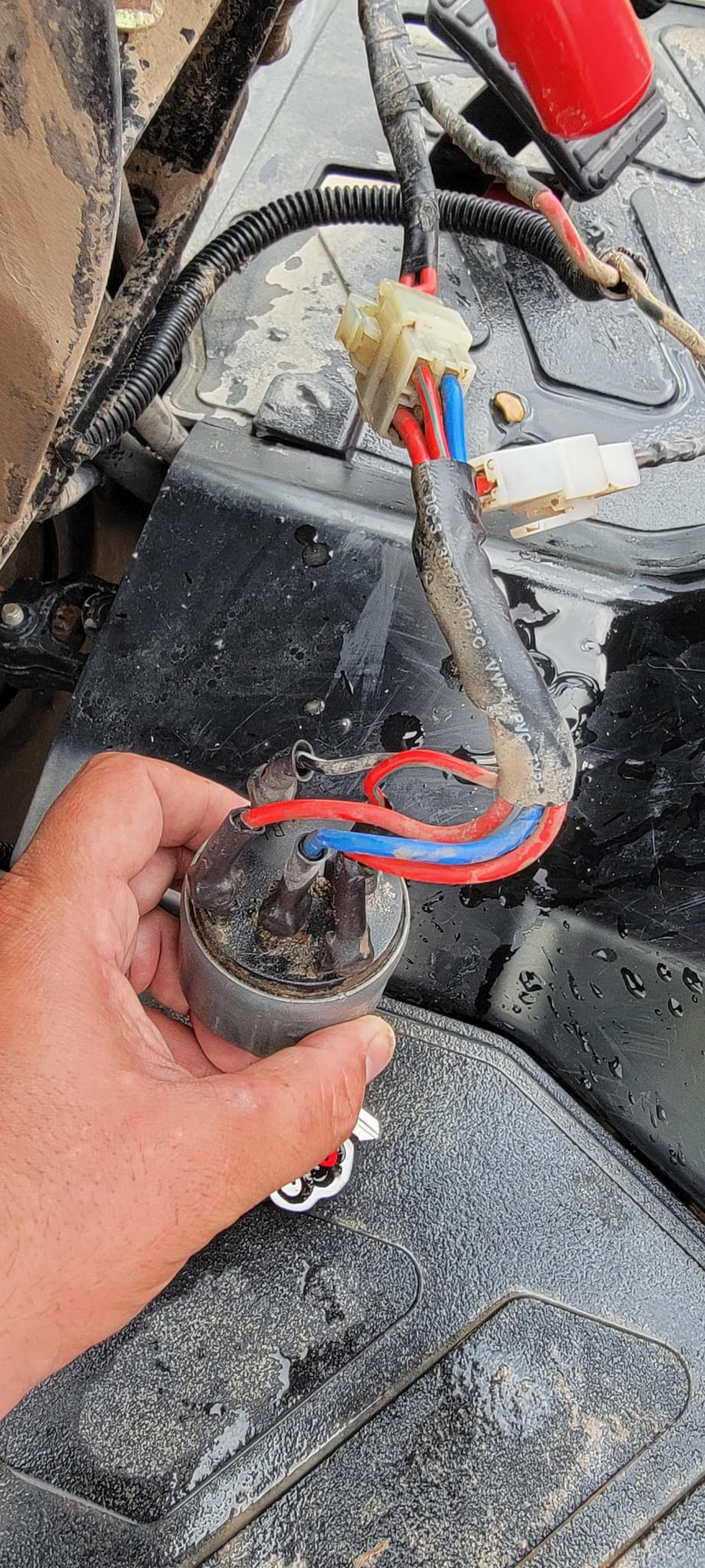

While you are taking picture, can you get one of the back of the key switch where the wires are connected?

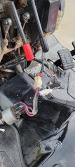

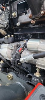

Can you post pictures of the starter with all the wires connected? Try to capture the harnesses around the starter in the picture as well. Is there a plug not being use that is close enough to reach the starter?
I checked the starter... Everything is working as you explained... As far as the pics, here you go... The wires that have the Loom Conduit Tubing, that's the kill switch wires that go to the kill switch... So technically the pigtail to the far right should be one straight wire

Here is the picture of the starter and it's wires... The smaller wire you wanted me to check is in the back of this picture... The reason I did this angle is so you can see the back and white wire under the starter... Same colored wires that go to the shut off solenoid
