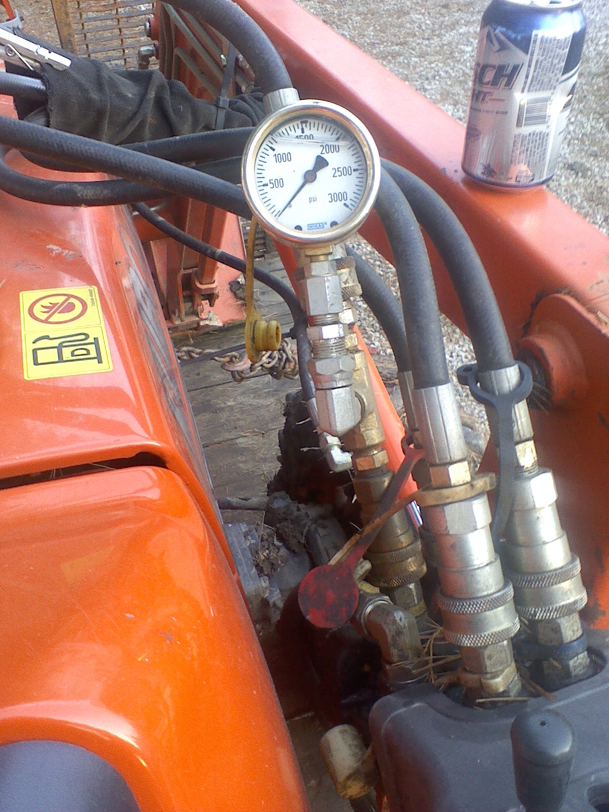

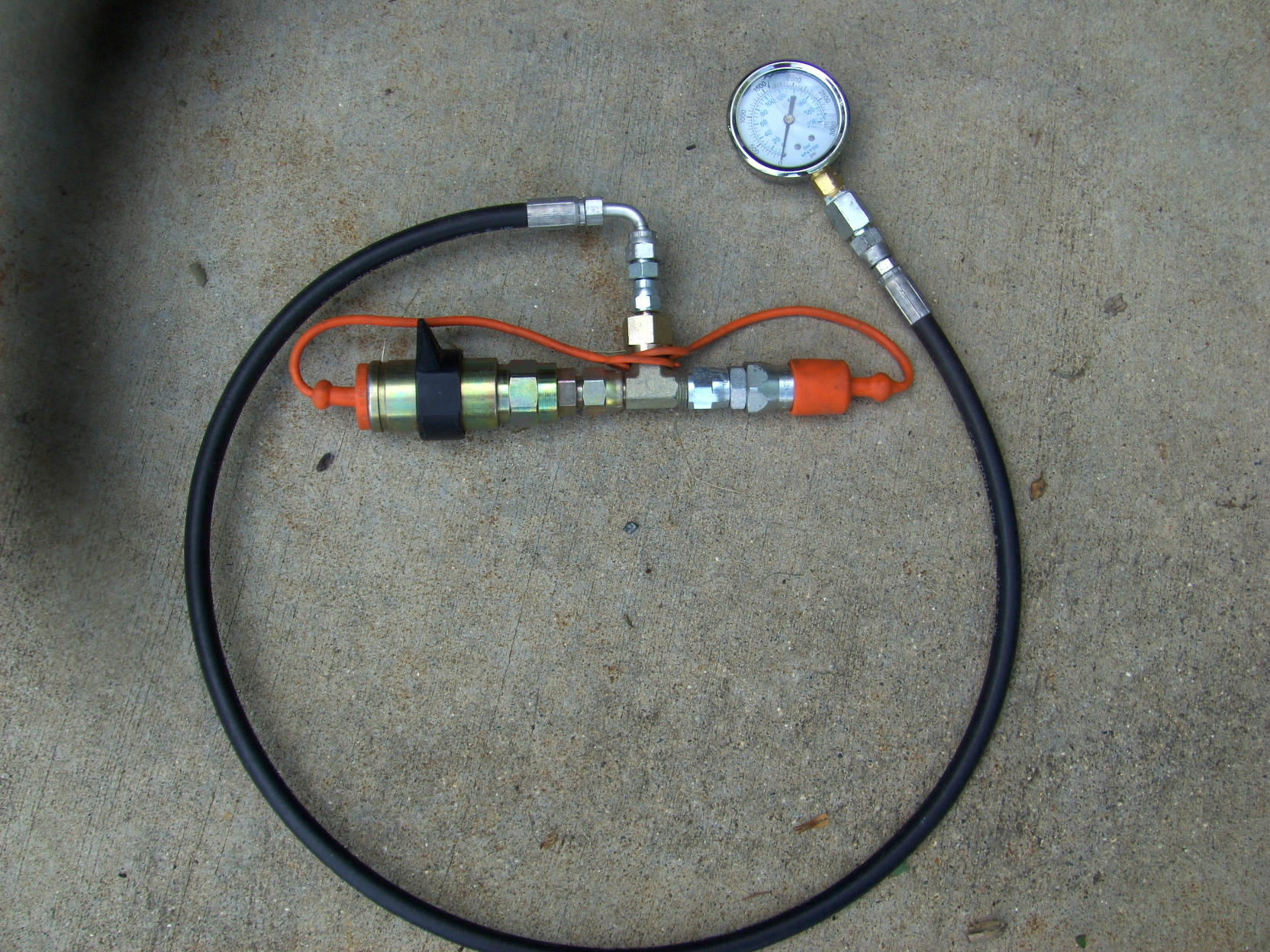

Install a $30, LF hyd gauge 3000 to 5000 psi test unit, and check the pressure .
Install the gauge in a tee in the IN port of the loader valve.

I just talked to the Branson dealer and he suggested the same thing. I've made some calls to NAPA and such and can't find a gauge locally. I really need to get this thing back to work.
I have a backhoe on the tractor and it's operating, but very slowly and no pressure. It operates off the hydraulic rear remote. Am I correct in thinking that if it's a problem with the loader control valve that the backhoe should still operate normally? I guess that I'm not sure how it works.

When I run the hydraulics at max RPM there is some improvement but not nearly enough to work the tractor. For example, at idle, the loader will not move. At max rpm, it moves the full range empty, but will not move with a light load (manure) in the bucket. The dealer is leaning toward a bad pump. I ordered a gauge to install inline on the output of the pump, but it won't be here until tomorrow.

I got the pressure gauge today and picked up the wrong adapter so I couldn't check it. However I pulled out the relief valve and checked it out. Not much there. A spring and a flat washer type thing at the bottom? It looked clean. Could the spring be weak?
I had the hose coming into the loader control valve off. I cranked it over and got a solid stream of hydraulic fluid over my head and the rops.
I put it back together and ran it for about two minutes. Same symptoms. However I did notice that the pump was hot. There is a second pump for power steering mounted in front of the pump that was cold to the touch.
