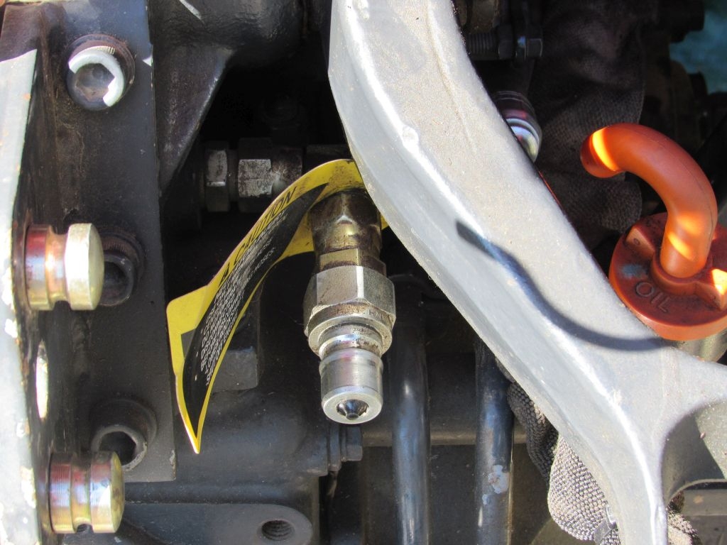

I don't want to waste any ones time but this is the "nozzle" that has a connection to the case of the lift arm and another connection to the hoses I replaced. It is 7 feet long and goes to a connector on the joy stick.
I got the hydraulic system from Branson schematic and it clearly shows that the high pressure line ends up at the Lift arm case and back to the joy stick.
