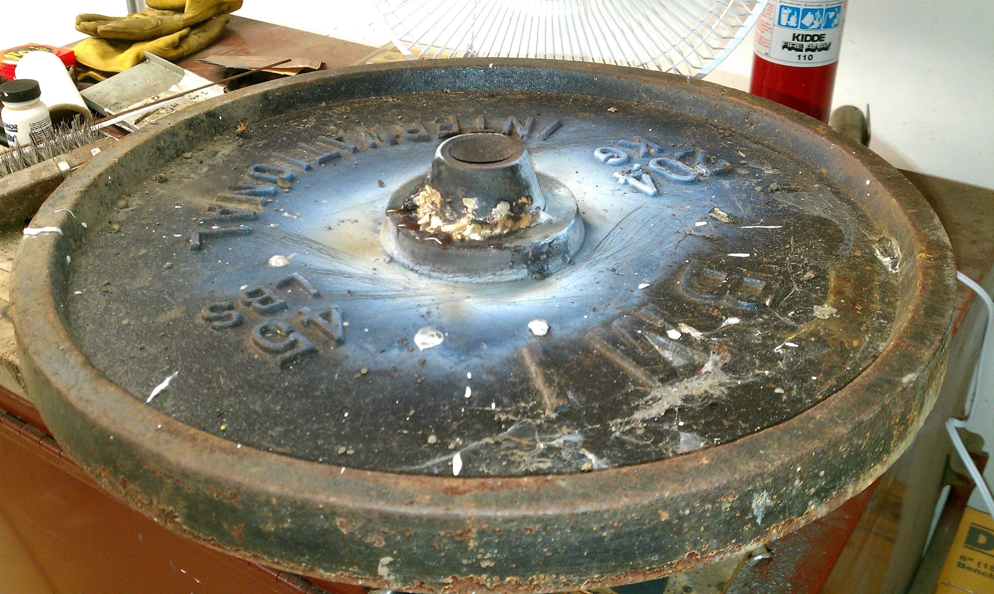

Trying to Ox/Ac braze collar to weight lifting plate shown in photo. Using flux coated bronze rod. Makes a big mess but seems to hold ok. Surprisingly the plate seems to take the braze better than the little collar. I ground both down first so they're clean. I'm using a large tip on my torch, it gets things hot but I don't seem to be able to control the flow of the material. Any help appreciated.

How I learned to do it is to heat the base metal to a dull cherry red, and let the heat of the base metal melt the rod, not the torch. If you have the metal glowing bright red or orange, it is too hot, if you have to melt the rod with the torch, it is too cold. Think of it more like soldering then welding.

Maybe that's why the plate takes the rod better, it's not so hot. I have one more to do, will try again. I don't have a rosebud, maybe that would be better.

I would just use a big welding tip for that, if your biggest welding tip wont get it hot enough, in a reasonable amount of time, just use a cutting tip, but dont push the cutting leaver.

Hot enough to melt the bronze is hot enough. I love brazing stuff. It can fix a lot of things.

I was using my biggest welding tip, cranked up the flame quite a bit more on the second one and that seemed to help. I also did better preparation and fluxed the surfaces before I started. I think the plate was just such a huge heat sink that it was very difficult to keep it hot enough over a larger area without melting the parent material in one small spot. Anyway, the job's done now.

I do think that the huge mass of cast iron was making it harder to braze, glad you got it done. Why did you have to braze flanges onto the weights anyways?

I'm sorry, but I'll have to disagree.
The base metal has to be hot enough to accept the bronze. Otherwise, the bronze will just set on top in globs without melting into it and making a strong bond.

I was talking about the metal. What else but the rod is there? Anyway, when the bronze flows, it's hot enough. Any more heat than that isn't needed. The guy who taught me was eight years older than the twentieth century (if you asked him his age). Now I'm gettin' kind of geezer too.
