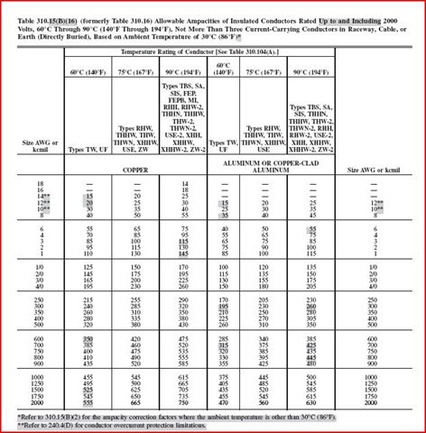

Depending on how far from the panel, the duty cycle for the welder, and if you plan on upgrading to a welder with a higher duty cycle here are a couple charts to help. Below 100 amps use the 1st column and multiply using the derating factor for the duty cycle. Or don't de-rate and you are good for 50 amps non continuous use. 1509903101974.jpg1509903141970.jpg

The breaker is to protect the wires to the outlet and should be sized accordingly.
