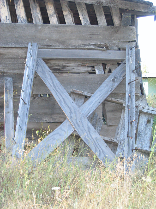

   / Breaking new ground. What a PITA. #15
Did someone say "drag" - yes, I heard it. This is what I made with some junk lumber. Notice the spikes on the leading/trailing 4x4's. I pull this with my ATV. It does a wonderful job of soothing out broken ground. Makes a whole lot of dust also.
