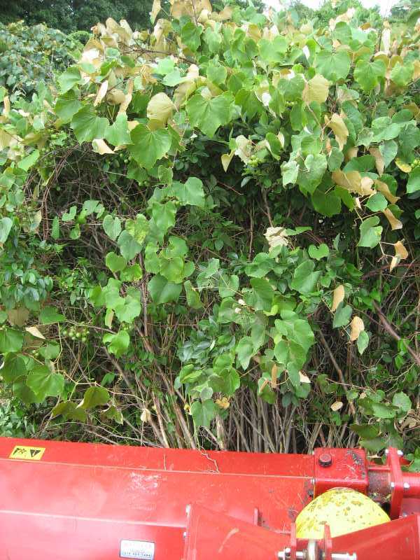

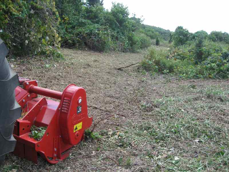

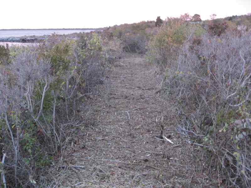

IslandTractor, I've been reading some of your other posts regarding your Flail Mower. Great info! I'm starting to consider one of these now. And from one of your pics, you're next to the Ocean? Love it.
http://www.tractorbynet.com/forums/attachments/98326-caroni-flail-mower-hydraulic-shift-3.html
Looks like you have the "B" type Rotor with Shackles. What do you think is the application difference between "B" and "A" type Rotors? They have the same number of blades. Are the Shackles for heavier brush? I'm guessing the "F" type would be for finer cut mowing.

Yes, I have the B type knives. The F type are for finish mowing. I don't know what use the A type have as they are very similar to the B except for the shackle. The shackle provides more flexibility when hitting rocks etc. and moves the knife a little further from the drum so increases knife speed somewhat too.
I'm very happy with my Caroni TM1900. If it disappeared tomorrow I would order another the next day.
