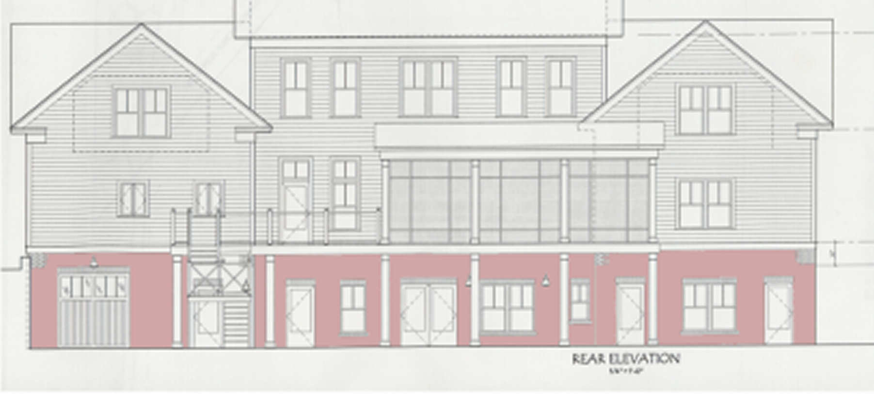

I've got a couple of questions that I didn't want to get lost in my home construction thread. So I thought I'd just start a new topic for this.
My builder told me the other day that we need to start looking at brick colors for our house pretty soon. Our house was designed to have a farm house look and will have Hardiplank siding on the main structure. However, the exposed portion of the daylight basement is scheduled to be veneered in brick. From the front of the house, there will be about 2 feet of exposed brick. The property slopes from front to back such that on the back of the house, the entire 10 ft height will be exposed.
The builder suggested that we begin by looking at other homes to see what we like. My wife and I are at odds on the colors of brick we have seen. One thing we both like, however, is the homes that have stacked stone.
So, with that bit of background, here are a couple of questions. Does anyone know an approximate cost difference between brick and stacked stone (maybe expressed in terms of a percentage)? I'm thinking real stone will be a budget breaker, so what about the synthetic stone? Has anyone used the synthethic products as an exterior veneer? Do they look close enough to the real thing to be attractive? How do they hold up over time? Cost of synthetic vs brick? Finally, I've attached an image of the rear elevation of the house plan. The shaded area is the area to be veneered. I would like opinions on the esthetics of brick vs a stacked stone for such a large area as we will have on the back of the house. My wife is concerned that it may not look good in this application.
Thanks for any and all replies. If anyone has photos of their property where stacked stone (real or synthetic) has been used in a similar application, we would love to see it .

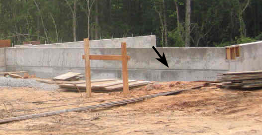

Each method has a different aproach. If your putting up brick, then you had to have poured a footing to support it. The brick is then laid with a space between it and the wall.
Again, bricks vary on cost, but should be under $2 a sq ft.
The rock is attached to the wall. Is your wall built for this, or do you need to add lathe? Might be a consideration.
Sonds like you are in a win-win situation. Either way you go, it will look nice.
Eddie
   / Brick vs Stacked Stone
<font color="blue"> If your putting up brick, then you had to have poured a footing to support it. </font>
The attached photo shows the brick ledge that was built into the forms when the walls were poured.
If we used stone, I assume the lathe would have to be added.

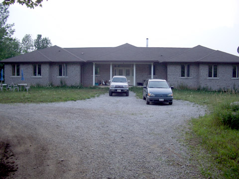

Heres a sort of third option.
When I wanted to start the brickwork on my house when I discovered that bricks are 6 months+ backlog around Toronto. My bricklayer suggested a product call Soltice Stone (spelling?) which is a brick material made of concrete. The 'bricks' are split so they look like stone blocks (really they do!). Because they are made of concrete they don't fall apart like bricks do.
However, they cost about 50% more /forums/images/graemlins/shocked.gif , even though delivery was 2 days after order.
However, because the average stone/brick is much bigger than a real brick, the labor cost was much lower. So the net cost to me for a premium product and a premium look was more or less the same as 'plain old brick'. /forums/images/graemlins/cool.gif
You might ask some brick layers about the total costs ...

   / Brick vs Stacked Stone #14
Its a bit of a mess - its still a work in process.
I paid for the excavation, concrete work, and brickwork.
Everything else I did myself (usually alone)
From the front

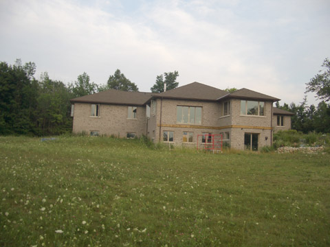

   / Brick vs Stacked Stone #15
From the back
Scaffolds are there in prep for the deck I'm gonna start later this summer. (an excuse to get a drill ..)

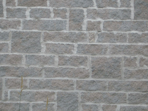

   / Brick vs Stacked Stone #16
Finally a closeup of the 'brickwork'
I've been taking it easy lately - the 'boss' ordered me to build a barn but I cheated and subbed out the construction. I did all the wiring, insulation, and walls myself, though.
