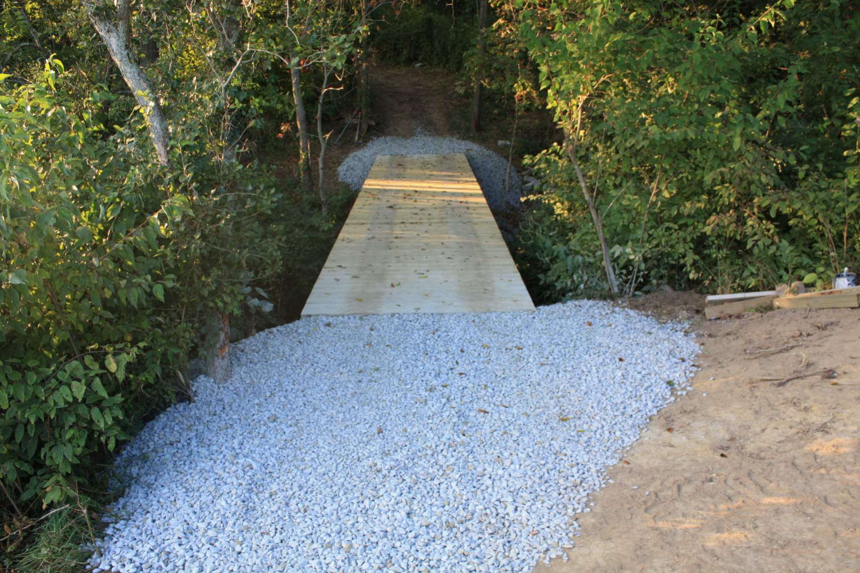

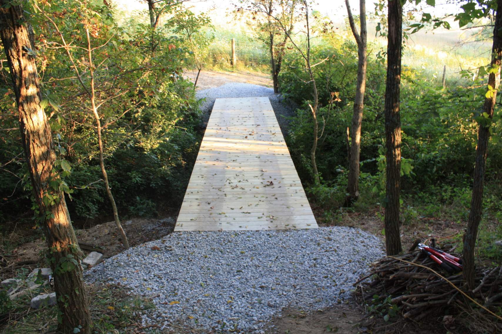

A couple pics of the other side backfilled. I started on the rails, not much done yet. I think i'll go with wooden rails kinda like my first bridge, but tapered down on the ends.

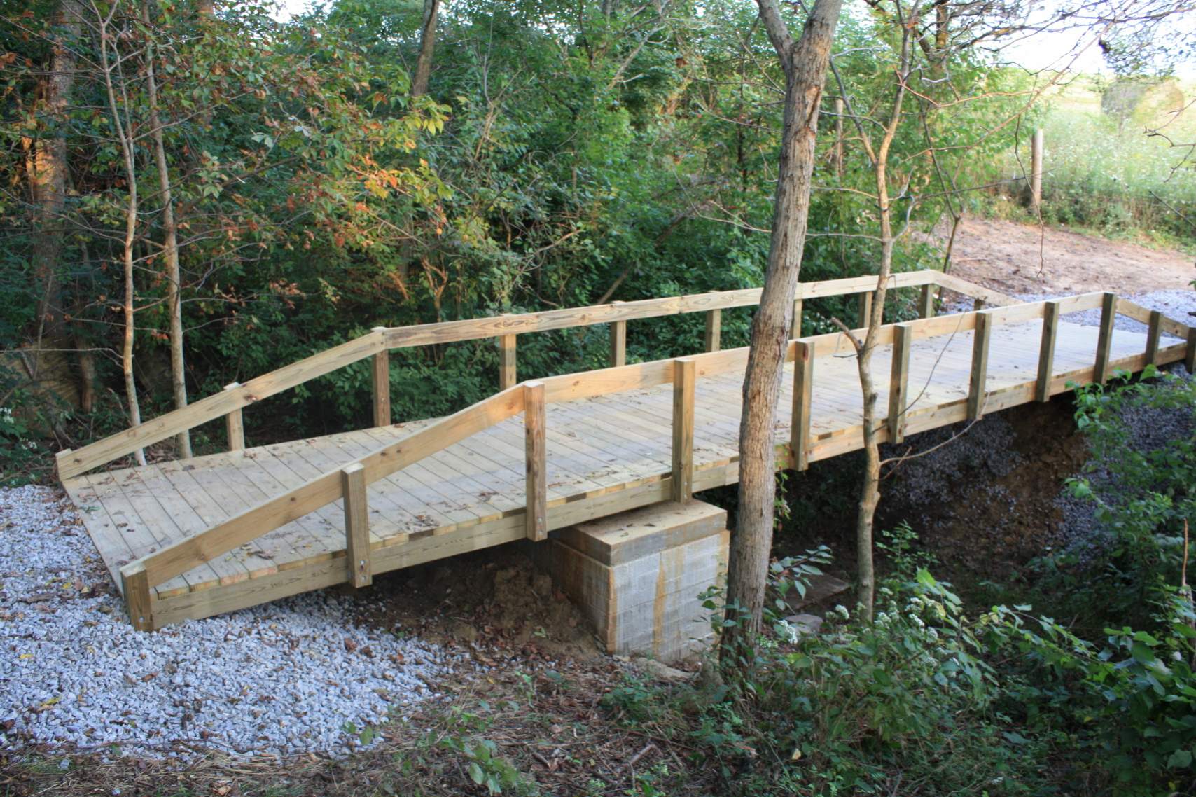

I may start on the rails tomorrow, not sure how i'm going to do them...any ideas?
Are you wanting the rails to keep people on the bridge or tractors? A suspended cable supported by 4x4 stanchons every 4 ft or so may be adequate. It wouldn't be good for small children unless you put 2 or three on each side however. That design would be relatively quick and easy and probably not too expensive.
If your like me you're probably tired of building bridges and would like to put this one behind you and move on to the next project.
Something like this....[/QUOTE]
I like your idea. Thanks for the drawing. I kinda want to keep it wood. The rails will mostly be for looks, but there will be little ones playing on it.
   / Bridge#2
#115
very cool to follow this thread....wood rails? i would suggest a stifener on the outer edge of the wood planks to keep from twisting, perhaps that can be incorporated in the rails?
I think thats what i'm gonna go with..thanks.

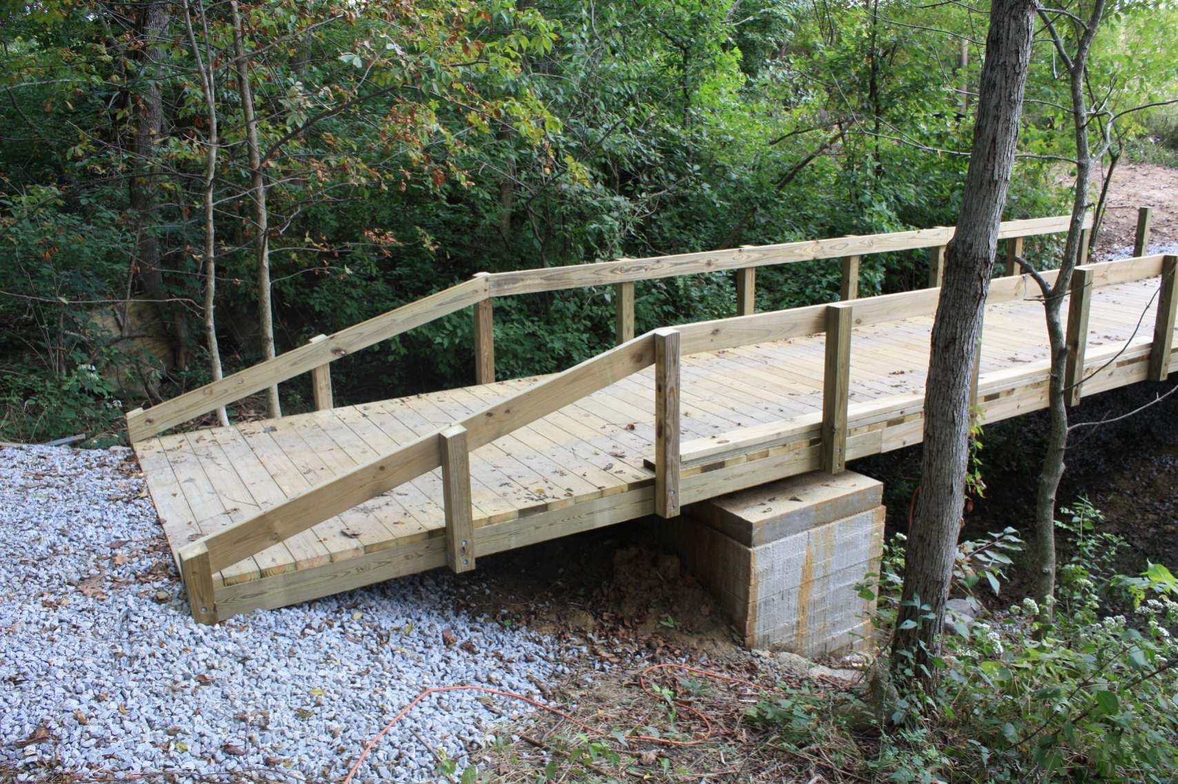

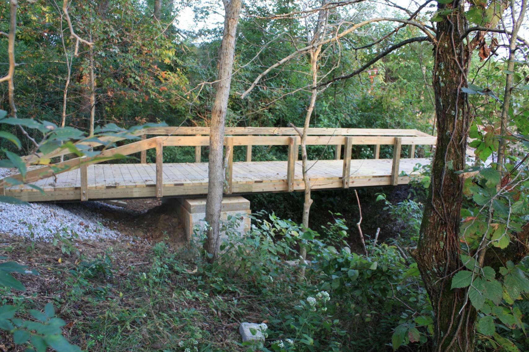

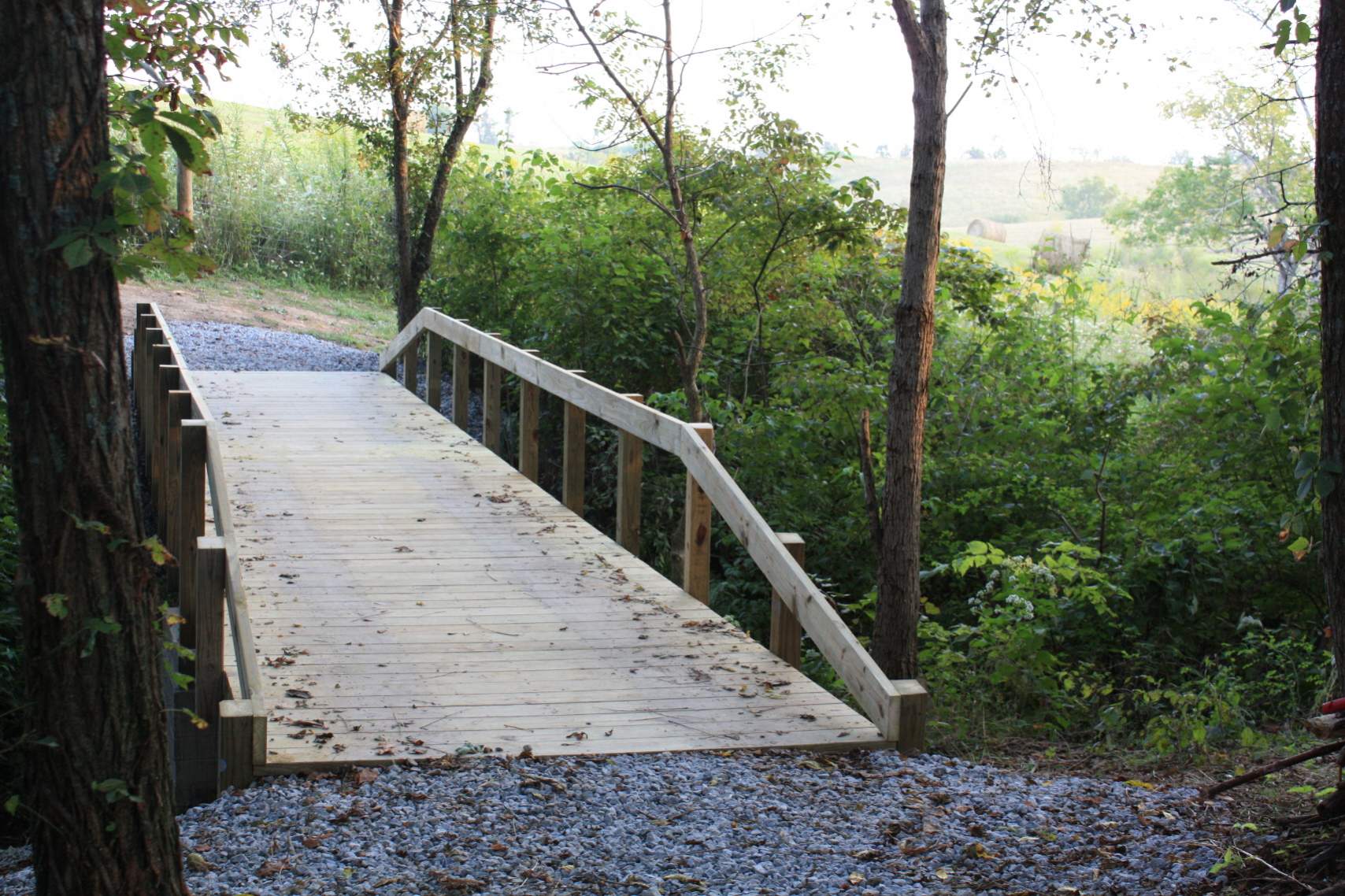

Bridge is done!!! It turned out well, i'm happy with it. I went with 4x4 posts attached to a 4x6, seems pretty strong, and I like the look. I still have some grading to do, and a few other little things, but i'm calling it a wrap.

Looks real nice. I'd be interested to know how much deflection there is when you have a fully loaded machine and trailer on the middle of it. Should be easy enough to measure.
