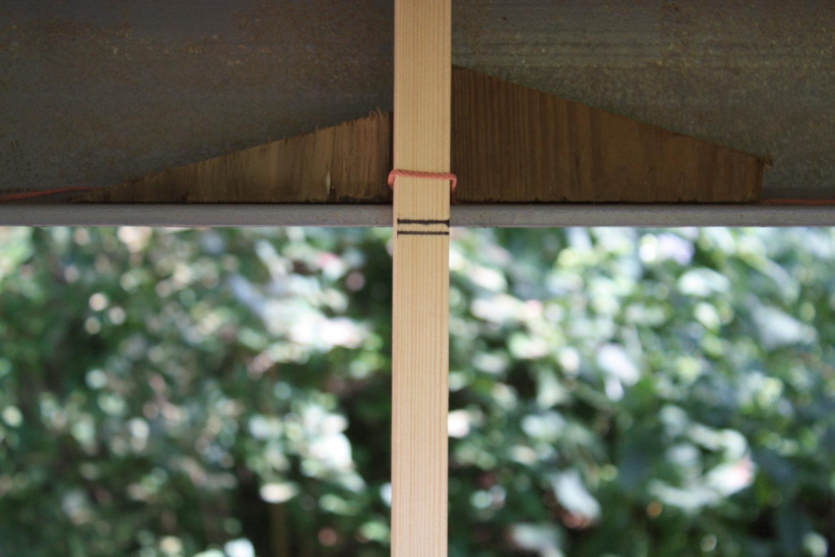

Looks real nice. I'd be interested to know how much deflection there is when you have a fully loaded machine and trailer on the middle of it. Should be easy enough to measure.
I've been wandering the same thing, I may try it later today with the K and the fel loaded, that should give me an idea.

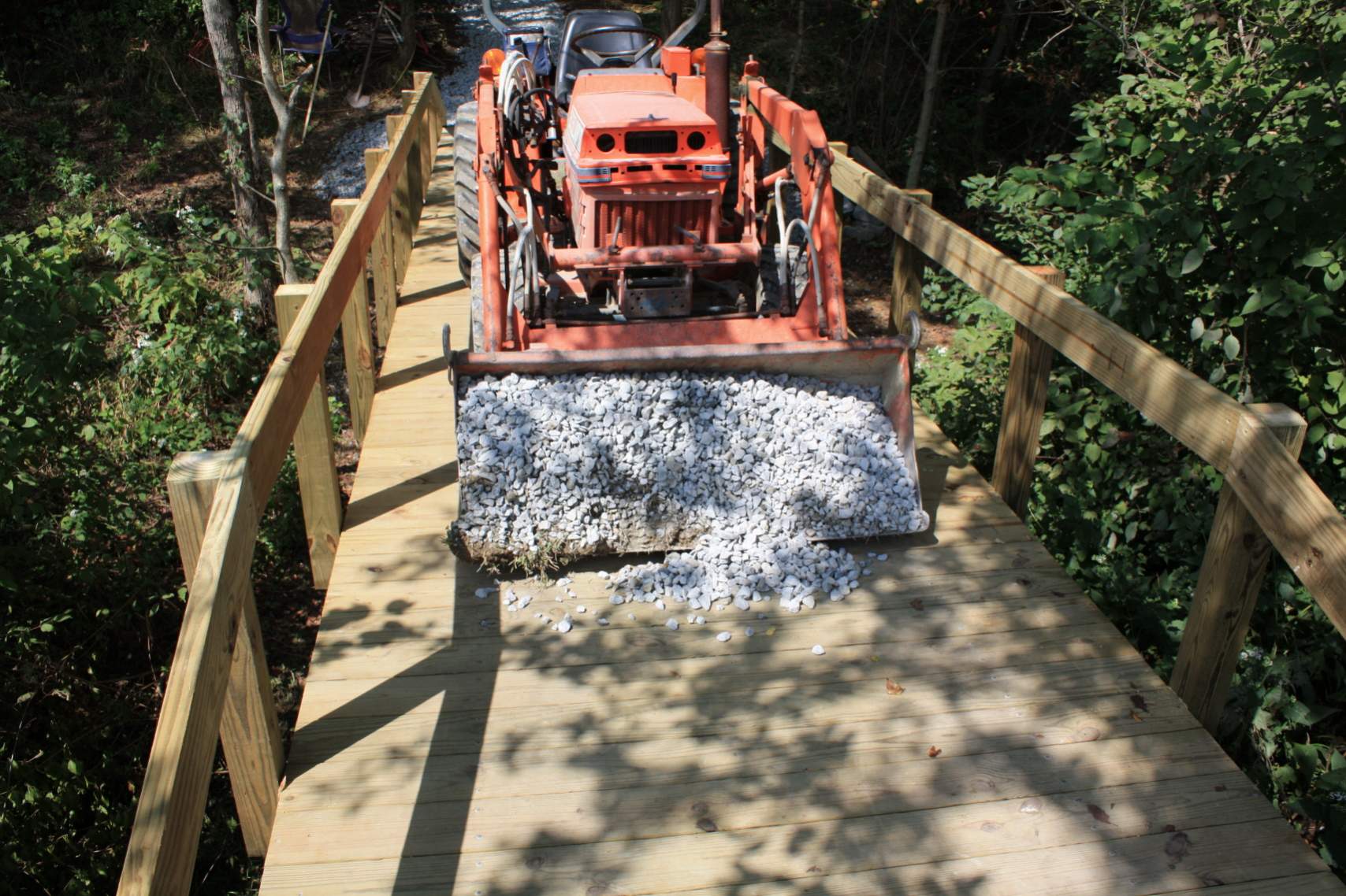

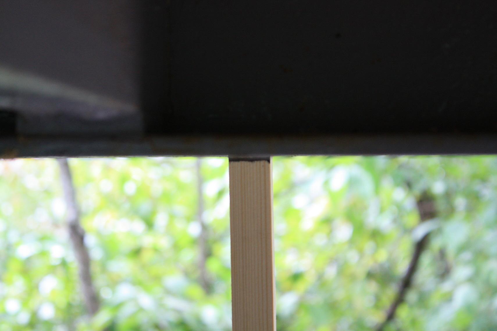

Ok, did the test...the first pic is of the bridge empty, made a mark and didn't move the stick. The second pic is with the bridge loaded (the K with the fel fully loaded and a box blade on the back), made the second mark and turned the stick around. The third pic is of the K loaded in the middle of the largest span. The deflection is 1/8 of an inch. That kinda surprised me, I didn't think there would be any. You can't feel any give when you drive on it, it feels solid as a rock. Thanks for suggesting the test. I'm not sure how much it should deflect, but I feel ok with it.
