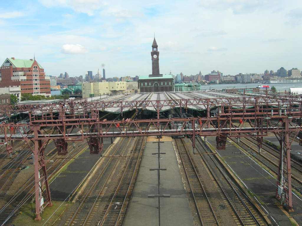

Hoboken Station looking East into NY skyline.
