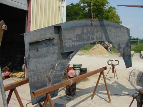

I just got back from yet another day at Harv's. The bridge looks pretty nice once it's all put together. Harv has today's photos, I hadn't charged my batteries for today.
/ Bridge for ATV #62
Bobby showed up today without his camera.
Bad move.
He had to work. /forums/images/graemlins/grin.gif /forums/images/graemlins/grin.gif

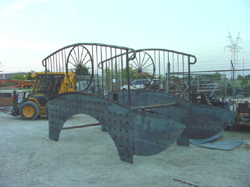

Here's what the bridge looks like assembled in Wylie this evening.

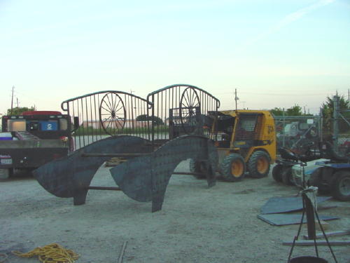

/ Bridge for ATV #66
The front pieces aren't sails. They're not fins either.
They're extensions necessary to reach the sides of the creek. Tomorrow we'll put on the pins for the stones on, disassemble everything, put it in Don's trailer, and after he helps me finish the barn project. He can go home. /forums/images/graemlins/grin.gif
Here's what you'd see if you were a pebble involved in bridging one oh one at Don's creek Texas.

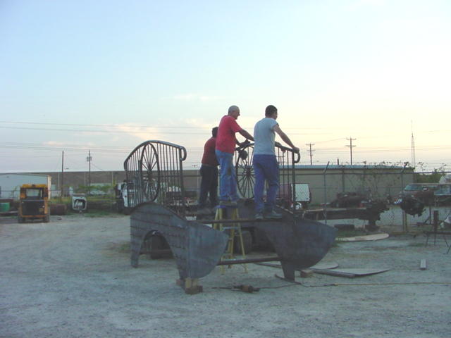

/ Bridge for ATV #67
Just before disassembly for transportation Don took this picture. I posted it down in "meetings and get togethers". But this morning I realized some people haven't registered yet and don't get to see the posts down there.
They don't know what they're missing. There's at least six shots of Jinman talking Australian while wearing his mother in laws off to Macy's hat.

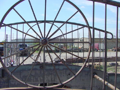

If you looked at that photo and didn't get it. Let me help you.
We made two wheels from scratch. At least eight different individuals were involved, seven of them varying in skill from minimal to curious about steel wheel production.
When complete and installed in the railings of the bridge you can stand back and look at them in just the right angle and see only one set of spokes.
If you're a picky person you'd expect that from professionals. Don's the one that caught this. Maybe he knows something about the wild life at his place the rest of wouldn't expect. /forums/images/graemlins/grin.gif /forums/images/graemlins/grin.gif /forums/images/graemlins/grin.gif
