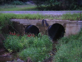

I thought that I would chime in with a slightly different idea. The picture attached is of my driveway creek crossing. There are two 4 foot by 16 foot corrugated steel culverts but it should work just as well with a narrow crossing. The sides are cinder block dry stacked and reinforced with scrap steel (rebar if you don't have the scrap) and then filled with concrete. The corrugated culverts are attached to the sides by drilling holes through the end, attaching a long bolt so that it sticks to the outside of the culvert and pouring concrete around the bolt.
My intentions are to face this with stone at some point in the future to make it a little more aesthetically pleasing.

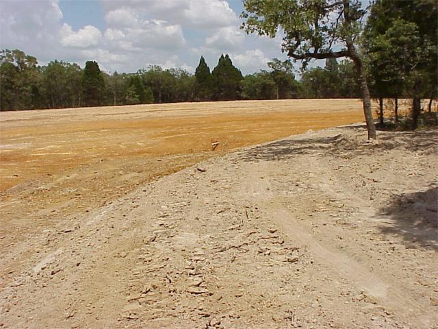

The pond the gully/creek ends in. New, no water three years ago. That white pipe is a 8" drain/trickle overflow pipe.

Wow, how big is that pond? Did you do any of the dirt work?
I wish I could drain ours to remove the silt. I'm guessing ours has 4 feet of silt in it. It is 22 years old. Would be a major league project.
TxDon, you always seem to have some really cool projects going on...Kyle
/ Bridge for ATV
#25
Kyle, the pond looks a lot bigger empty than it does with water. The dam is about 75 yards long. The pond was built before I got my Kubota and the neat dirt work you see was done by an excellent Lee county dozer operator. When you decide to clean out you pond I can recommend two dozer operators in the area that I have used.

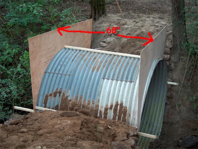

For all the lurkers (that is people who surf in but are not members) who are wondering what is going on with that bridge, the answer is a lot.
In the "OTHER FORUMS" at the bottom of this page there is a bonus forum called "MEETINGS AND GET-TOGETHERS" which only appears after you have logged in. To log in you must be a member - it cost nothing and you get no unwanted e-mails or spams - not a sales pitch just a fact.
In the Norte Tejas (north Texas) project get together thread, the bridge as well as the party is being discussed with great enthusiasm and humor. Today there are 115 post with over 2750 views. On September 25 The small sleepy town of Wylie Texas will will host an event like they have never seen before. TBNers from hundreds of miles around will descend on this small town for the most exciting day of their_____________. (fill in the blank - week, month, year, life)
Harv, has managed to sketch (probably in the shower) and post a preliminary drawing of this most unusual metal bridge. It has curves and rocks and wheels etc... How we will put it all together is still a mystery, but it will be well documented.
Oh! there is also something mentioned about a TV show..... /forums/images/graemlins/shocked.gif
The attachment is just one of the many photos in the forum below showing the preparation of the bridge template.

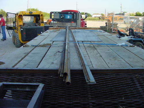

For anyone who doesn't already know it (only visitors or non-members probably who don't see the "Meetings & Get-together" forum), a project get together has been planned for tomorrow, Sept. 25, to work on this project of txdon's. The planning sort of took on a life of its own and is going to be a barbecue/picnic/work project with TBN members and wives or girlfriends. So, a few folks showed up early today to start with some of the setting up and getting ready for the big day tomorrow.
Now I'm not much of a photographer and wasn't really thinking about or planning to post the pictures; however, . . . the attachment is the back of the shop building, wroughtn_harv's truck, with him cutting a piece of pipe with a band saw and bgoodman observing.
