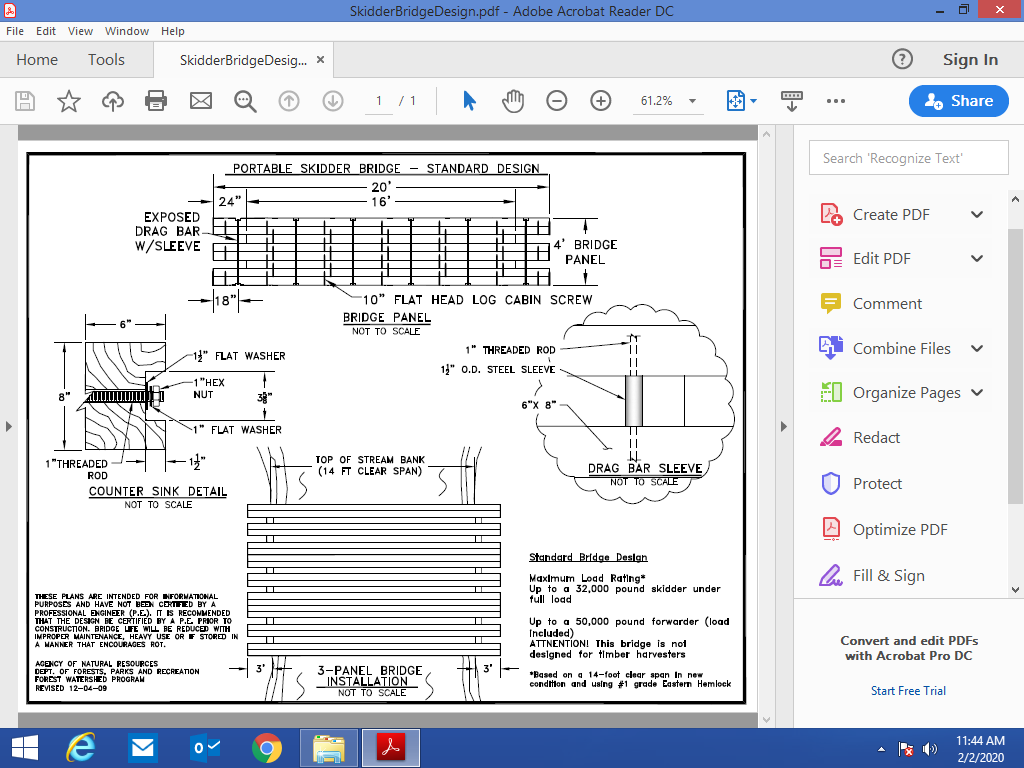

Temporary logging bridge is made from 6*6 side by side and through bolted the full width of the bridge.
I can not find the USFS design PDF. (Or was it a state....)

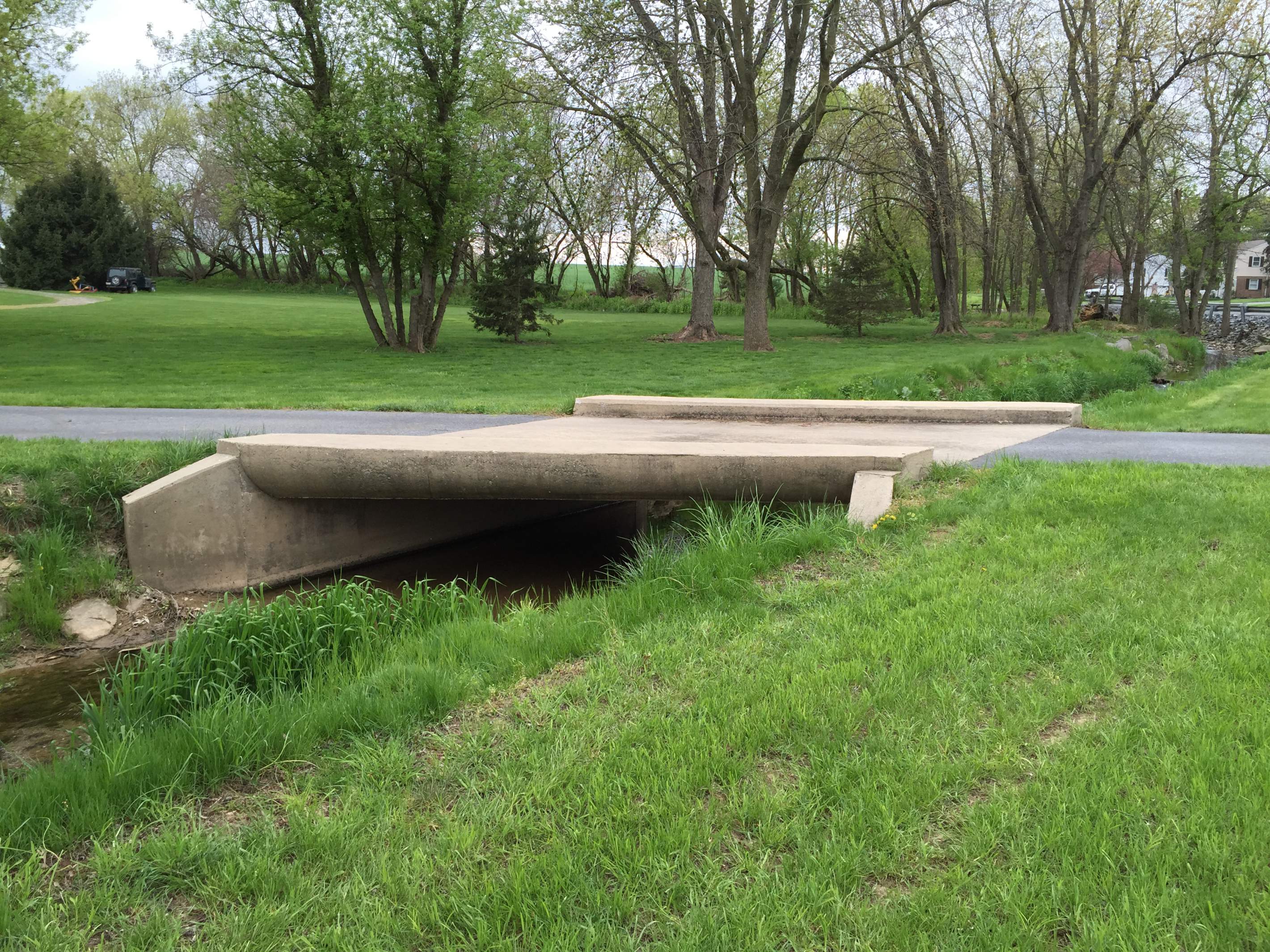

This was almost a DIY, but the contractor building our house gave me a killer price. I had an engineer develop the drawings and specs with trucks in mind (fire truck, triaxle dump trucks, etc.). In 1989 the rebar was around $1,100 IIRC. The bore is 16' and the footers are something like 9' down. All poured reinforced concrete. All sorts of trucks and equipment have used it. 3 or 4 years after we moved in we had a crew pave the driveway, and about 5 years ago we had the blacktop repaired and topped.
As part of the whole site design, the creek had a big elbow that curved around the bridge location that was removed to compensate for the bridge being placed in the flood plain. The nice part is the bridge was built on dry land. We straightened the creek to pass under the bridge after the bridge was completed. The clump tree behind the bridge was on the bank of the creek.
Between 0 and 6 times a year the driveway looks like the second picture for a couple hours max each occurrence. If you look closely you can just make out the edges of the curbs on the bridge. As long as you can see the curbs, the water is only 6-8" deep at the lowest part of the driveway surface and safe to travel.
Side note - I buried concrete-encased conduits beneath the new creek location while it was still dry land. This provides for easier replacement of the municipal water line, cable, phone and power if needed . Digging across a creek is probably a lot more complicated nowadays.

That's a nice bridge.
And with no concerns of it ever giving out. I bet that is a relieving feeling.

Chim, great looking bridge. Very professional!!!! I'm still uncertain about the internal structure? It's just rebar, no internal steel beams?

Thanks. Once a year I clean it up. $1,100 bought a lot of rebar in '89:) I think the builder gave me a number of around $3K without excavation at the time. That's only $2K more than the rebar for all the concrete and labor. With the workload I had, his price was quickly accepted.
There are #6 bars on 6-1/2" centers running in the direction of travel and #5 on 12" centers crossing them. The #5 bars running across turn up into the curved curbs and the curbs have #6 bars running lengthwise. My guess is the 12" thick sides at the curbs act as cast concrete beams.

Here is one I have saved - Heavy duty though 16' span and holds a skidder plus the hitch. Build it in 4' wide panels or sections.
