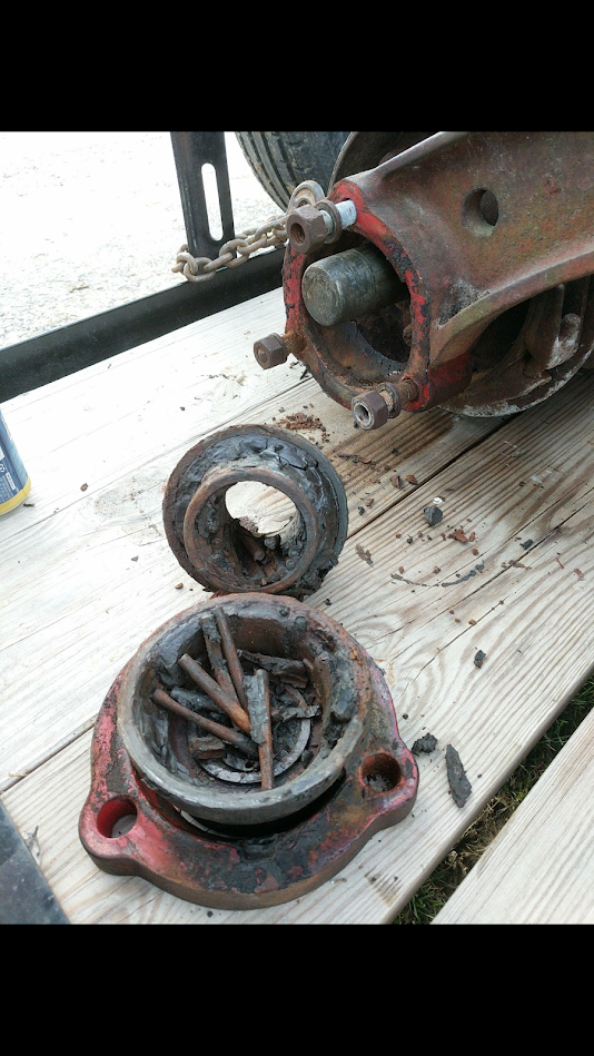

Needle roller and cages start on page 56 http://www.skf.com/binary/30-241905/06003_2-EN-Needle-roller-bearings_Lowres.pdf You need the inner and outer diameters plus width to get an SKF designation number, plug that number into google/ebay and see who will sell it cheapest. For that application, I wouldn't feel bad swapping in a drawn cup needle roller (page 75)
Needle Roller Bearings - Bearing Depot & Supply
This is a terrific find. Brillion is not going to make cage bearings so somewhere on the net must be a reference to a number or size needed. Likely your bearing cups are worn too much to get an accurate measurement. I would guess that the bearing Brillion uses was a common part of the 1950's-1960's and is one of the most common around. That's what I have found with their parts.
Maybe you could figure out the bearing size after you get yours apart. You could measure the bearing holders and if you could find a good bearing measure that, guestimate tolerance and then try to confirm on the net from someone who had done it before. My experience with Brillion bearings is they fail from a lack of grease and the bearings stop rolling so that one side is destroyed while the other side looks pretty good.

Whelp I called the local brillion/landoll rep and he told me to go to the local John Deere dealership. I gave them the original part number and they went back to the computer and said they could get them. I asked how much and they said $6.50 per bearing. I was kind of taken back! I ordered four of them and they should be in by Tuesday. I guess we'll see then if they are the right ones.

I heard the guy wrong. Not $6.50.... $86.50!!! ha.... So I got one instead of four.
So my problem now is I can get the felt washer for one side but not the bigger one for the other side. Looking for part number 2C981 - Felt Washer 3-3/16 in. O.D.
Any idea where to find one or a some sort of workaround?
   / Brillion Hub and Bearings #28
Just google "brillion 2C981" and you'll find a couple sources.

Found another source for the felt washer. Now I just need to find time to put it back together.

What did the existing bearings look like?
I've only taken one apart so far as it was the only one that was easily identifiable as having a bad bearing.
Here's what it looked like when I opened it up.
   / Brillion Hub and Bearings #34
When they're bad, it's easy to see because they fall out in your hand like that.
