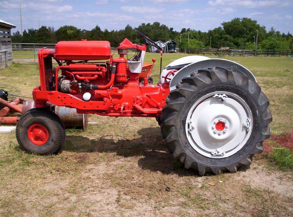

   / Bringing a 640 Back To Life (was Newcomer) #19
I'm not sure what 'breather' you are seeing on the BLOCK that is wingnutted on.. there is a Valve cover breather.. and the crankcase breather.. not much else...
Take a look at these 2 pics I've posted.
On the right side pic.. I circled the 2 breathers in yellow.. the one at the top is #1.. it is the valve cover breather..... and is atop the HEAD.. ie OHV.. etc.
the lower one is #2, and is the breather cover for the 4" tube that goes into the engine block.
The left side pic.. well.. guess what.. no breathers.. you have a gennny/alternator ( mine is an alternator ) intake/exhaust manifold, and a farb and air cleaner.. nothing else on the block on that side except welch plugs. This happens to be a 172ci engine.. but is identical to the 134ci engines.. except in internal mods for the extra 18 or so hp.. etc.
soundguy
#20
That clears it up... it was the valve cover breather I thought was the
only one. My cleaning rags were covering the lower one as haven't cleaned
that low yet. :D sorry!
