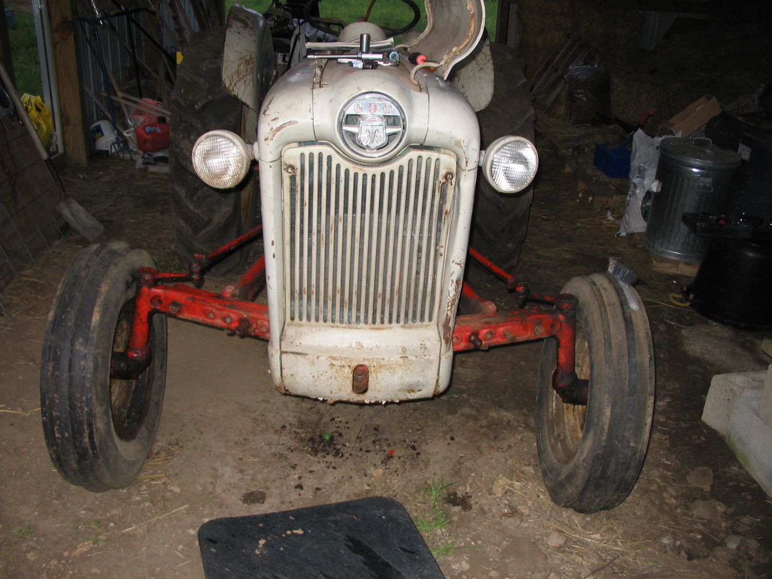

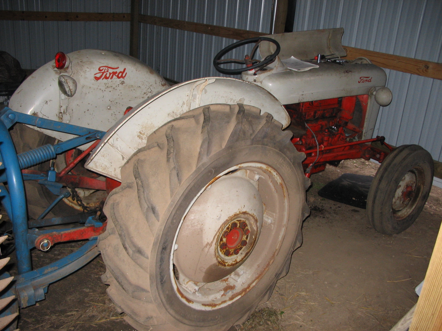

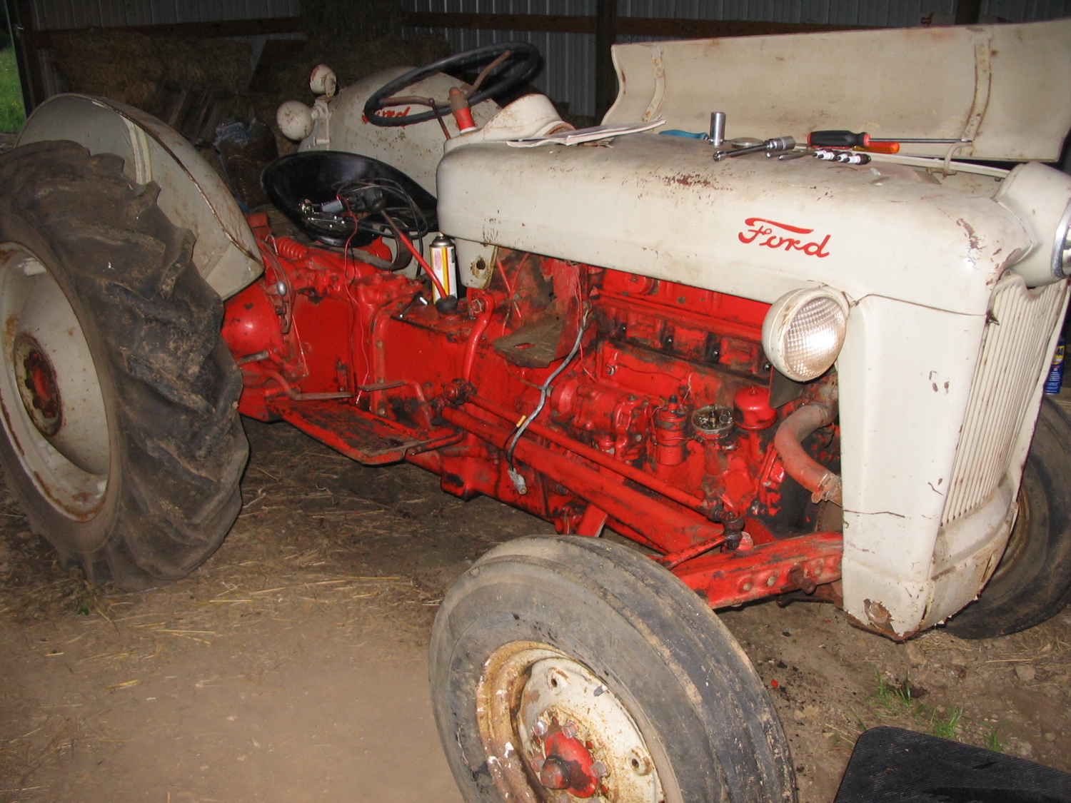

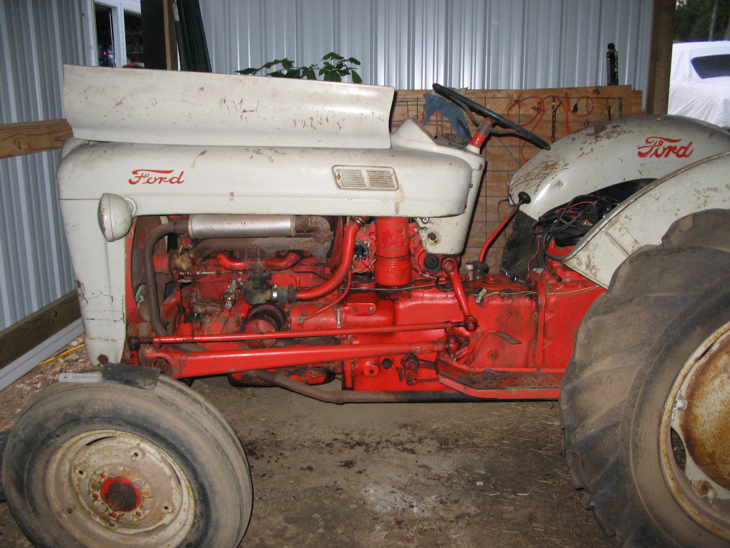

Thanks...
Hey, here are some pics...
   / Bringing a 640 Back To Life (was Newcomer) #40
looks sweet to me.
soundguy
