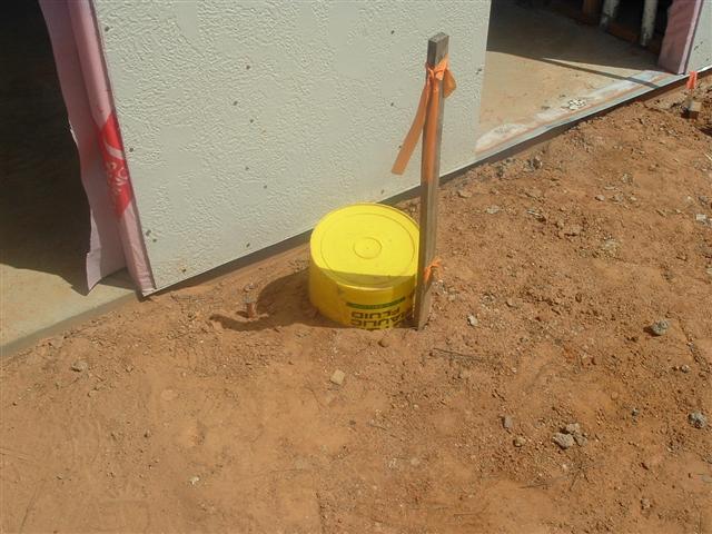

Back at the workshop, I stubed in two 2 inch conduits for this very day. I like to use five gallon buckets to mark my buried lines. They are easy to find and when you take them out, there's a good size hole already in the ground.

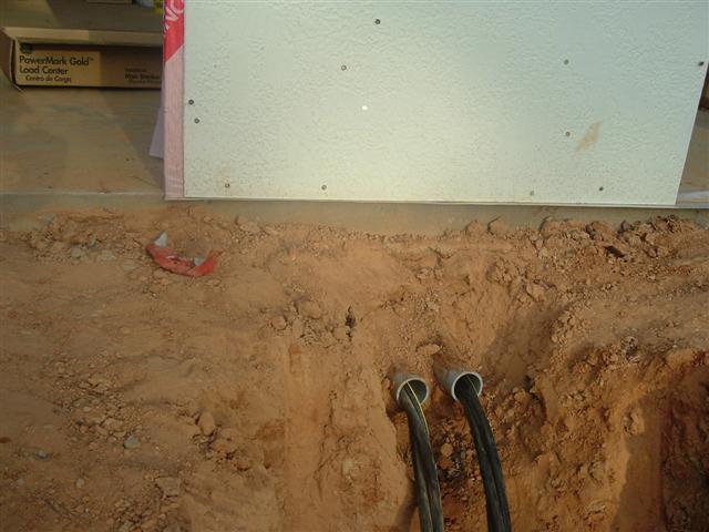

Once the bucket is out of the way and the trench dug, it's a simple matter of putting the wire through the conduit.

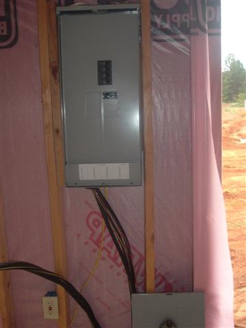

I connected the first panal and ran an outlet off of it for power. The only 20 amp outlet I had was a GFI, so that's what I used.
I figure that one outlet has cost me about $5,000. Of course, the second one I install with knock that price per outlet in half to only $2,500 each. /forums/images/graemlins/grin.gif /forums/images/graemlins/grin.gif /forums/images/graemlins/grin.gif
This should be the end of this post. I now have power to my workshop and on the land.
Thanks for your comments and advice. They have been greatly appreciated. /forums/images/graemlins/smile.gif

Ummm.......Eddie, you aren't going to put conduit on that wire going to the panel? /forums/images/graemlins/confused.gif
   / Bringing Power In
#100
Inspector,
I'm putting up OSB on the inside walls that will enclose the wall cavity. My understanding is that this is allowed for a 200 amp main feed.
I've never seen conduit used in homes with sheetrock enclosing the cavity, so I assumed it would be alright.
Am I wrong?
For my overhead line going to my sub-panal, I'm using 2 inch conduit, but that's because it will be exposed in my rafters.
Thanks,
Eddie
