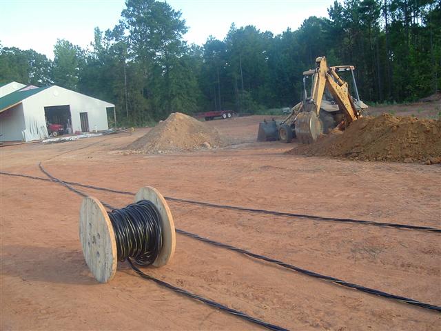

I dug my trench about half way, then unrolled my wire. It's 4/0 URD for direct burial. My trench is 8 feet deep at the panal and slowly works it's way to six feet and will end at four feet.
The reason I'm so deep is that in the future water and sewer lines will cross over these wires, and I don't want to risk digging them up again.

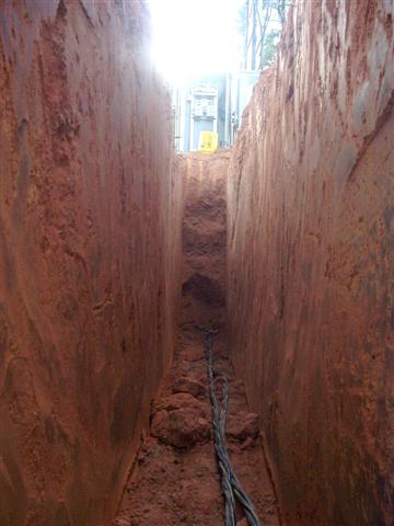

Here's the view from the bottom of the trench. I got lucky and was able to push the wire up through the 2 inch conduit into the disconnect box. It was one of those jobs that you measure in inches with lots of breaks!!!

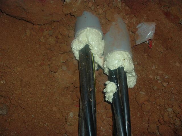

Way back when, I used to seal off the pipes with plumbers putty. Not the best method that I've come across.
I like expanding foam!!!!

No criticism intended, but seeing that picture from the bottom of the trench without shoring makes me cringe. I'm not sure what type of soil you have there but anything deeper than waist deep is a potential hazzard without shoring.
That being said, it is a neat picture!
Bonehead
   / Bringing Power In #86
It's a fine line about being "preachy" but I agree about trenches. They look fine but if the dirt dries out, the weight of the damp stuff behinds it causes hundreds of pounds, even thoussands to fall off with the slightest provocation. I've read a dozen or so death reports on guys dying in trenches. Even with dozens of men trying to get them out immediately, the victims suffocate. No one can tell when or why they go and believe it, every single person that has ever been buried thinks the dirt is just fine. Our pool was dug out back. The darned stuff looked like concrete! During the middle of the night, we heard this deep "WHOMP". I went out back to investigate only to find out that a large section of the dig had caved in. Scared me to death!
About that direct burial. I apologize if you know already: Put it on sand and bury it with sand, then pea gravel, then waste ROLLS of red vinyl tape on top of that. Anytime a dig is in progress in the future, you'll pull that red tape up as a warning and it'll save the cable. The sand will keep sharp rocks from working their way through the insulation over time. No one can tell me it can't happen, I've seen it twice, once on cable, once on a pipe. That cable will have a subtle, seemingly harmless 60 cycle buzz to it, perfect for rubbing a hole. (same reason cables work out of their lugs)

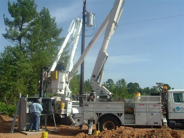

Thanks for the concern about the trenches. It's one of those things that I'm aware of, know it's a bad idea, and do anyway. The worse part is it was 8pm with nobody around and not expecting anybody until the following morning. /forums/images/graemlins/confused.gif
I'm not saying I'm the sharpest tool in the shed, but sometimes doing dumb things is the quick solution, and I take the risk. Hopefully I won't find myself on my knees feeding cable up through conduit 8 ft down again.

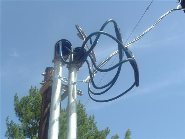

On a brighter note, TXU was here bright and early connecting my wires. They had to struggle with the size of it, but after a few hours, they got it done.
I never expected two boom trucks and a supervisor in a third truck, but I appreciate the service.

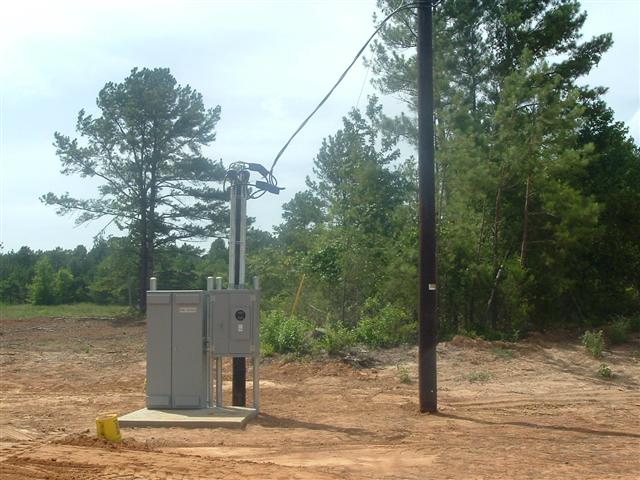

This is the finished product. I angled the shot to maximize the wire and connections. From most angles and a little distance, it all disapears in the background.
The meter is scheduled to be installed today. You have no idea how tired of listening to my generator I am. /forums/images/graemlins/frown.gif

Here's a closer view of the connections. Not much to do about it.

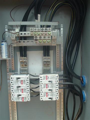

Here's the inside of the disconnect box. The top two, right side breakers are the ones I've connected to power the workshop.
The rest will remain empty for now.
It's kind of expensive up front paying for all this when I only needed 200 amps, but down the road I'll see the benifits of doing it now.
