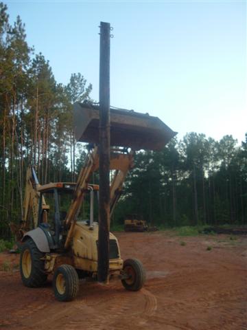

#72
After wasting a bunch of time and money on bringing the wires into the box underground, common sence and a small wallet prevailed. The original plan was arial and the price differnce is 4 times more to go underground.
You've all see plenty of picx of holes being drilled, and even more pics of the hole in the ground, but how many have see a 17 foot pole being carried to the hole?
Eddie

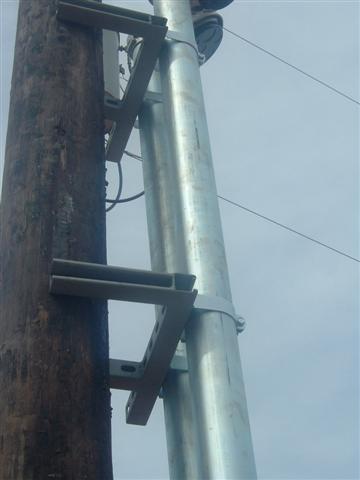

#74
My electrician drew up some ideas on making the suports from the pole. He said I need two of them, and they needed to be strong. He drew some plans, but they seemed to have an aweful lot of steel.
I bought some angle iron for this job, but when I got started on it, and measured my requirements, I realized I could just build an "F" type bracket.
I built two and anchored them into the pole with half inch by 4 inch galvanized lag bolts. To make it easier to install, I used my impact wrench.
Eddie

It's Unistrut, or as my tag lists it, 1 5/8 X 1 5/8 Slotted 12G. Comes in ten foot sticks for $18.03

Eddie; That UniStrut is some good stuff. I grab every piece of that I can. The cutoffs are just scrap where I am! /forums/images/graemlins/grin.gif
