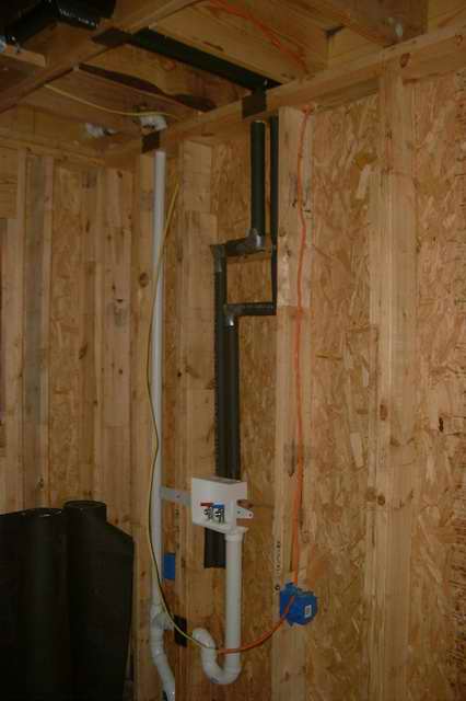

I do think anyone who drills or nails around an electrical fuse box better be ready for some surprises no matter what kind of conduit. When my house was built, the plumbers put protective strips over pipes (see attachment), but none of the electrical wire runs were protected this way. I guess you could do that if you wanted to be sure no nails ever got into your wire runs. My main feed into my box came up the outside of my house and feeds through the wall and into the breaker box. The outside feed is inside conduit, of course.
