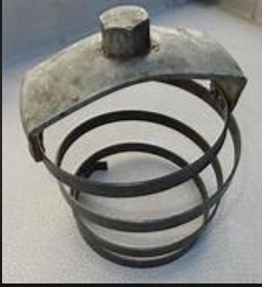

Here is what you need; I have been there. This wrench will put pressure on the entire filter. After it tightens it will not slip because it grips the entire filter. Since it a coil you can take your had and compress the tool to get it on the filter.
I have never crushed a filter with this tool. In fact I used this tool to take a filter off that started to shred apart.
   / Broke 2 Oil filter wrenches #49
I may have to make myself one of those. That's ingenious!

I wish I could say I discovered this and fabricated it. I did not. Midway through an oil change on a 1964 Ford Truck I ran into problems. I went to a local auto parts store (not a retail chain but a warehouse type store). I explained my problem and one of the "old timers" suggested the coil wrench.
Below is a hyperlink to a supplier. I have never used this supplier but I did find the link why searching for a picture of the coil wrench.
