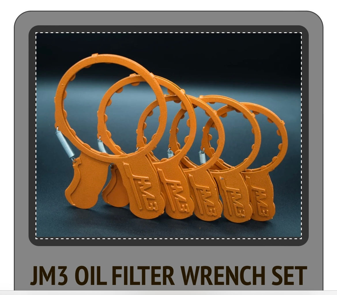

Trying to get the Hydro oil filter off.
I am hoping to avoid pounding a hole through the thing because it'll be messy.
I've crushed the can with one tool A band wrench just slips. A chain wrench slips. Can't get my big pipe wrench on it; no room to maneuver.
Cut the paint. Use these. Be careful.

Here is what you need; I have been there. This wrench will put pressure on the entire filter. After it tightens it will not slip because it grips the entire filter. Since it a coil you can take your had and compress the tool to get it on the filter.
I have never crushed a filter with this tool. In fact I used this tool to take a filter off that started to shred apart.
I may have to make myself one of those. That's ingenious!
