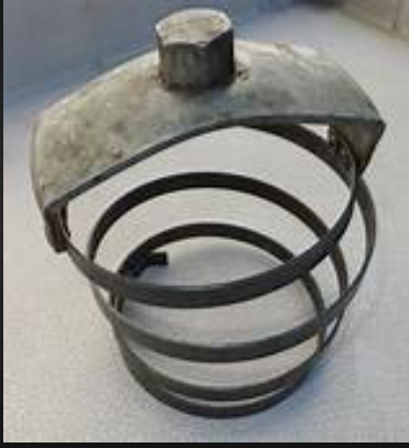

I just now went looking for the coil filter wrench shown above. The Images part of google search was the only way to distinguish that tool from other unrelated Google hits. There are some Ebay matches but Unitool seems to be the only source for a new one.
New Britain M-150 was an old stock #, now NLA.
I think I'm going to try one of those myself. Now to find a good one.
The Kubota hydraulic suction and charge filters are a particular challenge because there is only access to about the bottom third of the filter cannister to grab onto with something like a band or chain style. Those always end up just crushing or collapsing the filter. But there is room alongside the filter to slide something up.
Interestingly I find the same lack of space in Kubota's wiring plugs. Same designer? And there is one manifold/muffler mounting bolt that I still have not figured out how to get a wrench or socket on.
The search is on.

Below is a hyperlink to a supplier. I have never used this supplier but I did find the link why searching for a picture of the coil wrench.
BTW: Don't let the neighbors borrow it, you may never see it again...LOL
I had a thought...why don't I measure my Kubota oil filters before ordering the UNITOOL Coil Spring Type Filter Wrench?
So I did. Uh-oh....The coil spring says it is for 3" size filters. All of the Kubota filters are over that. Suction, HST, and engine oil all ranging from 3.6 to 3.725 inches.

Those unitool wrenches suck . I bought one twenty some od years ago and never realy had success removing any filters with them. First the don't bite into the filter so unless the filter is big enough to take up the slack on the first few windings you have to hold the wrench and then turn it to take up the slack .Thats if there is enough room to get both hands in and be able to turn a wrench.
They only work on like 1 diameter filter, the rest were always too small or too large. When I get a new piece of equipment that has a odd ball size on it I usually just by the right cap type wrench . Over the years I have acquired. 20 - 30 different types of filter wrenches.

Here is what you need; I have been there. This wrench will put pressure on the entire filter. After it tightens it will not slip because it grips the entire filter. Since it a coil you can take your had and compress the tool to get it on the filter.
I have never crushed a filter with this tool. In fact I used this tool to take a filter off that started to shred apart.
Do you have a name or source for that? Looks super cool if nothing else.
rScotty
But it's a coil spring, why cant you just unwind it a bit for a larger size? Works in my head anyway.

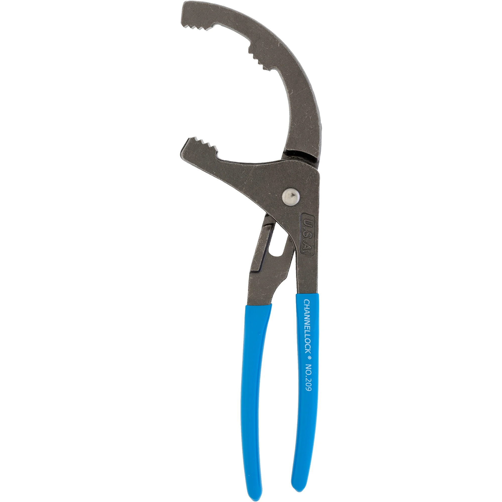

Trying to get the Hydro oil filter off.
I am hoping to avoid pounding a hole through the thing because it'll be messy.
I've crushed the can with one tool A band wrench just slips. A chain wrench slips. Can't get my big pipe wrench on it; no room to maneuver.
I used a slip jaw filter wrench and it was a bear to get off. No need to be on that tight.
