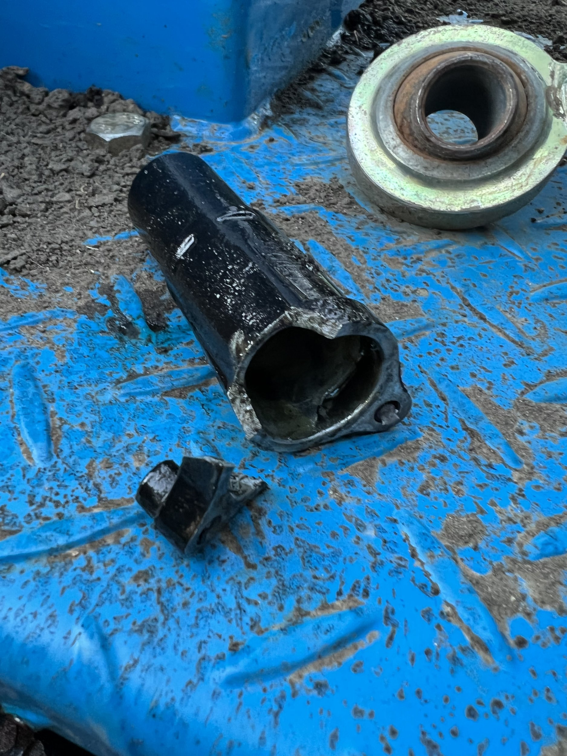

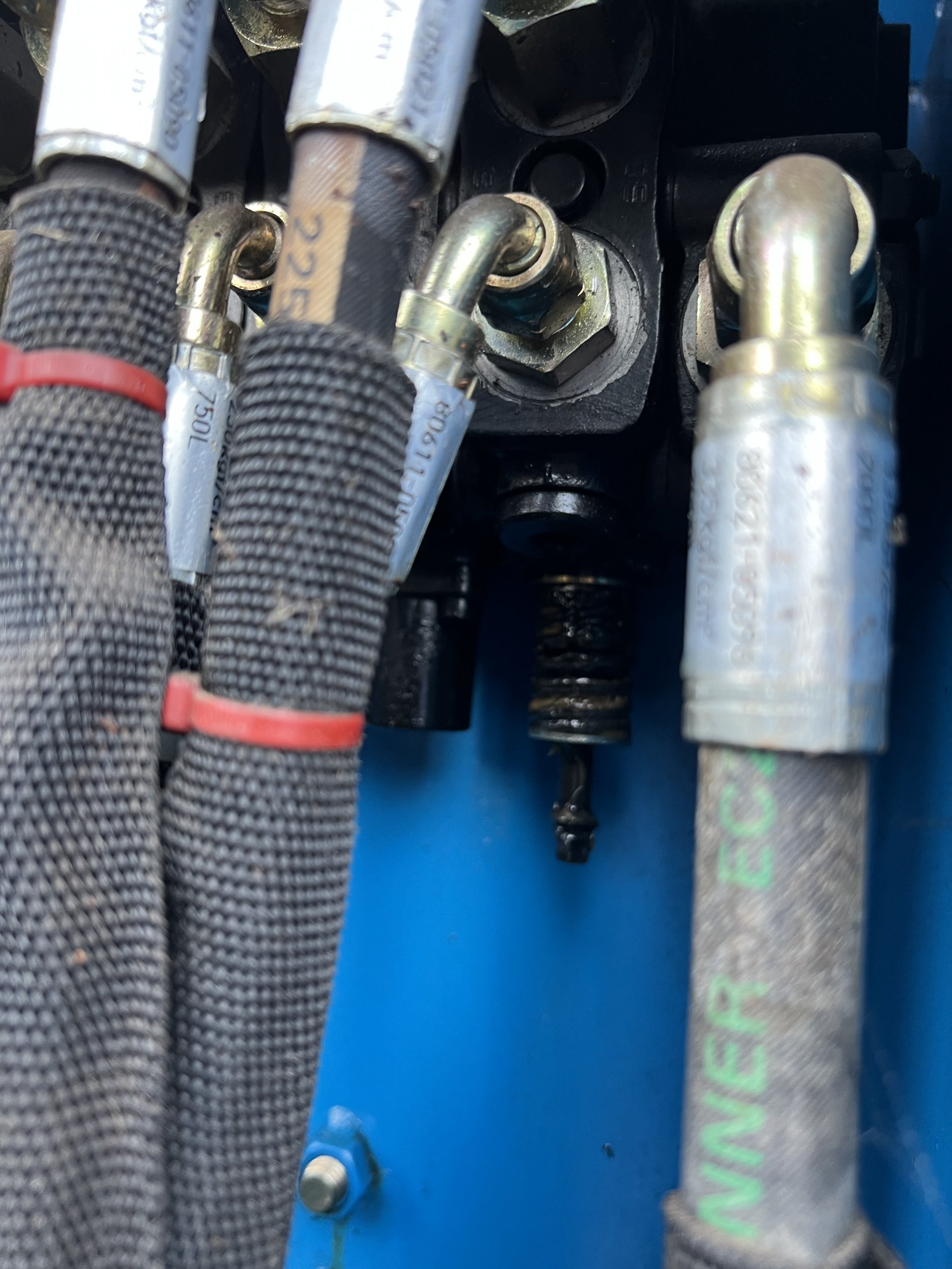

It appears that the backhoe valve detent cap busted on my XJ2025H. I've worked on a lot of cars but never any tractors. Is this part available? One issue is that it's a long way to the nearest dealer. I saw on Youtube that someone had the exact same problem but he fixed it with JB Weld and apparently called it a day. I'm not going to JB Weld this.

The BH valve/hydraulic parts for these are hard to come by. There are a handful of people on here, myself included, who have rod end issues at the controls on the top side of the valve bank due to water getting into the boots and ruining the rod ends. Do you know how it broke? If it is truly just a cap to keep stuff out, and doesn't serve any other purpose, you may be able to get away with JB weld until you find a replacement. It looks like something hit it to break it like that.

It's the detent cap for the left hand stick. Without it on there, it just flops around and no hydraulic pressure.

One option, probably the most aggressive, is to take the valve out and bring it with you to a hydraulic supply store/shop. There they can match it with something and get you back up and running. Probably the most expensive route, but will likely minimize the amount of down time you have.
Another option is to keep googling. Sorry, I dont have a part number or schematic for you. Try calling another dealer. There are several dealers that you can call and order parts from, who will then ship them to you. Describe what you have and see if they can order it.
Lastly, is what you stated you dont want to do: JB weld. Clean it up really well, JB weld it back, and get back to work. Least expensive option and it will work, but I would still look at replacing it. JB weld buys you time, could be a few weeks, could be a few years.

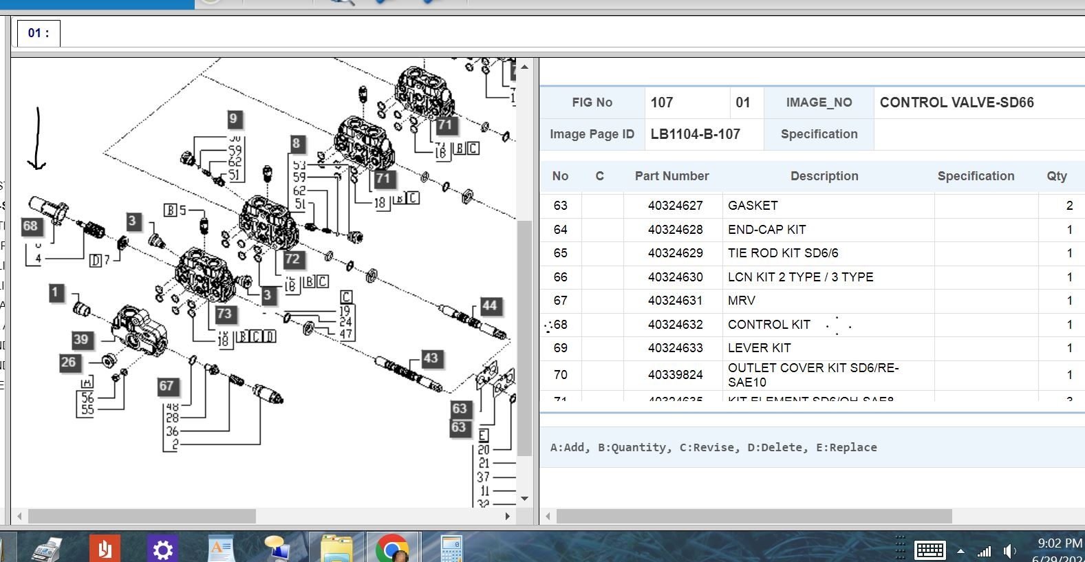

I don't know what I'm looking at.
I was able to determine that the valve body on mine was made by Wavoil and once I found their part number, a distributor was able to find a way to get the parts.
If you can find an owner's or service manual for your BH, the manufacturer and their part numbers (not the LS part numbers) may be there.

I went and called the original dealer who sold the tractor. Ag Bag Forage Solutions in Astoria, OR. They were able to get me the parts (in stock) and shipped within an hour. Should have just called them instead of my worthless local dealer. With shipping and tax, less than $60. Apparently it's an O ring inside the cap that blows out and results in a pressurization and immediate failure of the cap. The parts guy said this happens often enough that they had 6 in stock.
XANE228061 KENP Ring
XCAP210725 KENP Cap, Walvoil SD5

Look at the close details of the parts diagrams and the valve itself. I can't say exactly where.
LS does not make any of these parts. They don't even make the backhoes at all. They are conglomerations of off the shelf parts sourced and assembled by a third party.
In my case, I found that the valve itself was made by Walvoil and I found a distributor in Indiana. They were able to identify the part itself and couild provide them as individual items rather than the full kit the LS dealers have.
