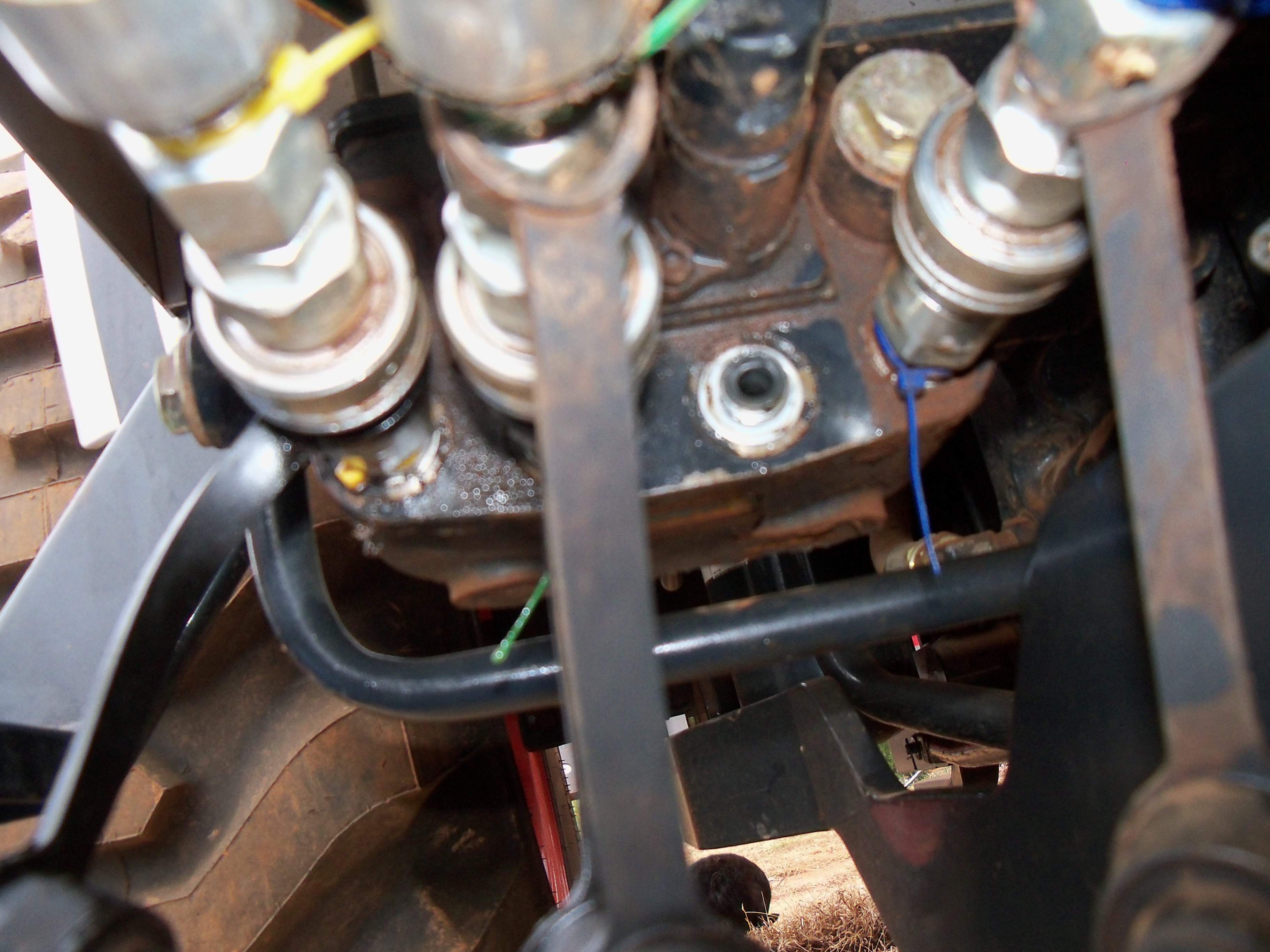

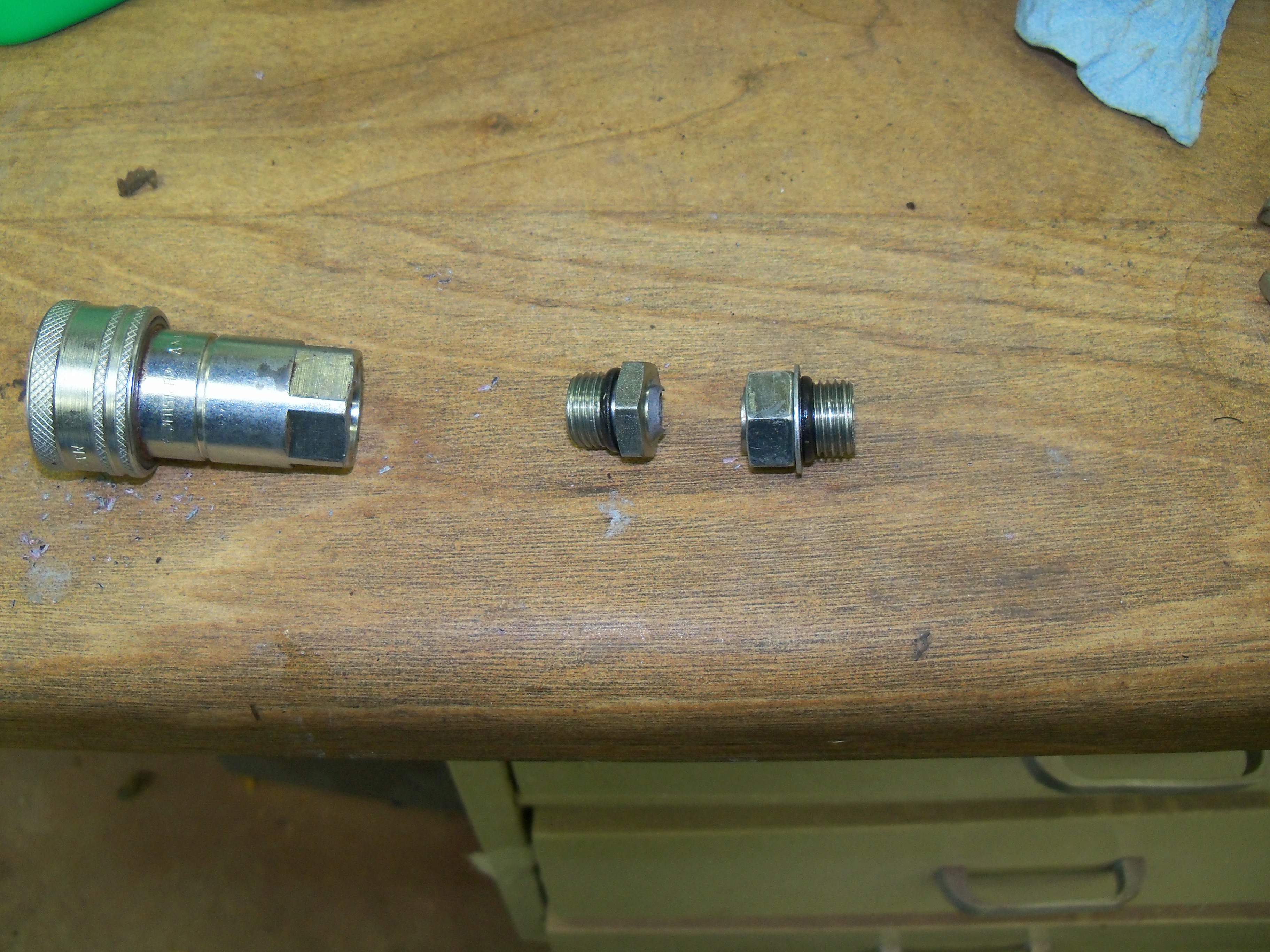

That's what I was thinking, I called a local company that deals in Hydraulic hoses and fittings, and they told me to bring the fitting and QD with me, the fittings cost around $3.00, I really am thankful for all the great help I have gotten here with my problem, great bunch of tractor guys here. 100_1162.jpg100_1165.jpg100_1166.jpg
   / Broken quick connect fitting on CT335 FEL #12
The Faster QD part number from Bobcat is 7190240, adapter is 6693538, and has O-ring #79K6. You are lucky in one respect, the Faster QD is about 1/3 price of the Parker.
I'm not sure but I think the QD has the male thread built into. I only had 1 off and that was over 2 years ago.

Got it back up and running today, grand total.... $5.43. Thanks again for all of your help, Steve

I need a quick understanding of how the coupler attaches ...mine broke off but I can not see what needs to unscrew from control box...horrible access..under seat tight fit.
