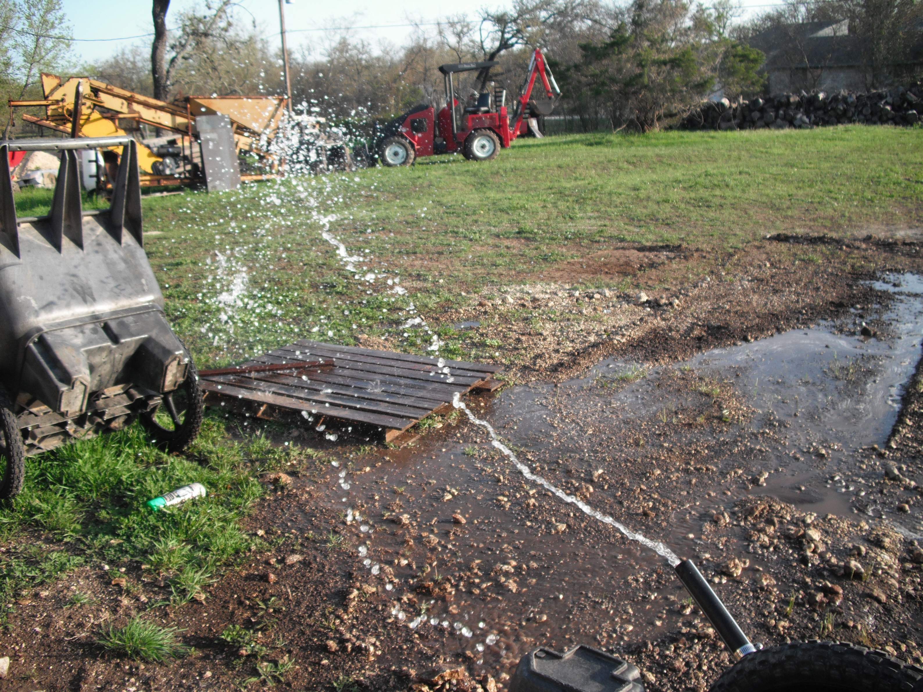

The pump pumps water in fits & starts, but it does pump. This is what I want. Also, there is nothing down the hole except pipe. No pump to fail or get stuck. Can't tell you how many pumps I've pulled due to various failures.
Since I've not tried the Brumby I can't say which one is best.
My tests have been with an open ended pipe. I have to connect to the tank to see how that preforms. Then I can say if I'm satisfied with the pump.

When I get time, I'll try to post a short video with the pump working. Right now I've got the pump routed to two 1500 gal tanks I use for the guest house. The pump put about 2 1/2 feet of water in the tank over a 9-10 hr period. Over all, I'm satisfied it will do as I wish. And if I have a problem, all I have down the hole is two pieces of plastic pipe. I can run to Home Depot & buy another oilless air compressor for about $300 or less than it would cost for a new deep well pump & service rig to pull & set.

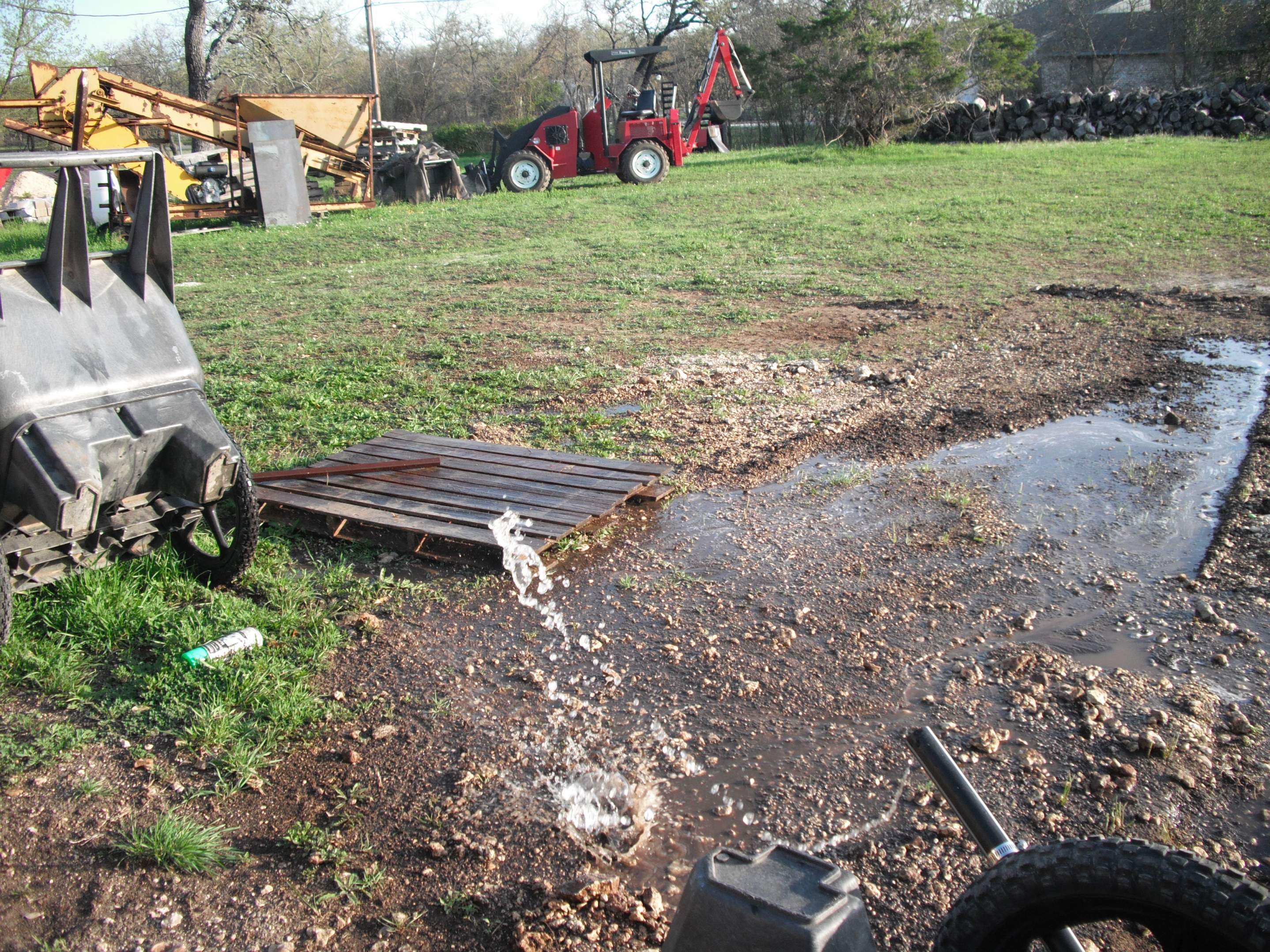

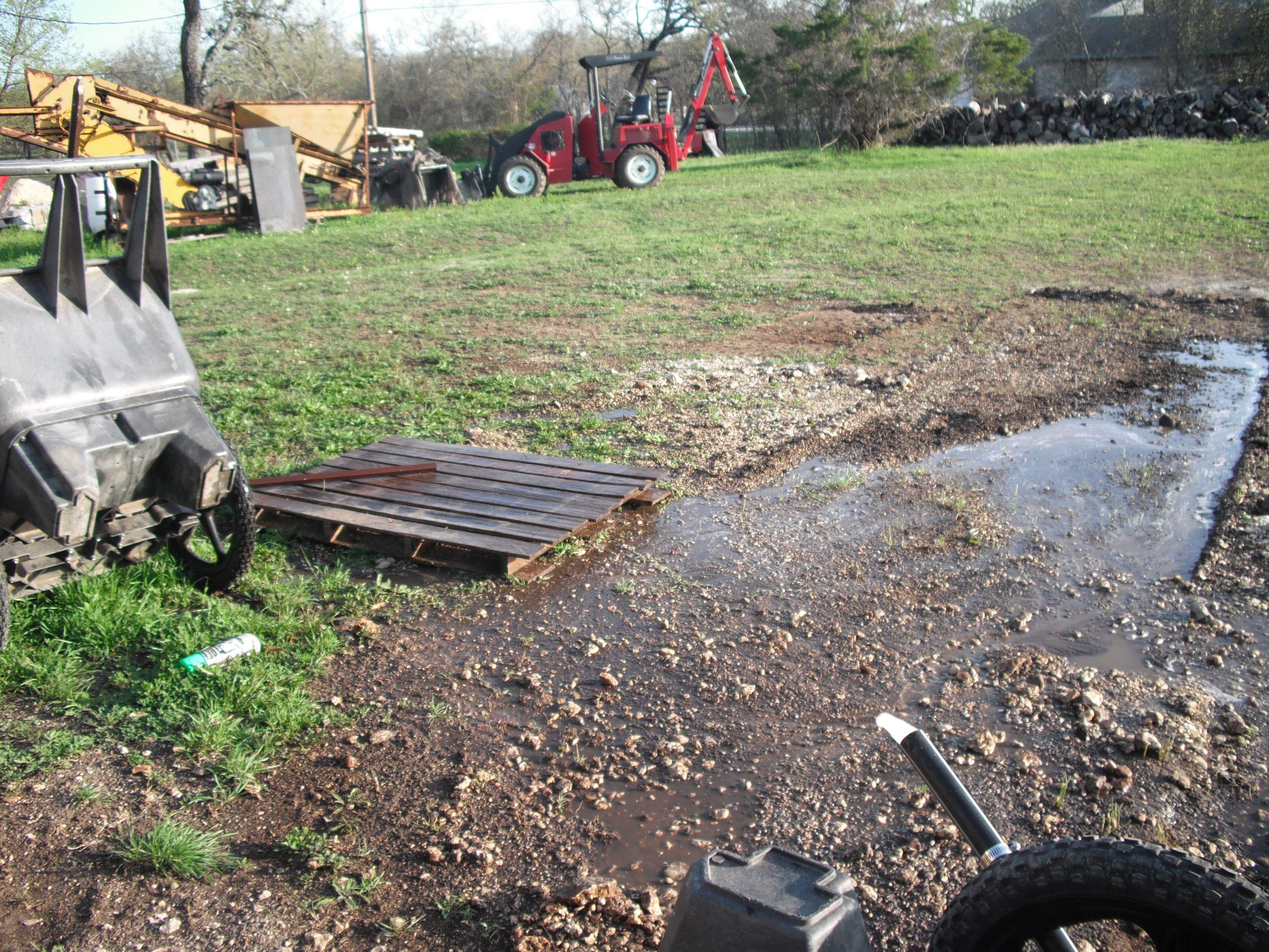

Here are a few pics of the pump in action. (cannot download movie)
400' down
about 270' to water level
compressor set to 50 psi
1" discharge pipe.
3/8" > 1/2" . 1/4" air supply line
The pump is about 14" long and about 1 1/2" in dia, made of SUS
You can see the water comes up with the air bubbles. The discharge is not constant but follows the air bubbles.
Rgds,
tim
