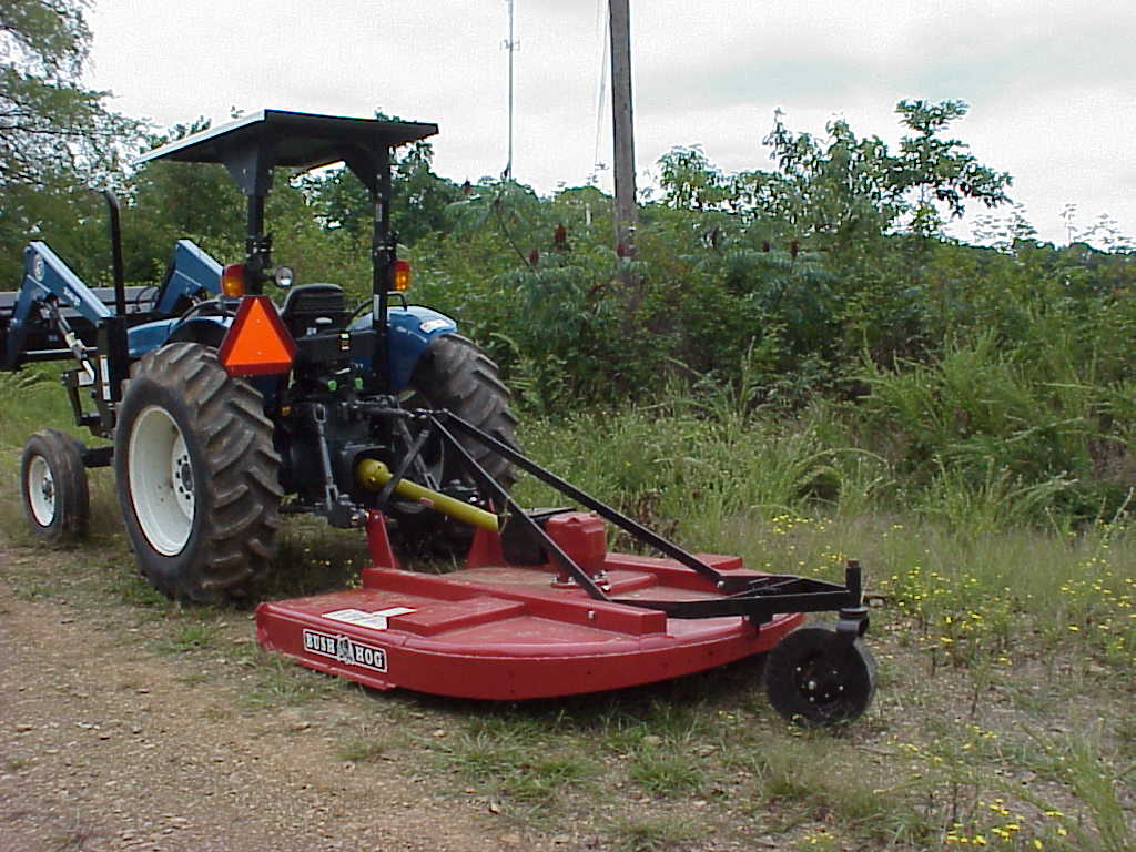

/ Brush hog- How large?
#14
Guys,
Thanks for all the help.
Here is a shot of the new toy.
Works great. I set the rear wheel to it highest setting. This cuts the grass but leaves all those nasty rocks untouched. Now that I have found them all Ill have to pick them up/w3tcompact/icons/frown.gif.
Fred

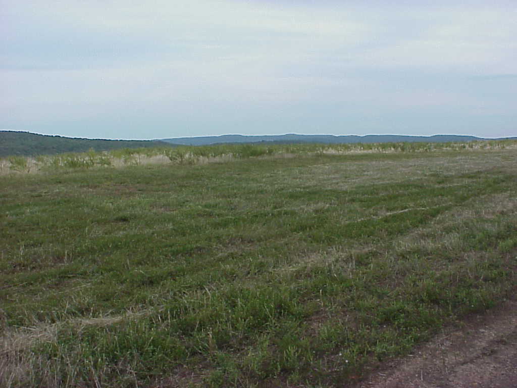

#15
Here is a shot of the results.
Fred
