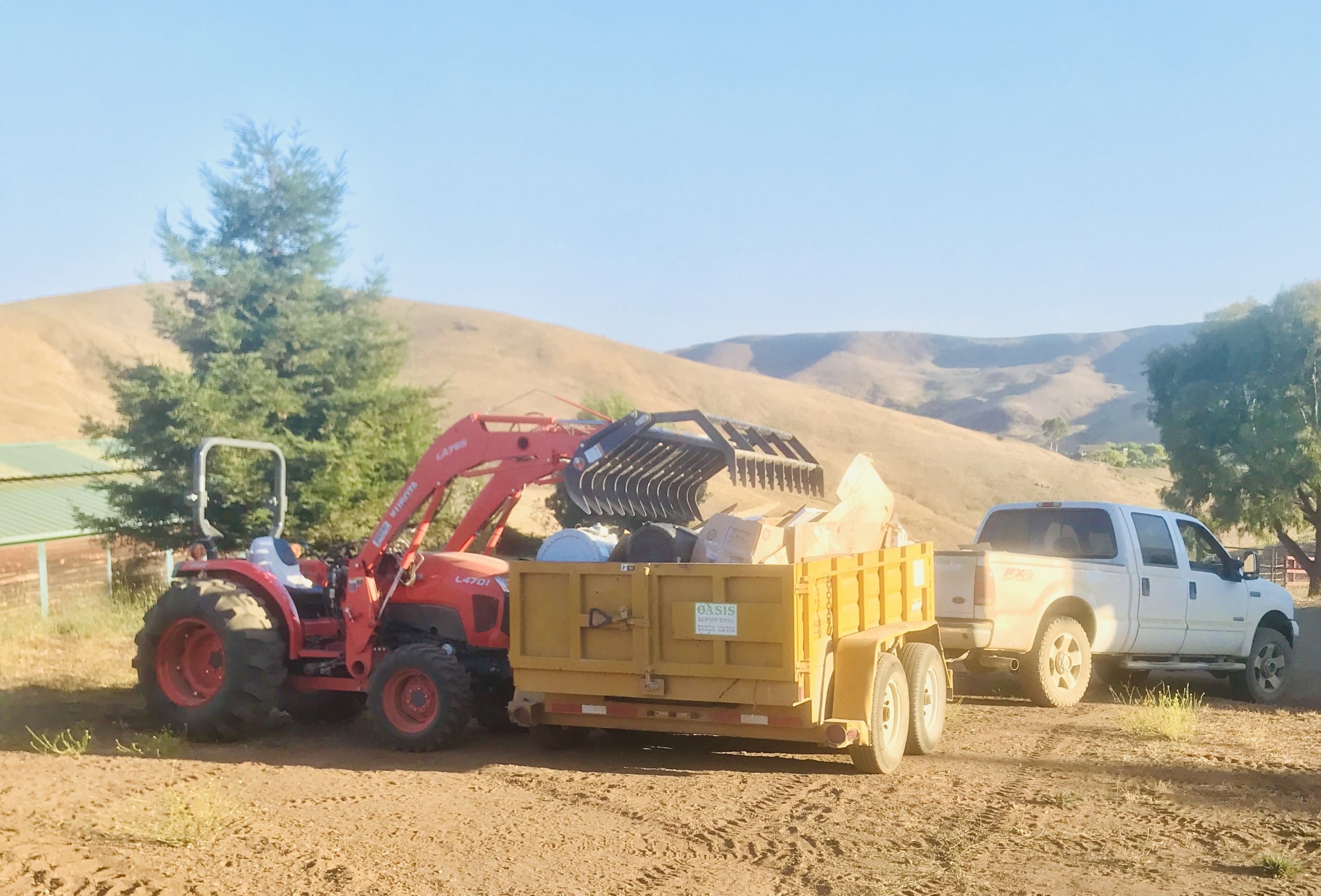

I think the answer to your question depends on what you actually plan to do with the grapple. Construction grade equipment is certainly more durable but do you really need it?
I asked myself the same question when grapple shopping for my MX5800. The LA1065 FEL will lift around 2000# in the bucket and I didn't want to sacrifice lifting ability with a heavy grapple. I move a lot of tree trunks & rocks so lift ability is key. Still, I didn't want to bust up a light duty grapple by overworking it.
I ultimately bought a 500# Blue Diamond to minimize loss of lift capacity.
Light Duty Root Grapple Attachment | Blue Diamond
Although it's rated as "light duty", I've used the heck out of it with no damage so far.

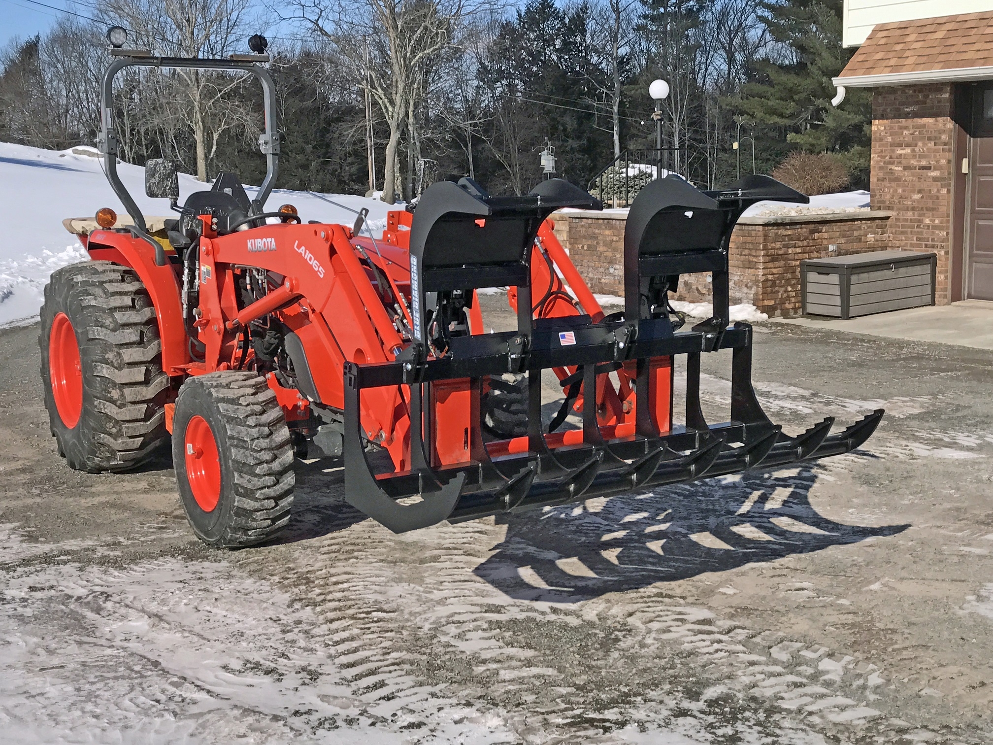

IMO if you have a small tractor, only capable of lifting 800 lbs,the EA unit would be well worthwhile. The grapple weight becomes less important if the tractor can lift 3,000+ lbs. I have a few EA attachments and think they are excellent quality and design. If a EA unit is affordable to you I would really consider getting one. My grapple weighs about 400 lbs more, is well made, but not as nice as a EA and most likely cost much less to build.
Bottom line, my grapple on my L47 does everything I want it to for $1,800. Sometimes I don't need the best.

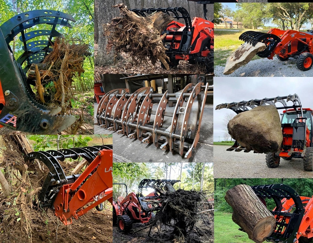

As has been mentioned, depends on what you will be moving around. Keep in mind any distance you think you'll have to move with the particular loads in mind and traveling over uneven ground and or turning starts to add lots of stress to the machine hauling lots of weight off the front.
I have an EA Wicked 66" grapple (single lid) and I have been able to do a lot of work with it: you can look through my pictures to see. Very heavy stumps (I've calc'd close to 2k lb logs that I've moved using my grapple- maxed loader [rated at 2,700 lbs lift) as well as a lot of loose brush. Stuff ends up weighing a lot more than you think: and then there's the issue of leverage, of that weight being levered out which reduces actual lifting.
Really hefty stuff that you don't face very often can be queued up and dealt with via the rental of something more industrial. Tractors are pretty fragile compared to industrial equipment.
