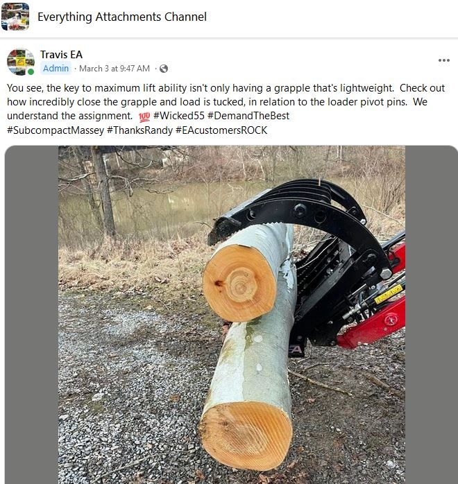

Thanks for the words, sir. I'll let Ted know to check it out.
Sent you an email with the best grapple for ya!
Travis

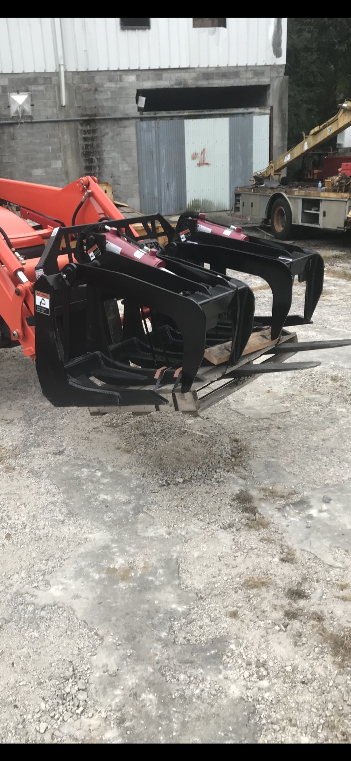

I am looking at buying a double claw grapple for my L47. I have my eye on two grapples weighing in the neighborhood of 1,000 lbs. The L47's lift at pins to full height is 2,800 lbs. Does anyone have experience with a heavy grapple on an L47 or similar spec tractor they can share? Just don't want to regret the grapple weight later, although I don't expect to lift more than 1,000 lbs with it. The L47's backhoe will serve as my ballast. I do want the construction features of a heavier grapple. Thanks
I had the 800 ish lb LP grapple on my M62...well matched. The question is what do you plan on lifting with that heavy grapple?

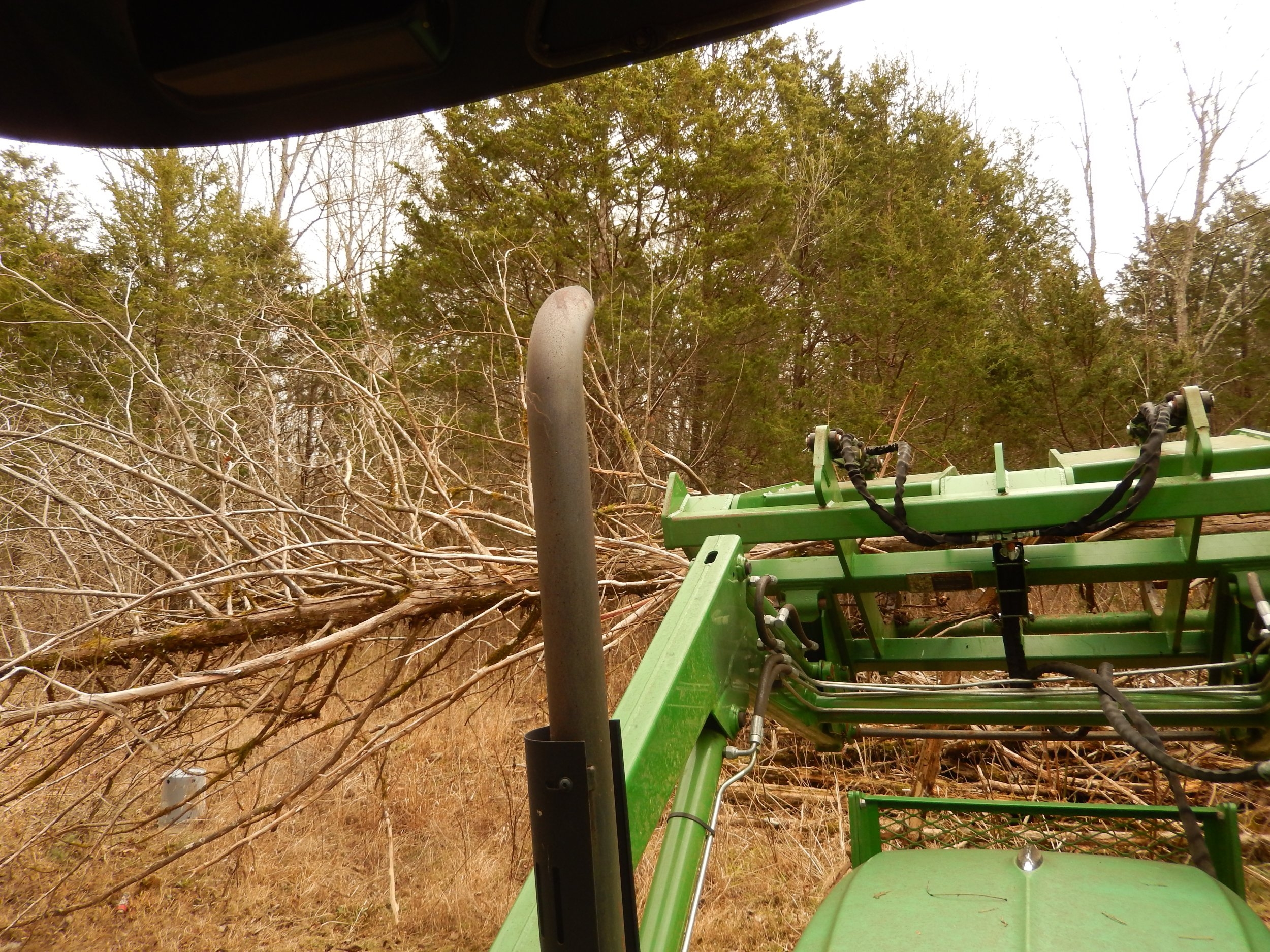

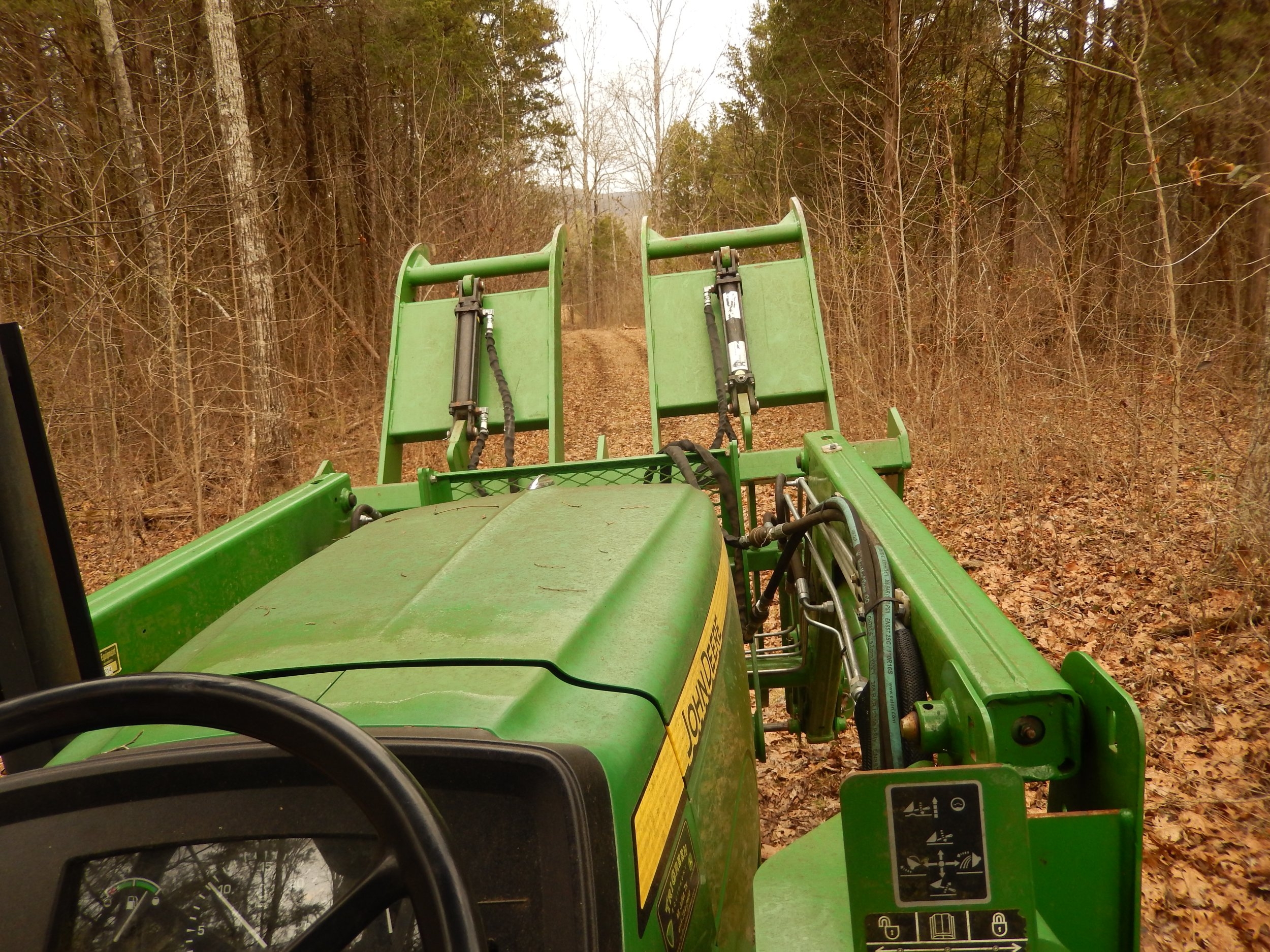

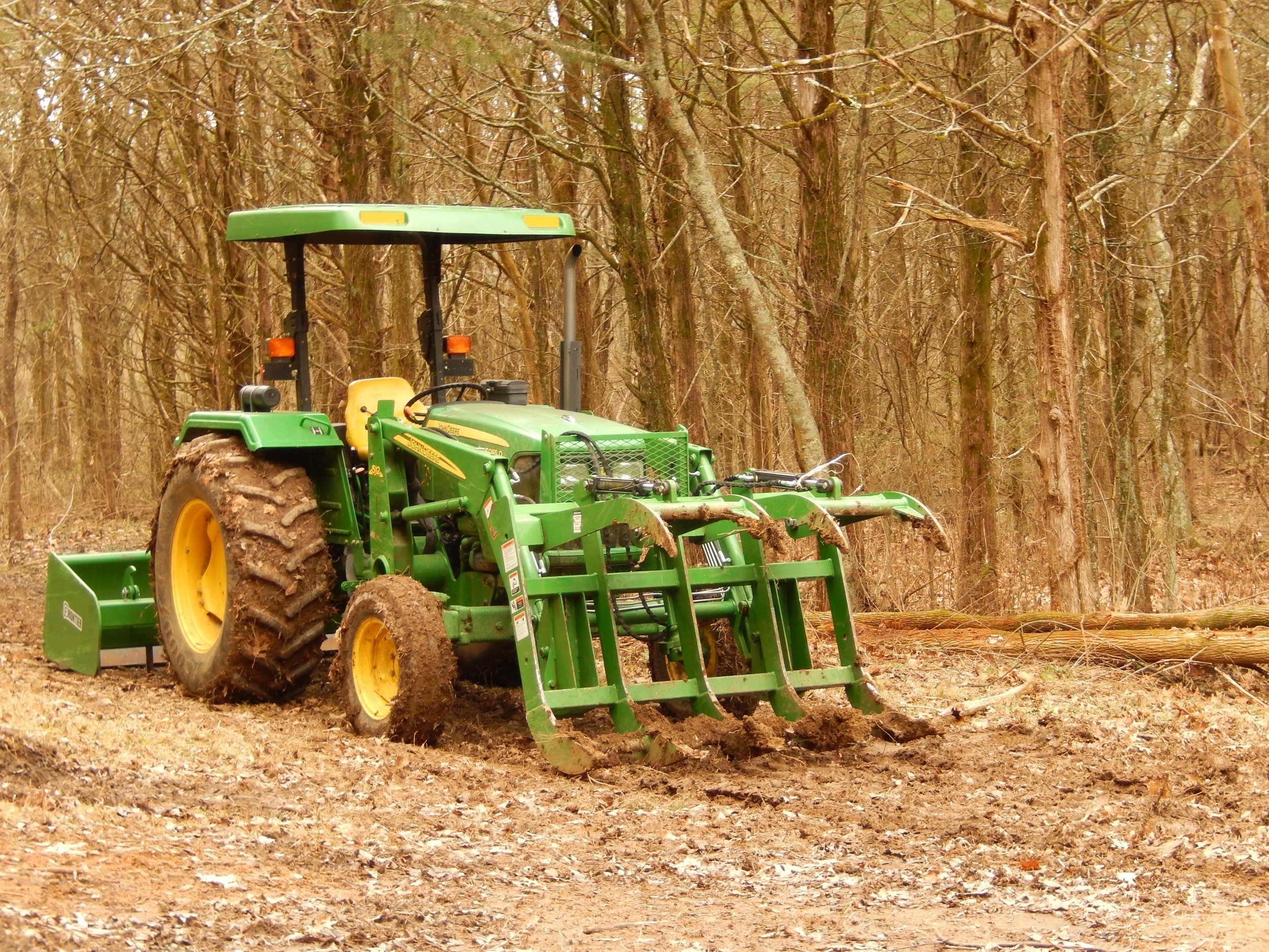

Grapples are great tools. I have owned mine for 13 years. It is on a Deere tractor, but the concept in using one is all the same:
  • Keep your load low to the ground as possible, especially when moving.
  • Make sure your rears are filled.
  • Make sure you have something heavy on the back end for counter weight.
  • Do not back pull the ground using the grapple jaws. (ask me how I know)
  • Never grasp a tree trunk with grapple before said tree trunk is fully on the ground. (ask me how I know)
  • Insure your hydraulic lines are securely fastened to your loader arm so they can't get pinched. (yeah, ask me how I know)
  • A brush guard across your radiator and headlights is essential.
  • Buy the heaviest and largest grapple your loader will and tractor can safely handle. You will thank yourself later on.
  • Don't be afraid to experiment with what you can pickup and move with your grapple. You might be surprised.

Pictured is a stump bucket/grapple (about 400#) in use.
The L47 is a pretty powerful, but it's still a small (compact) tractor. A 50 series JD is a utility size. There is no comparison.
BTW the JD didn't "gallop" like the Kubota does.
