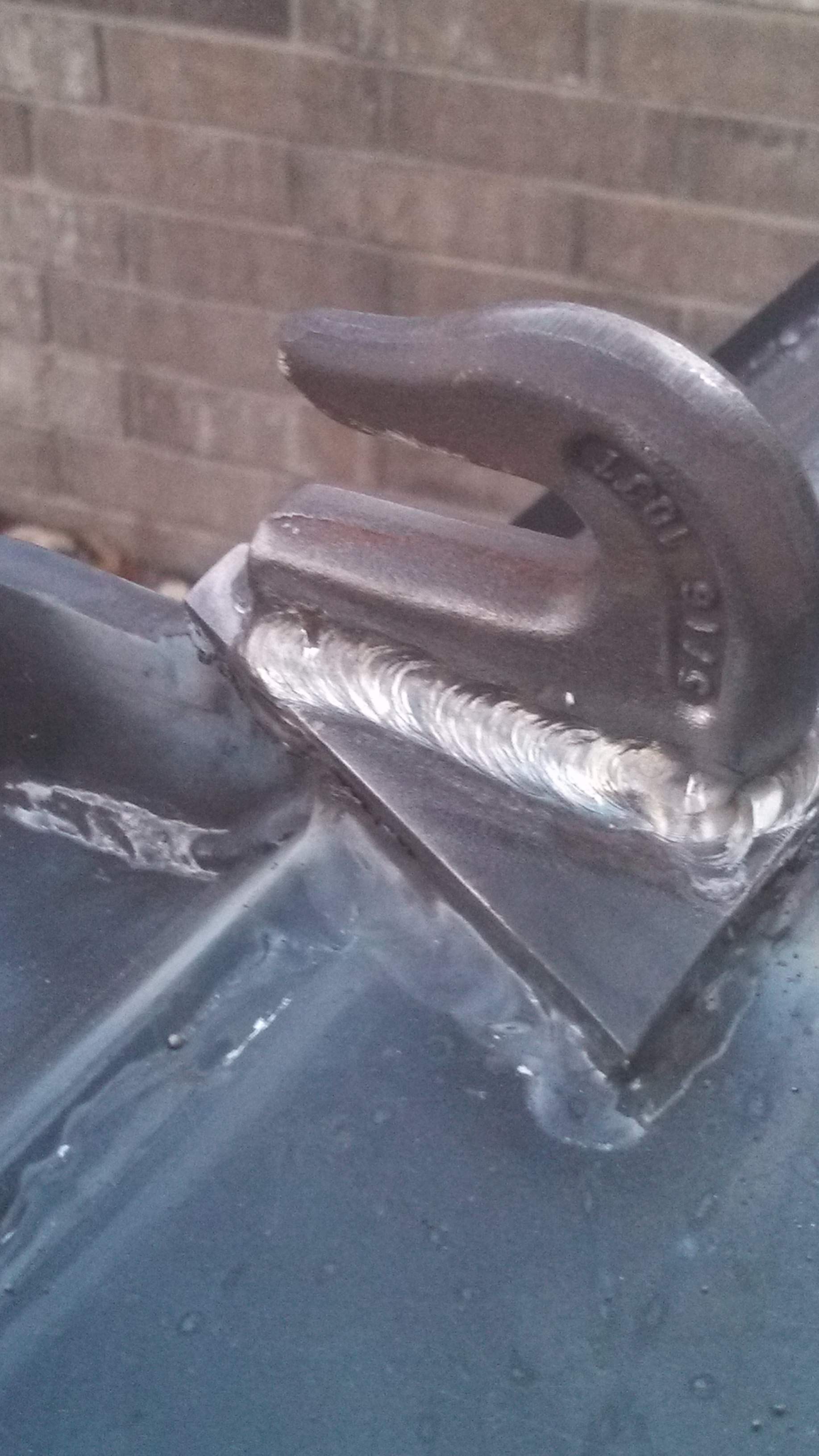

Well, the weld on grab hood approach is certainly cheap. And it has always served me well. For less than $5 per hook, you are all set. I am not saying it is the "best", just expedient and cheap. It is your tractor, do what you think is best. :)
Wow, is that a beautiful looking and functional weld.

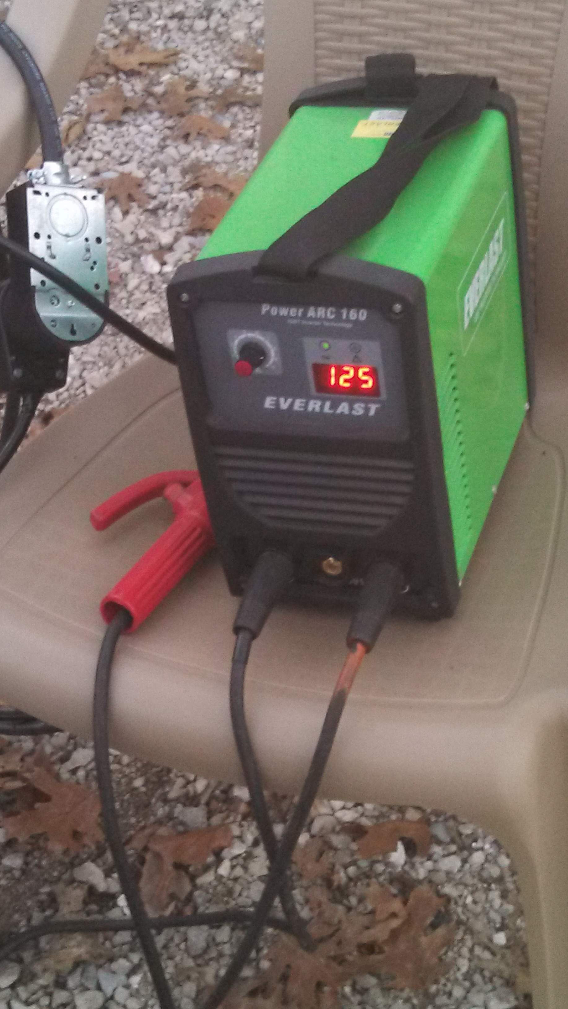

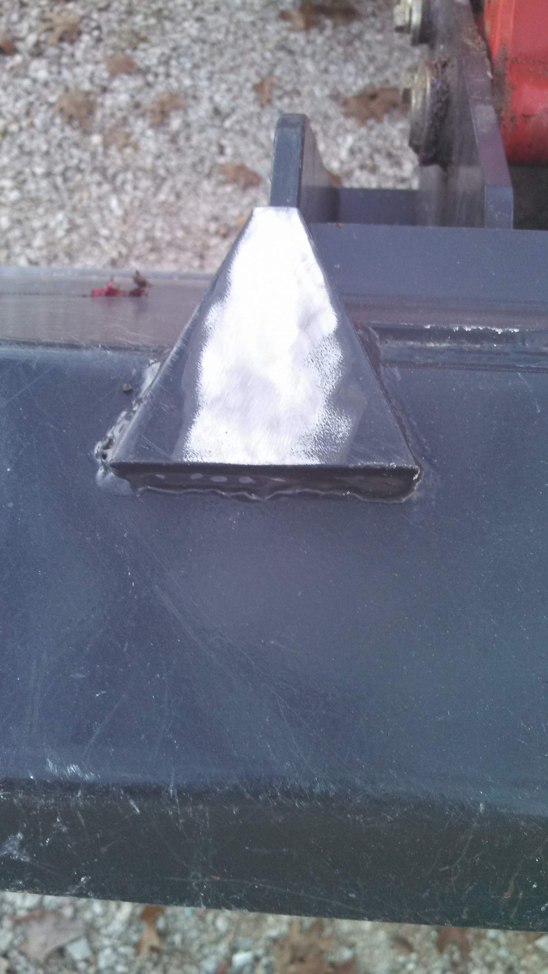

Thank you.. I am relatively proud of that 7018 weld at 125 amps with my little Everlast PA160. It must have caught the eye of others as well, because a "professional" welder in Florida stole the photo and put it on his website as an example of his work. That "pissed" me off considerably and I sent his some electronic hatemail to which he basically told me where I could go. It was brought to my attention by another member no longer active, and he gave him a piece of his mind too, but the "pro" did not really care. If you look carefully you can see the little brick retaining wall by my house where a lot of my photos are taken, as that is where I work on my tractor. In my opinion my weld with the stick is a better weld than the Korean fella did with the MIG on the plate on top of the bucket. Here is a photo of the welder that made it.

James, although I'll concede that there are differences in the various brands of welders and Everlast is well known for excellent quality,,,, the quality of your hook welds is much more due to the person holding the welder stick than the machine sitting nearby. :cool:

Oh, I agree, any DC stick welder capable of 125 amps could have made that weld. I think I could have come pretty close with my old AC 225. Maybe with a bit more spatter. OH, and cleaning down to bare metal NEVER hurts. :)
