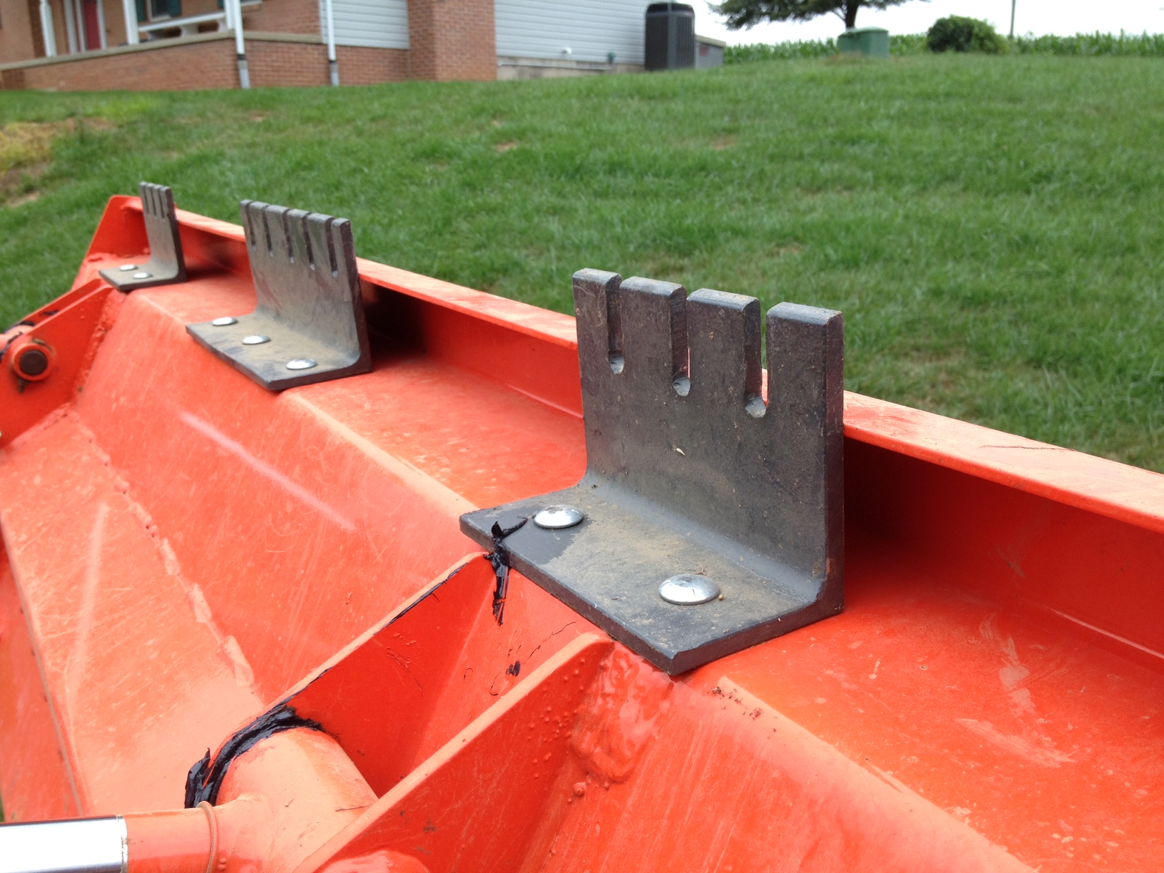

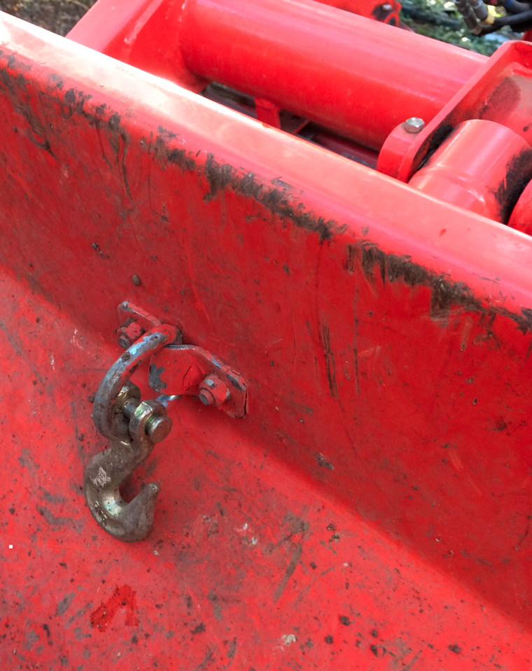

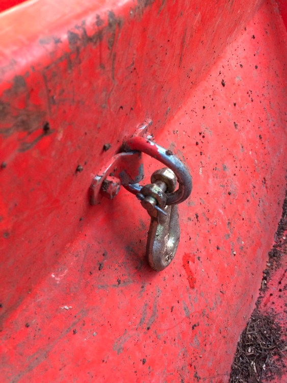

My approach was a sturdy bolt-on angle with slots. I like to weld (made the cab) but this is something I did with the first Kubota and it served well for ten years on that one. It has always been up to the task. Works with the chains toward the front or rear of the bucket. The picture of the 6' Landpride deck hanging out there gives some indication of the strength. That hookup made it easy to tuck the deck under a shelf for the winter. Works with any chain up to 3/8".

My approach was a sturdy bolt-on angle with slots. ---------
I agree with chim on chain slots. :thumbsup:
Cut slots into the bottom channel iron on the fork frame and in the pin on mounts of the brush fork frame.

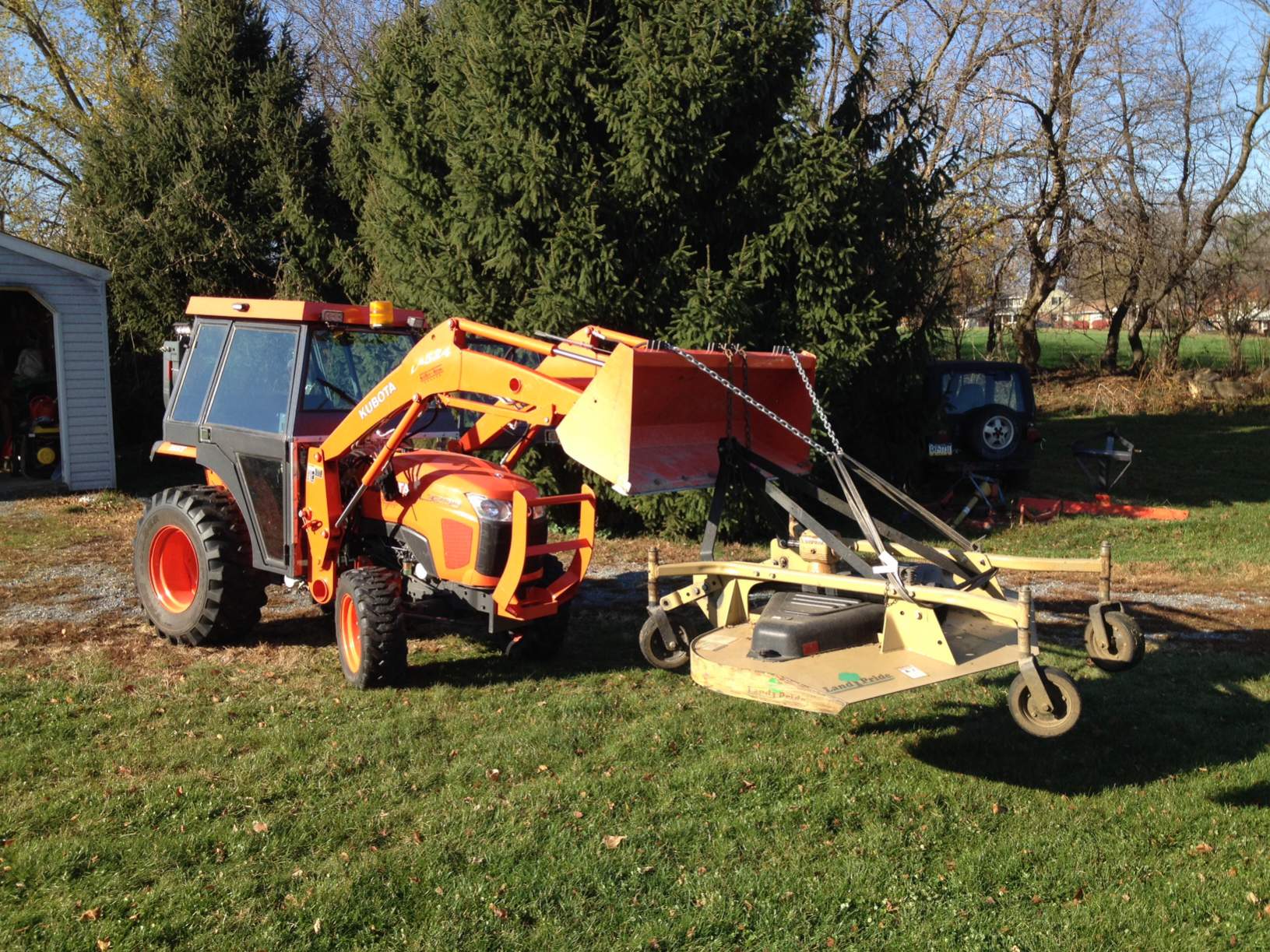

I hated having to choose one or the other, so...
This is a 1666 pound WLL D-ring, with a 5/16 clevis grab hook. It is bolted through the top of the cylinder mount for reinforcement. I use 5/16 and 1/4 GR70 chains. The 1/4 chains have 5/16 hooks. The 5/16 chain hooks will hook on the D-ring if needed, and the hanging hook will grab either size chain. This is in the center of a BX bucket. If I need a 2-point lift, I swing the chain over two of the toothbar teeth, inverted V fashion.
Normally I would have the bucket dumped when lifting, but with the cutter, I lifted it up, then pulled the trailer out from under. I needed the extra reach of the level bucket to get past the fender.

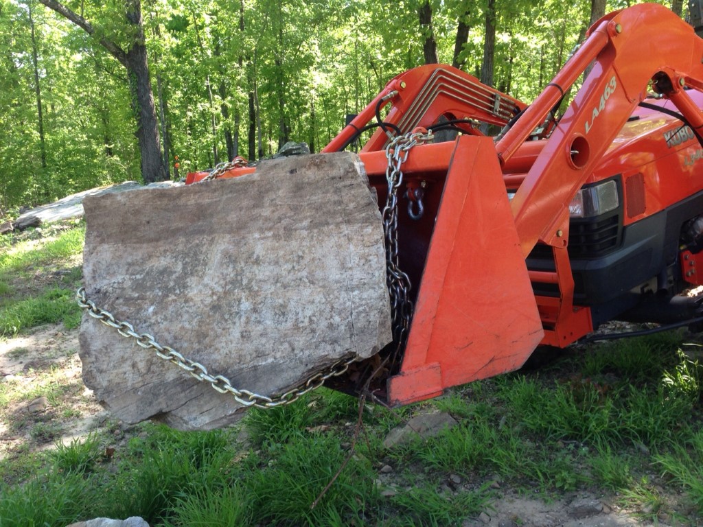

I've seen a good number of threads regarding bucket hooks but I rarely have seen any pic's of them in use. Are they only for lifting or can you lay a log in front of the bucket and wrap short chains in some rapid convenient fashion? I've just been going around the whole bucket.
/ Bucket Hooks? Or clevis mounts instead? #33

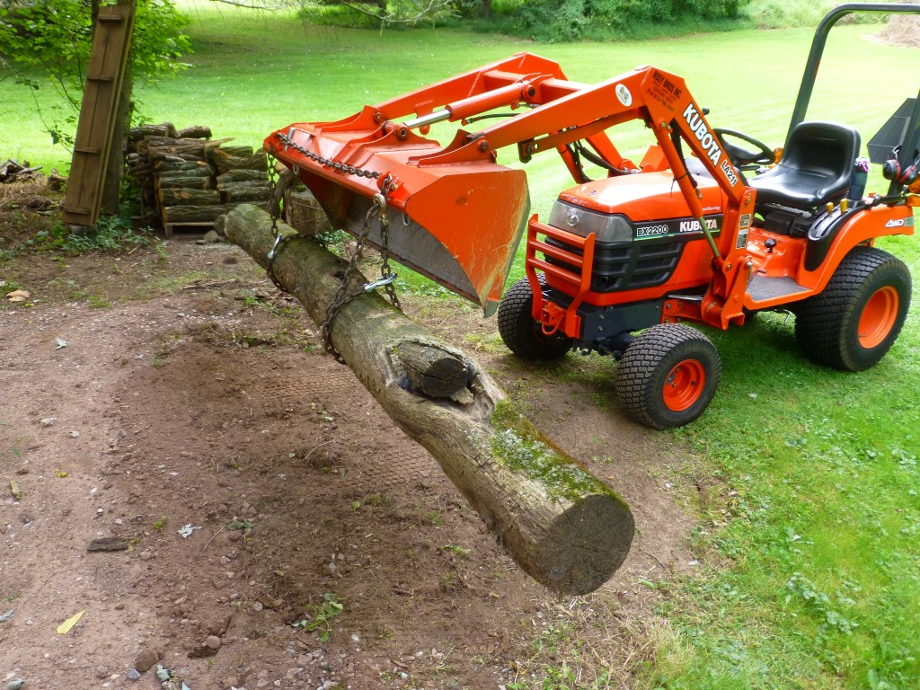

You could do it for a log, but it is very convenient to use chains for a rock too big to fit in your bucket. Just put it in the bucket as much as will fit, and then run a chain from one hook to around the front of the rock and slip the chain into the other hook. As you lift the chain will tighten up as the rock starts to fall out but can't now due to the chain around it. You can also use it to an extent to pull small trees out of the ground by running the chain around the small tree several turns leaving each end with enough slack to reach both of your bucket hooks. Curl and lift your bucket as the chains tighten up on the trunk. If your tractor is able, the tree will pop out of the ground.
I sometimes use a chain and a bucket hook to repel down a steep embankment to get down to clean out a culvert at the bottom. The chain makes it safe to go down and come back up. You can also wrap a chain around any object you can get it around and use it to lift it.

How about holding a big rock in the bucket:

I couldn't find my pictures but they surely look like what Kenny posted. I started by just wrapping the bucket but they can slip off and are more trouble to adjust having the extra hooks allows you to quickly make the chain the size you need and just toss the excess length where convenient.

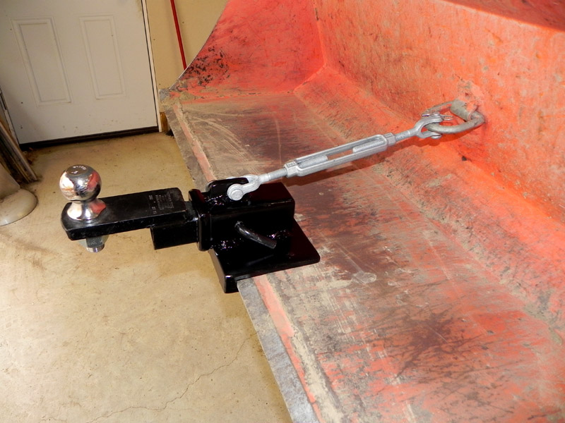

I started with a single grab hook welded in the center of the bucket on top. This worked great and as time went by I kept testing it. Well, I started clearing a lot with some good size oaks and in using the tractor as a skidder I bent the top of my bucket down about 3/8"; I had found it's limit. So I straightened the top (no easy chore) and then welded a d-ring inside the bucket to use for pulling. I have maxed that baby out a number of times. So I am a proponent of having both and having them welded. The d-ring is welded where the bucket has a support piece on the back.
Later, I wanted an easy on and off trailer hitch and found that d-ring to be very useful in that regard. The hitch is on or off in less than 30 seconds and does not move sideways at all.
