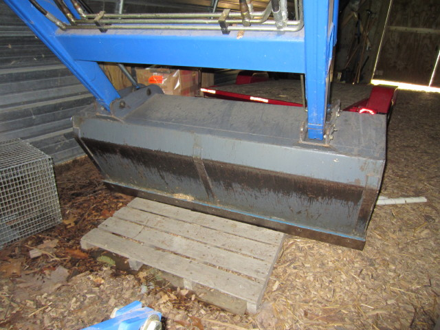

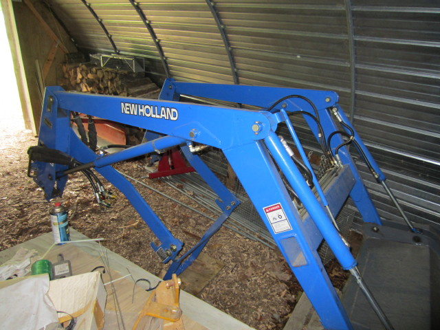

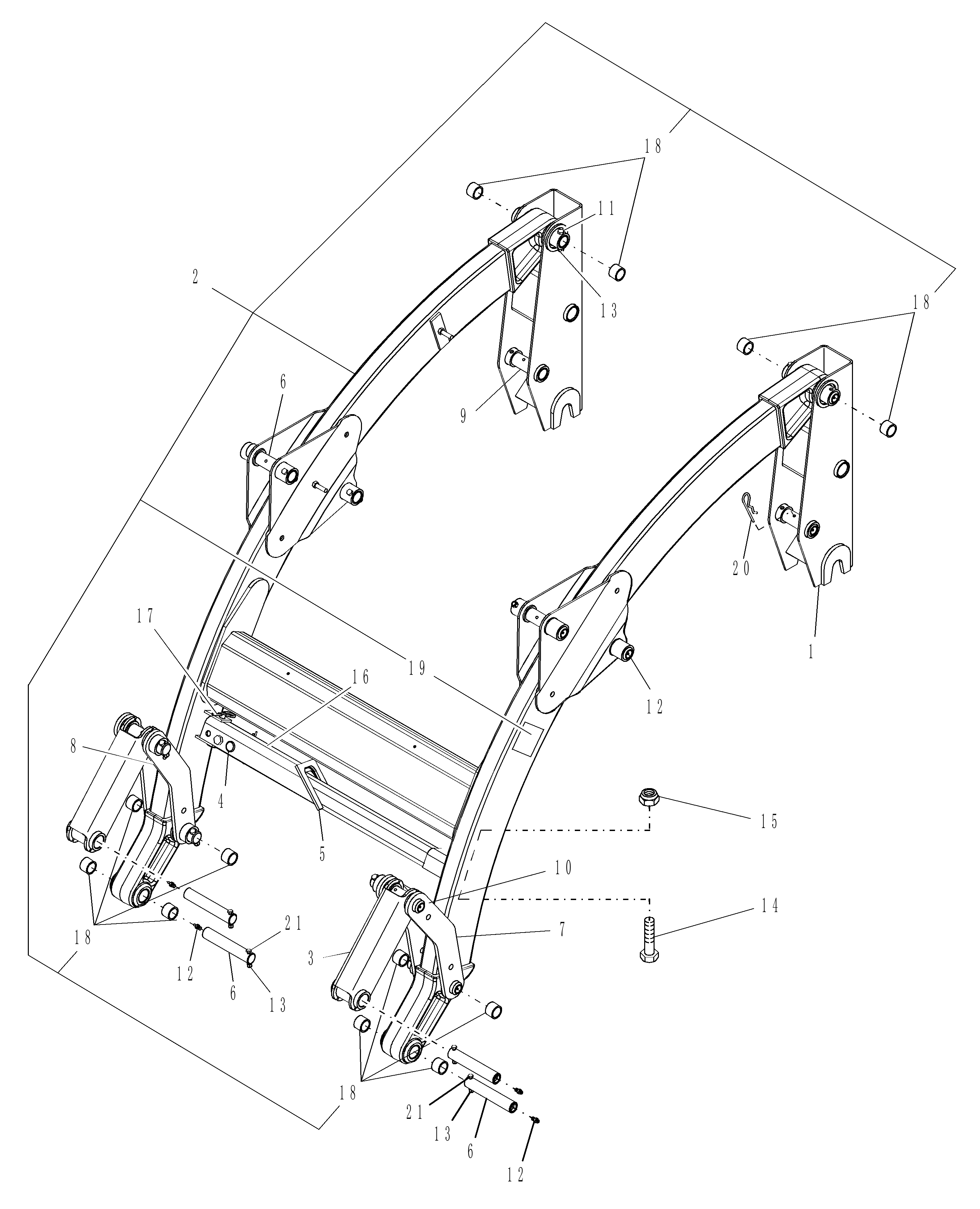

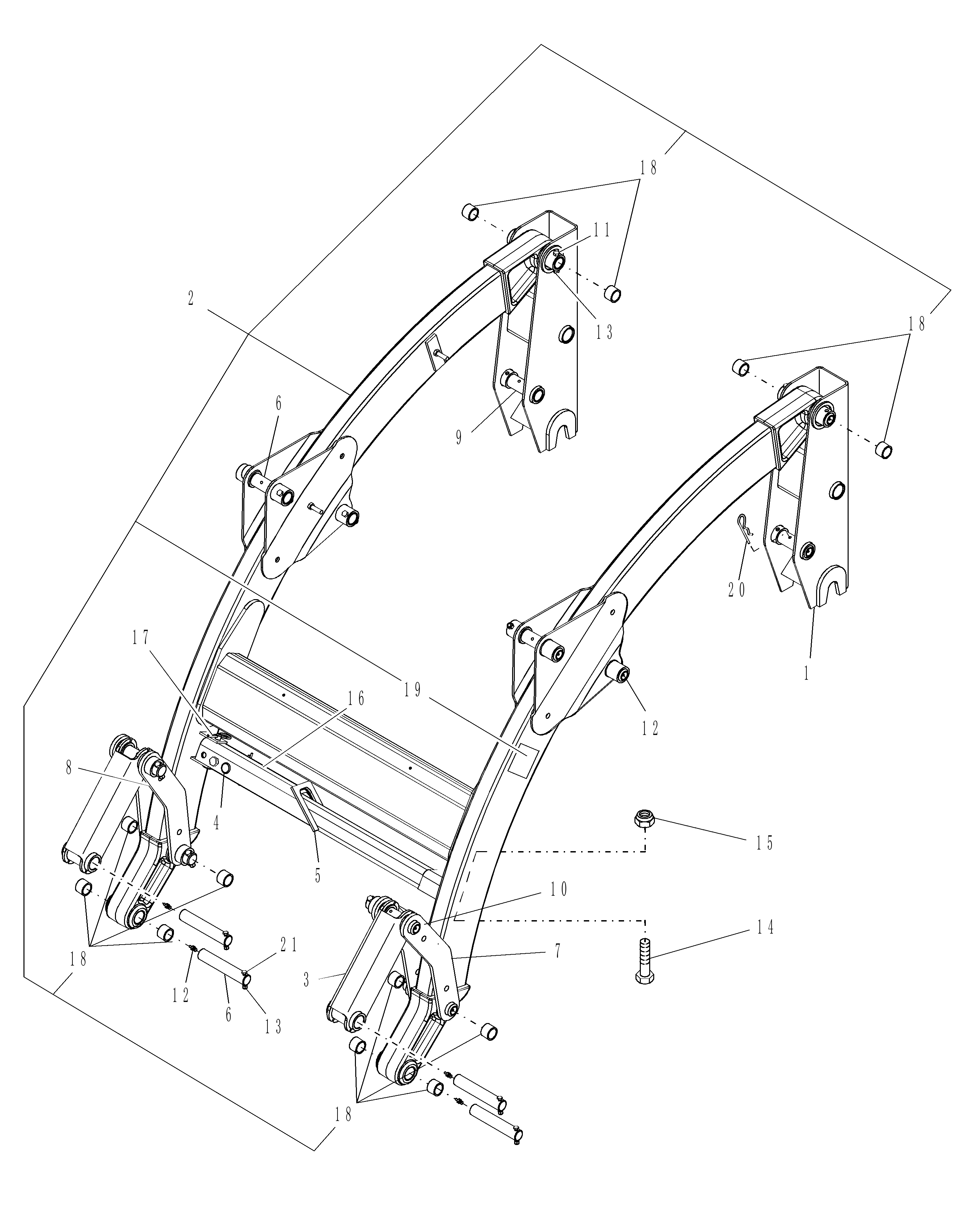

I have a New Holland TC29D. My loader has the level indicator tube, but nothing attached to bucket. Does anyone have a similar model that can post a picture of setup?
Thanks...
/ Bucket level indicator #2
Parts breakdown of the 15LA loader but doesn't show a bucket level indicator.
Edit: Same thing for the 14LA:
I had a TC29DA at one time but the loader was SSQA. Don't recall whether or not it had a bucket level indicator. P.S. Someone will come along and say you don't need a bucket level indicator. Pay no attention. :)

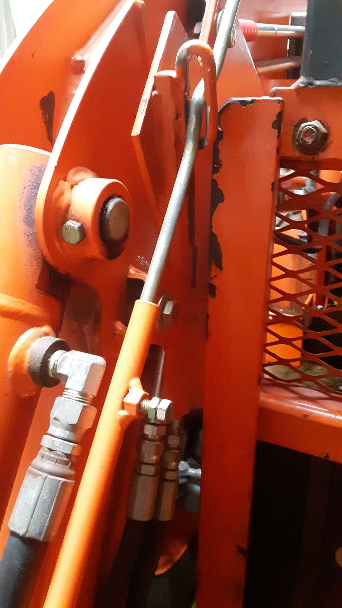

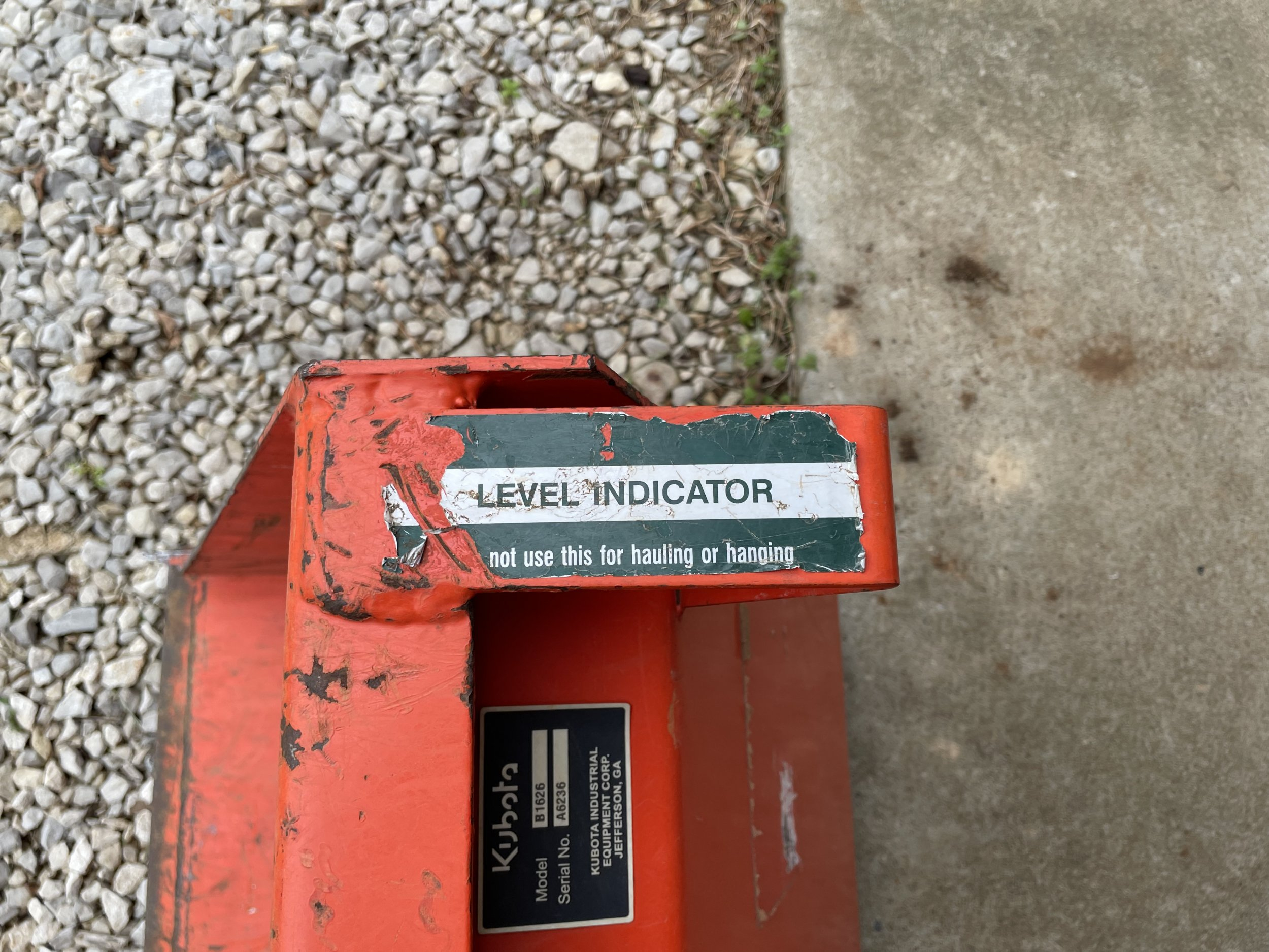

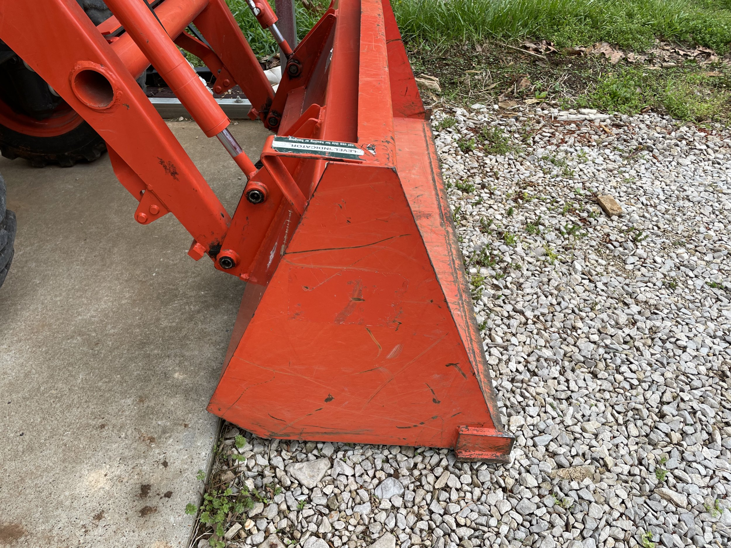

Not sure about NH but if you have a tube, a lot of these will have a rod that slips inside and is adjustable so that it's either flush with the tube or something else do distinguish level.
Pictures are a kubota version.
A little studying of what you have and you should come up with something.

Thanks. The indicator you made looks impressive. Since I have the factory tube, I was just looking for how to hook up a rod. I'll try to figure something out, maybe a NH owner will post a picture before I do...

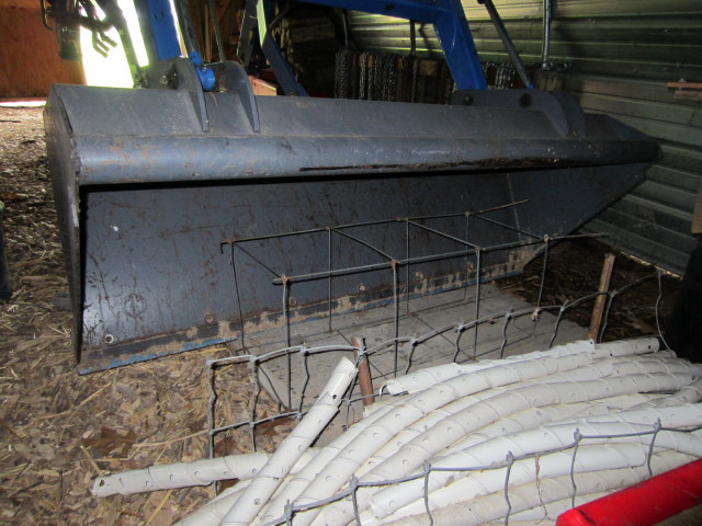

I sold the tractor but these are the best pics I have. I think the rod went down and fastened into a hole in the bucket just above the cylinder pin.

Rod just needs to be a few (2-5) inches above pin so as bucket rotates around pin, the rod connecting point rotates in a arc to push/pull rod up/down in tube....Just make sure rod is long enough it does not pull out of tube when bucket is in full downward rotation...

Thanks for the video, pics and tips. I'll look for a mounting hole/braket again. I just found a 7308 loader (like I have) picture that shows the indicator rod. I'm sure I can create one using that picture.
Thanks for the help.

Yeah, and you have a flat top on bucket. Mine is rounded, so no help there.
After cleaning dried mud out of indicator rod mounting hole, I measured from hole to top of tube when bucket is maxed out. Added 1" for 90* ange that mounts into hole. Figure I will add 2" to stick out of tube. 40" should do it...

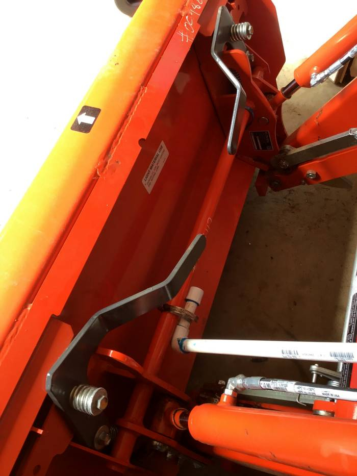

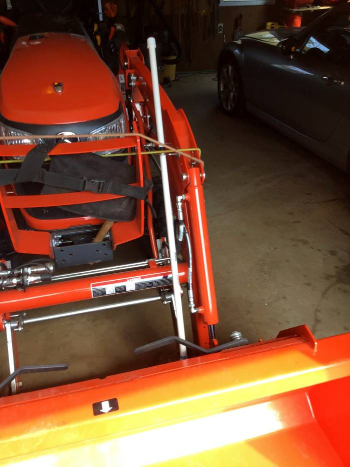

This might work. Easy to make. Used some 3/4 inch PVC, two plugs, elbow. Eye bolt on FEL Some tape to mark the level point. Screw clamp to attach to back side of loader. I've now added a zip tie, too.
