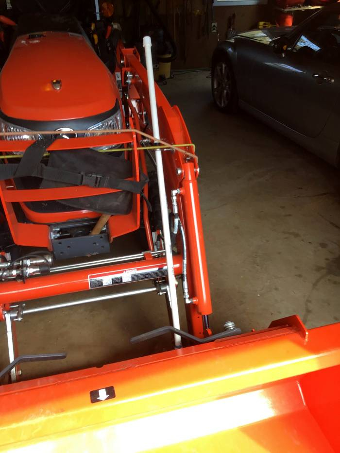

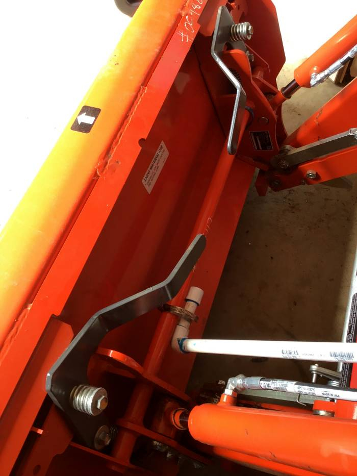

I did this on our B2601 Kubota but it would work on almost any machine that does not have a level indicator.
Just took 5 ft of 1/2 inch PVC, short 3/8 inch eye bolt, 2 nuts, 2 big washers (B2601 had big holes on each side already), a screw hose clamp, elbow and 2 caps. Use level and mark with a piece of black tape.

I've never understood the interest in bucket level indicators. I just look at the top of the bucket, which is parallel with the bottom and visible on either side of the tractor, and judge by that. Is the top not parallel to the bottom on some units?

I find mine extremely useful. And the top of my loader is parallel to the bottom. But I am looking at it all from an angle while setting in the seat. A change in tilt of just a degree or so is all it takes to dig a hole you didn't want to dig, or to not cleanly scrape what you wanted to scrape. No way you could get the tilt exactly right in a repeatable fashion on my tractor without one, regardless of the quality of your eyesight.

My bucket has a big flat top, so I don't use the OEM level indicator for that. I do use the indicator when using the ssqa snow plow, as I want to keep my uhmw polyethylene edge at the correct angle.
I now have a camera up front to get a perfect view of the pallet forks, which has worked out great.

I find the leveller very useful in some situations and some I don't use it at all. When skimming the ground to pick up brush I position the leveller quickly then drop the bucket in " float". That keeps the right tilt without digging in. Saves time. Minor angle errors are critical here. Same for plowing snow with a bucket especially on non frozen ground as previously posted. Quick and accurate.
When just loading gravel I don't look at it at all.
It's there, it's free, and I use it when it helps.
