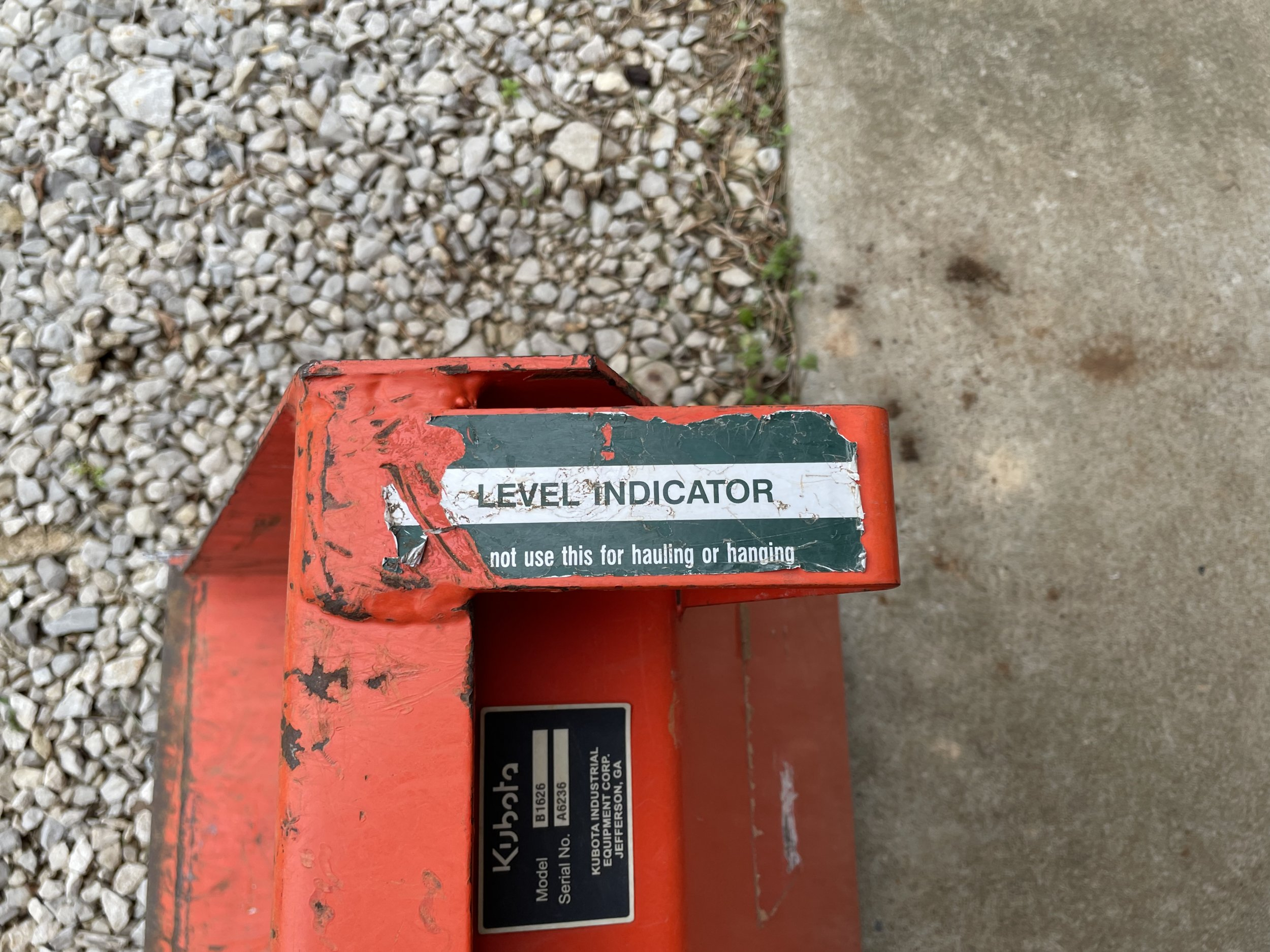

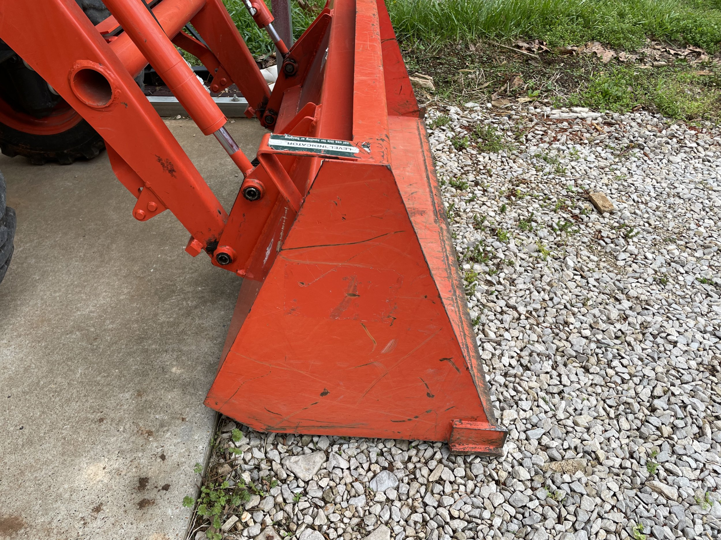

I sold the tractor but these are the best pics I have. I think the rod went down and fastened into a hole in the bucket just above the cylinder pin.

Rod just needs to be a few (2-5) inches above pin so as bucket rotates around pin, the rod connecting point rotates in a arc to push/pull rod up/down in tube....Just make sure rod is long enough it does not pull out of tube when bucket is in full downward rotation...

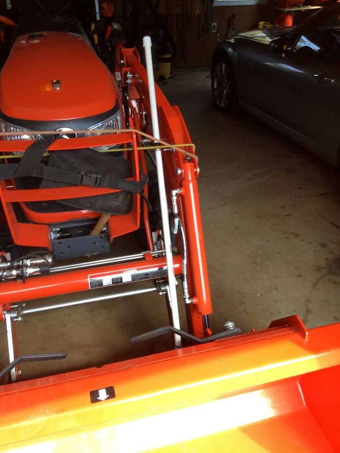

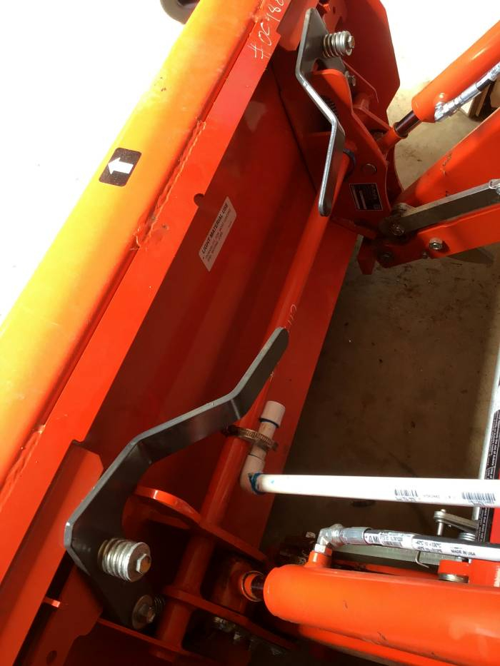

This might work. Easy to make. Used some 3/4 inch PVC, two plugs, elbow. Eye bolt on FEL Some tape to mark the level point. Screw clamp to attach to back side of loader. I've now added a zip tie, too.
