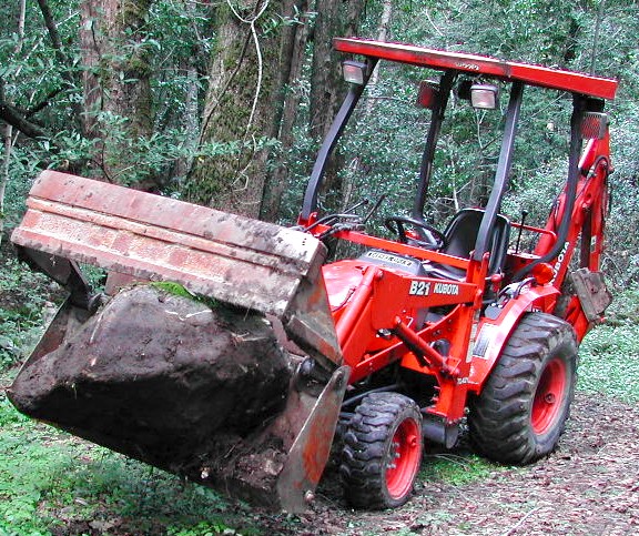

How about these examples to show that a grapple can manage big
single rocks and tree trunks. As far as standing 4" tree trunks, just knock'em over, stick the grapple
underneath and pop'em out. Which of these tasks can be done with a 4n1???
If you reread what I wrote, you will see that I said "2-jaw grapple bkt". Yours is one jaw, which allows
you to lift at capacity from the center. Here is a 2-jaw bkt add-on.
GP
In clearing small trees with a 4n1, I open the bkt next to the sapling and lower it while turning the
wheel. This pushes the sapling over and then you close the clamshell on the trunk. Lift, curl, push,
and/or pull and it is out. No need to dig it up.

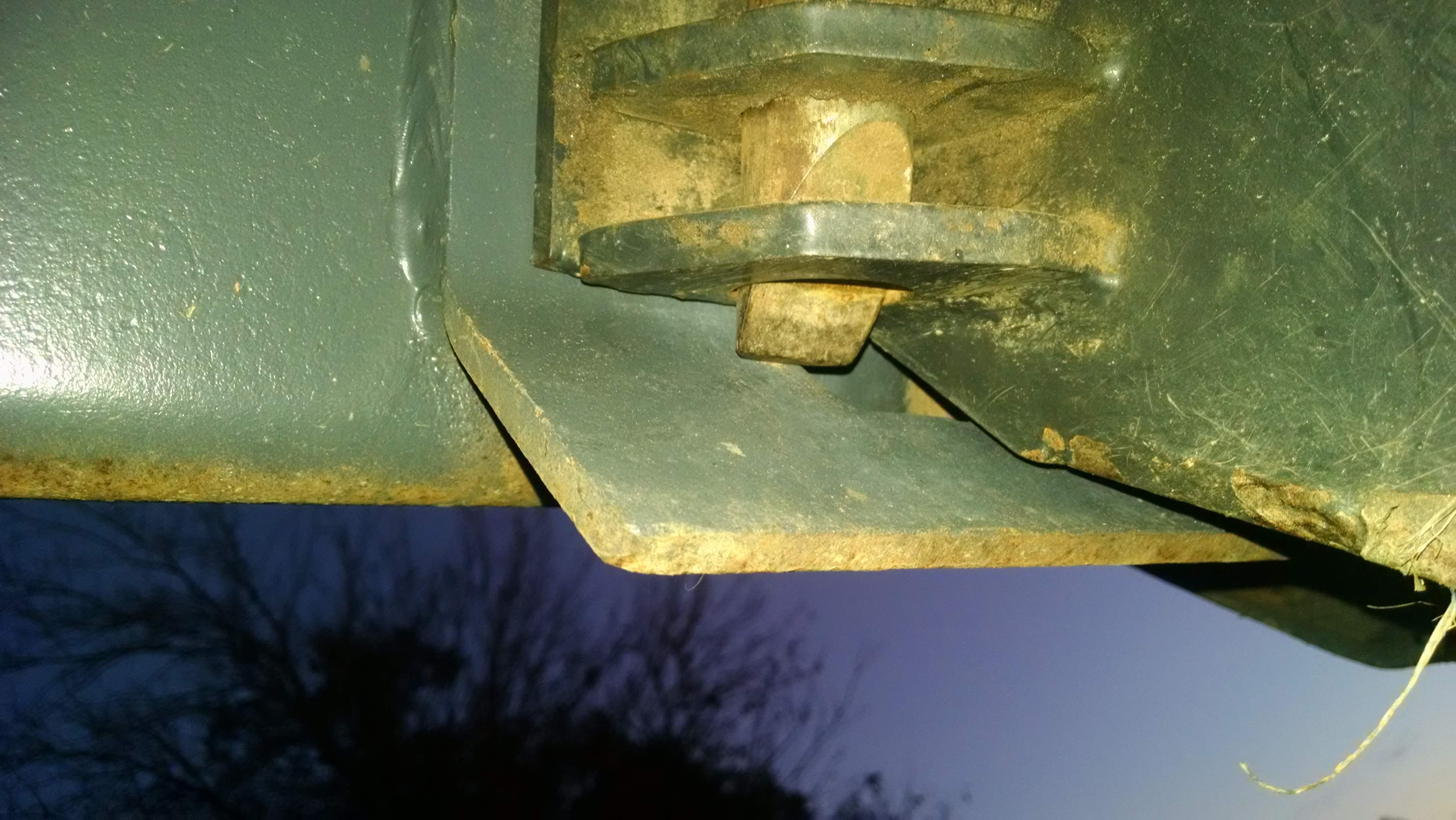

Well, to much my disappointment, the 4n1 didn't hook up as can be seen from the pictures. The good news is that the cylinders are working just fine and there are no apparent leaks. I hope to take Friday off and get the torch out to widen the slots for the pins to go into. I'm assuming this is fairly straightforward, just cut out the slots so the pins will fit... Anybody have any thoughts on things I need to take into consideration or any pointers that might make this adjustment go smoother.
The bucket hoses will need to be rerouted and possibly shortened, they are coming out from the bottom left side of the bucket and I will need to run them from the top to my center post.

Odd that the pins are wider spaced. My experience has been that the Kioti QA is narrower than usual.
Agree that torch or plasma cutter would be the way to fix it.

Hmm, that is odd, I would have thought all QAs made to fit SS would be really close to the same, but I looked at a few of my QA attachements this morning and some have two slots and some three, but none had one big slot on the lower attachment point. Troch and grind will fixer up.
   / bucket size #30
I understand the John Deere ones are narrower. I've never seen one , but that is the rumor. :confused:
