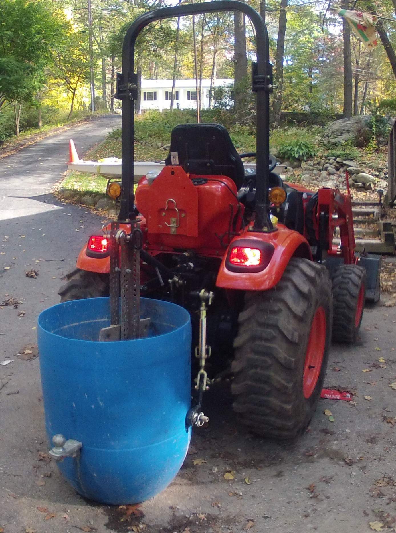

I also have the BH but it's too much weight for FEL work as well as hanging out too far. I also find that the box blade (5' TSC) isn't enough ballast and also sticks out too far. I made a compact ballast bucket weighing about 650 lbs and it's ideal. I cannot lift the rear tires off the ground (tires not loaded).
Post pictures of the QA and other modifications/attachments.
