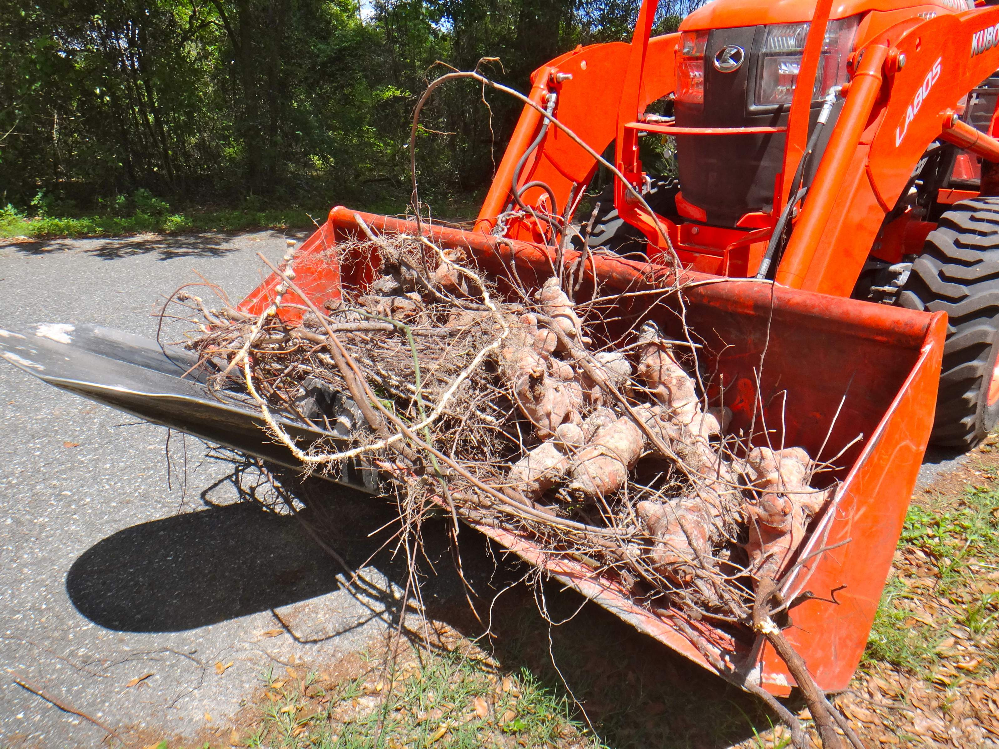

We had a good rain, our first in awhile, so the ground is soft. Decided to dig up wild climbing rose corms, often call "Sweet Potato Vines" in the South. These things run up a tree; eventually pulling the tree down. Often wild grape vines follow the climbing roses into the trees.
Bucket Spade works really well in this situation, where one is moving between digs. No changing seats, no dropping stabilizers, like with a Backhoe. Just dig, then drag or push back excavated dirt with the Rollover Box Blade on the 3-Pt., also serving as counterbalance.
I excavated the pile, which is mostly wild rose corms but also has Smilax corms and grape vine roots, in about two hours.
Pretty good view of optional L2296 72" Round-Back Heavy-Duty Bucket with SSQA, which is available for all the 'L' series Kubotas. L2296 weight 100 pounds more than the standard L2235A 72" bucket. L2296 make an absolutely rigid mount for the Bucket Spade.

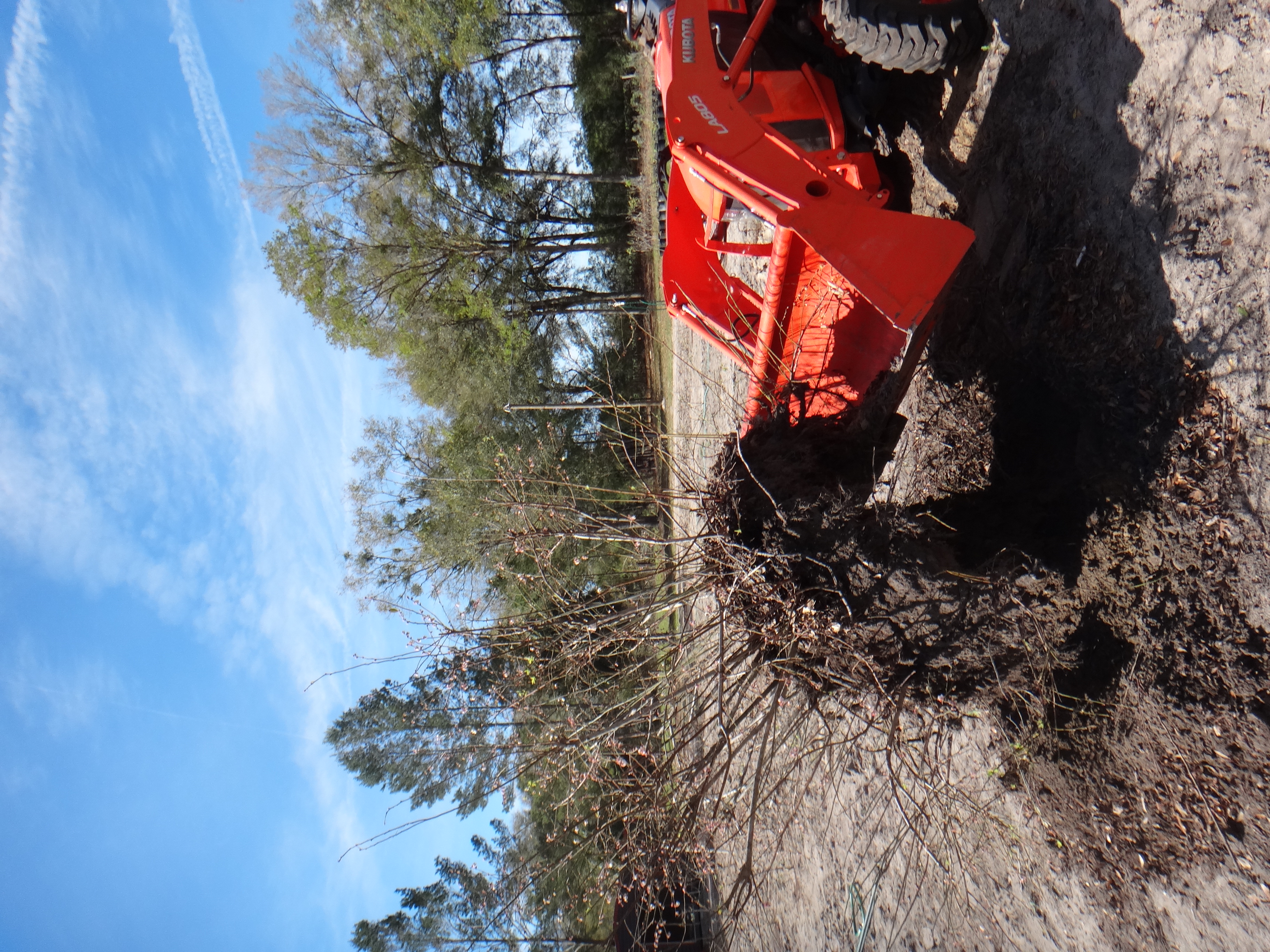

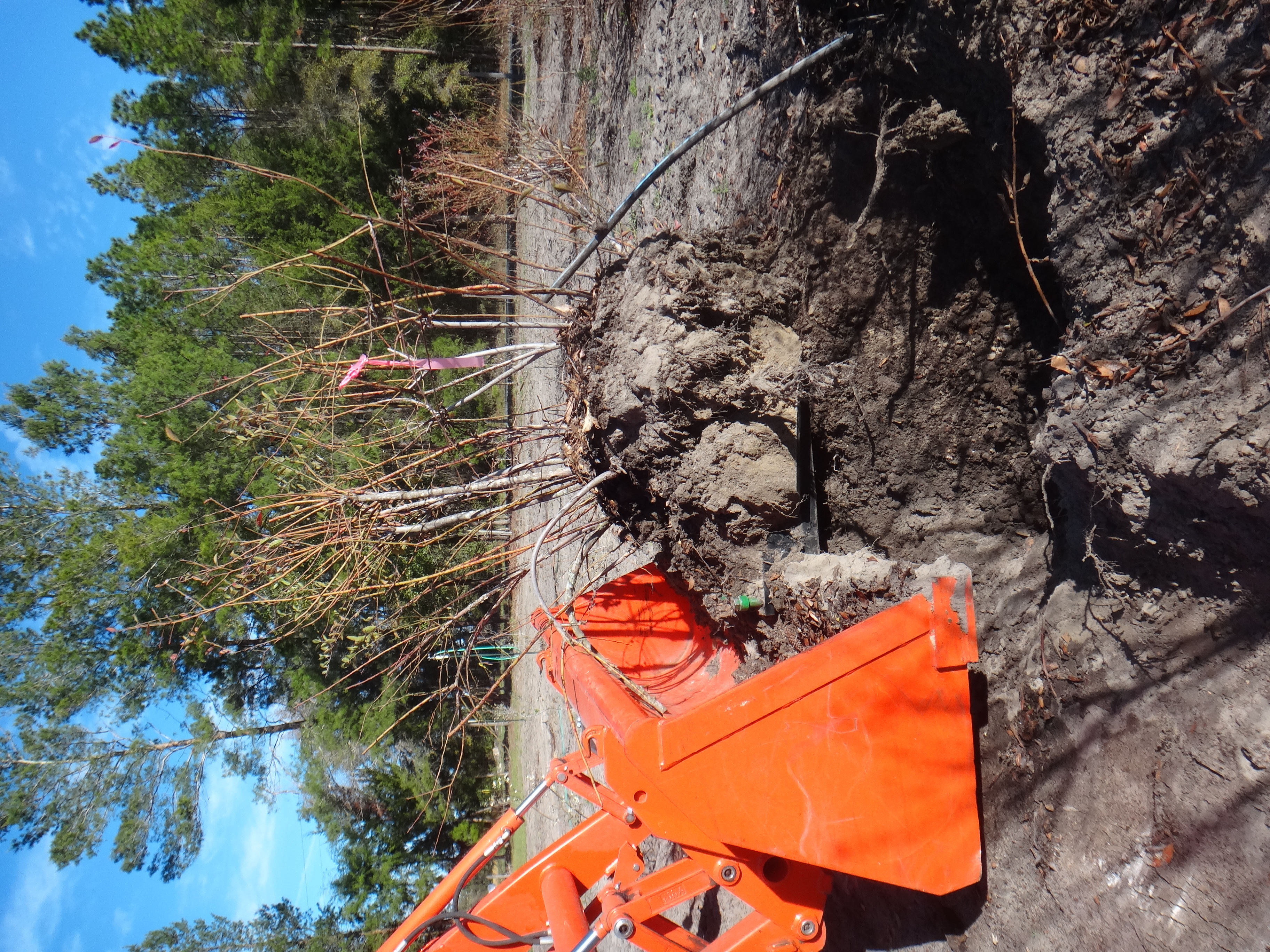

Working the Bucket Spade yesterday, once again in the Blueberry field, to excavate 25-year old plants requiring separation/rejuvenation.
Bucket Spade is also an excellent tool for excavating Palmettos in the coastal SE states.
Good tool mounted on a rigid bucket.
LA805 weighs 1,279 pounds.
LA2296 SSQA H-D, R-B bucket weighs 180 pounds.
Bucket Solutions' Bucket Spade weighs 110 pounds.
Some of the LA805 weight bears on the BS/BS, say 400 pounds.
So FEL + LA2296 + BS/BS total weight = 690 pounds, bearing on the sharp edge of the bucket spade.
Once the bucket spade is positioned in the ground, you push it to depth by moving tractor forward.

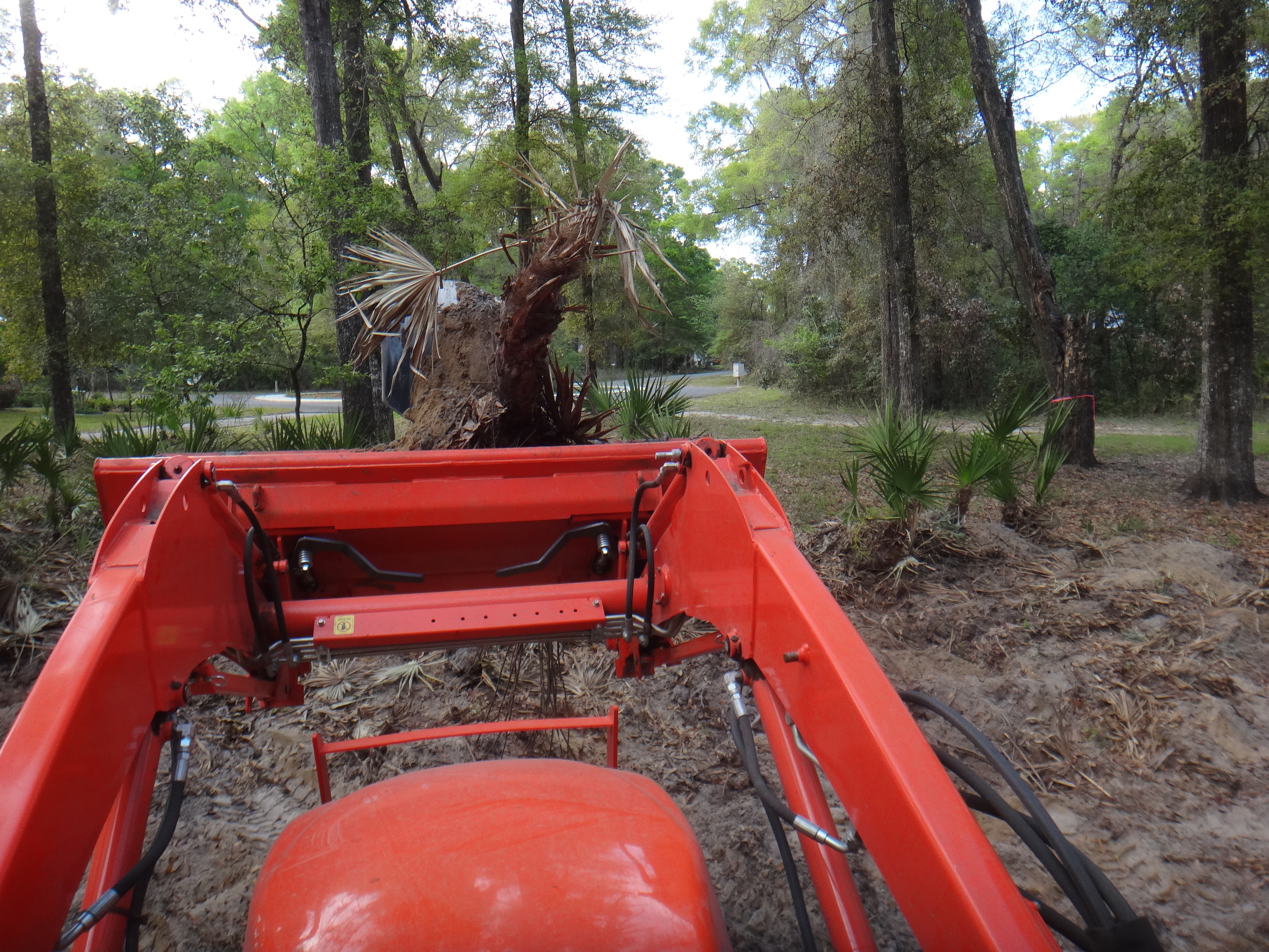

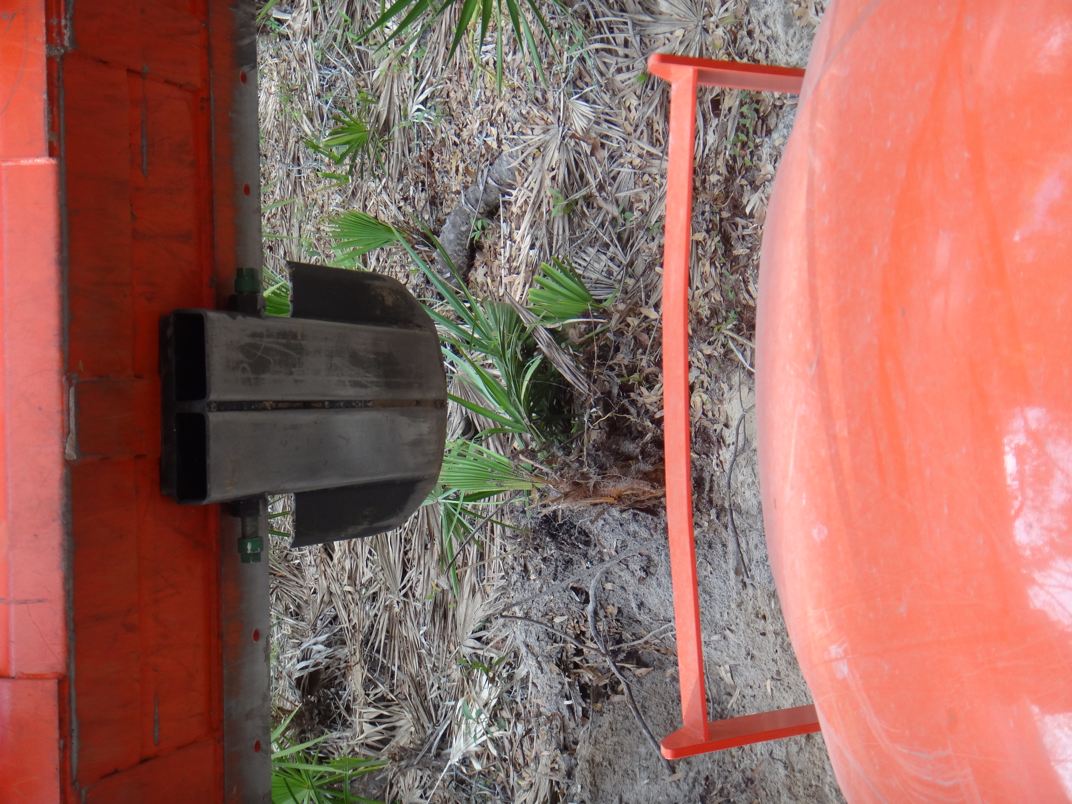

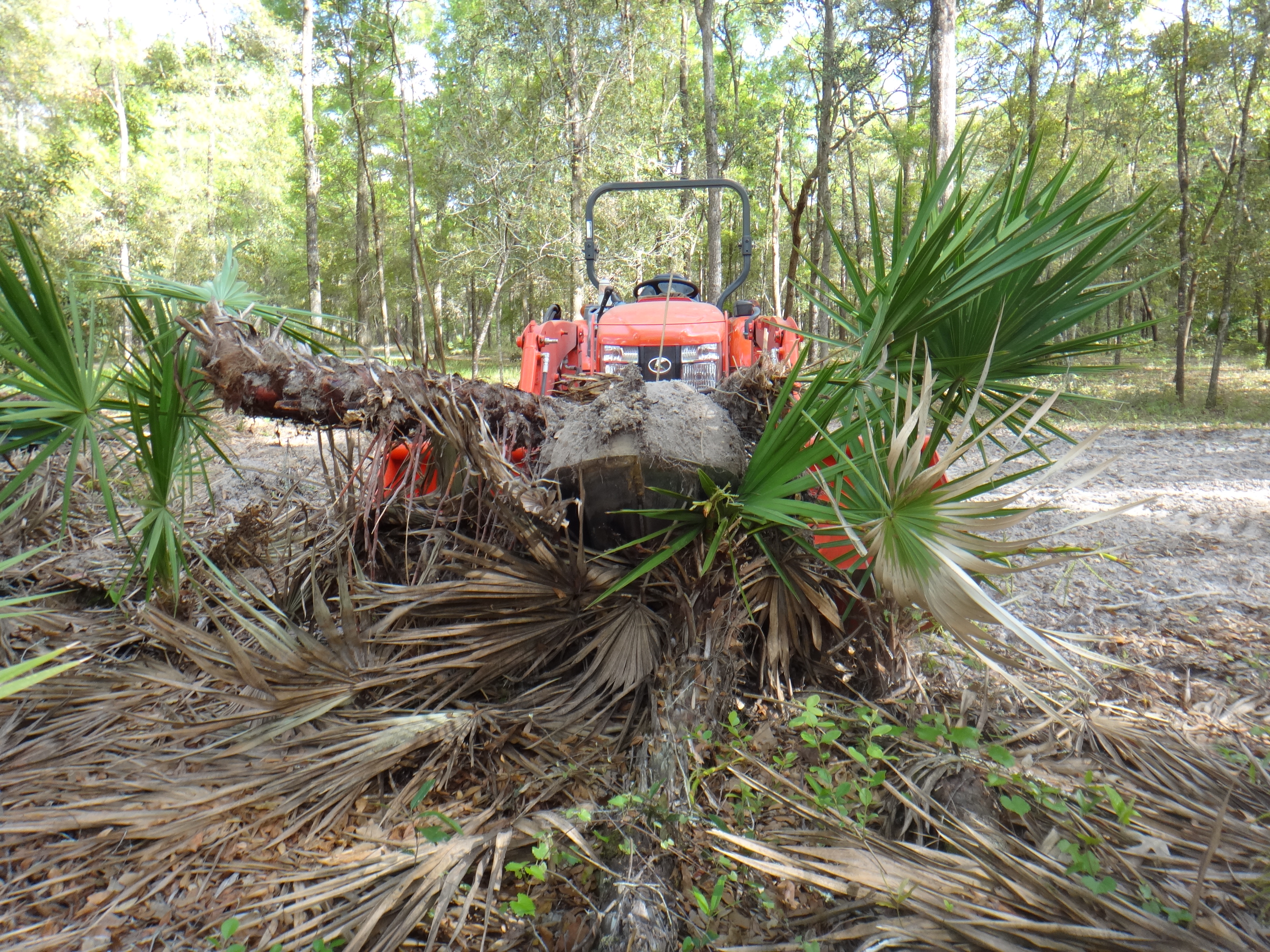

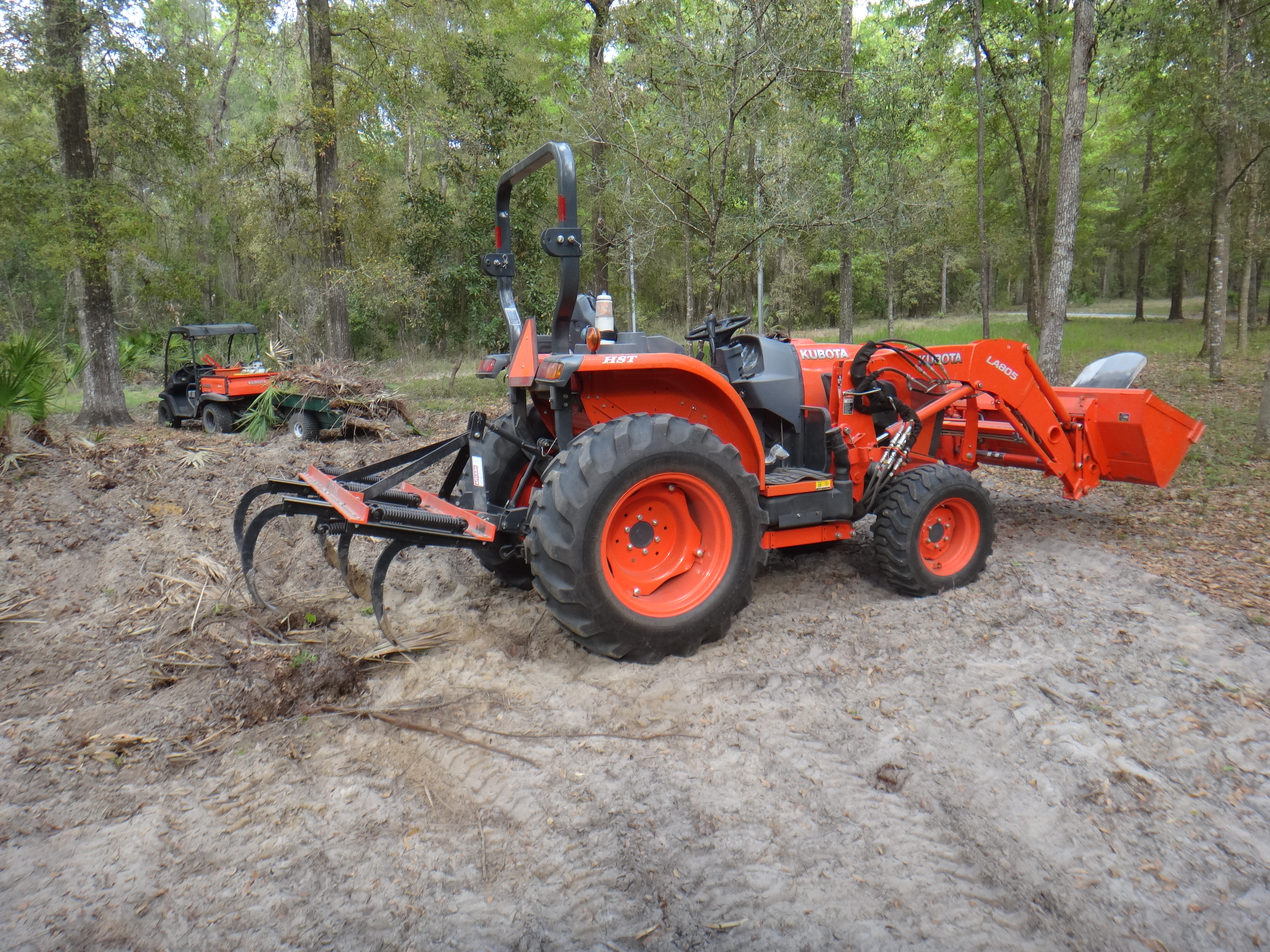

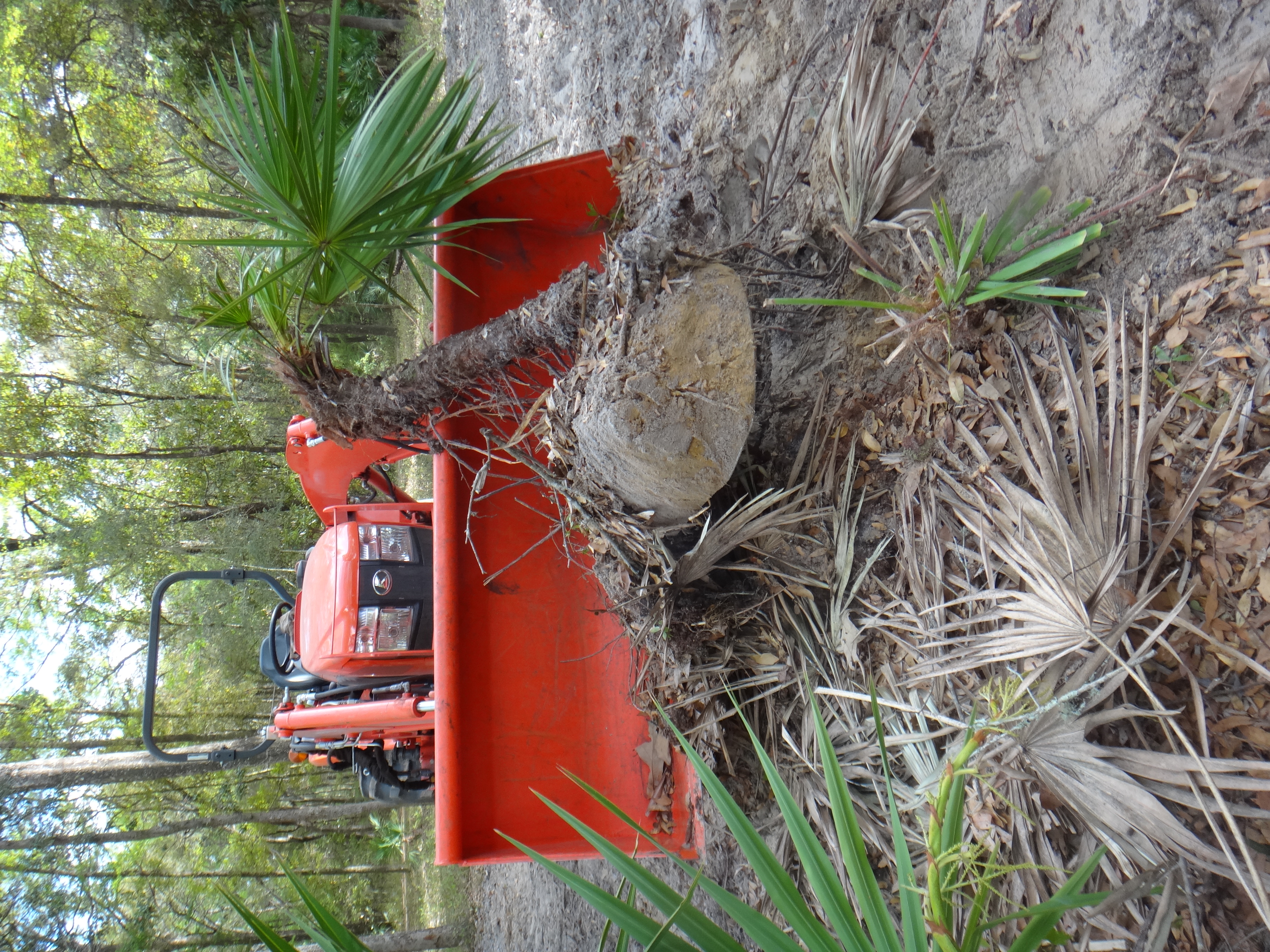

Excavated Palmettos with the Bucket Spade today.
In Florida, Palmettos usually grow in layers, sometimes four layers. When you examine ground prior to excavating plants, it does not look like that big a job. But the volume one takes to the burn pile is considerable.
Photo #1 Here is what the tractor operator sees positioning the Bucket Spade to excavate a Palmetto.
Photo #2 Small excavated Palmetto, on both sides of spade. UNTOUCHED BY HUMAN HANDS.
Photo #3 Larger excavated Palmetto. UNTOUCHED BY HUMAN HANDS.
Photo #4 Palmetto in the process of being leveraged out of sandy-loam soil. UNTOUCHED BY HUMAN HANDS.
Photo #5, #6 As Palmettos are excavated you begin to work over cratered ground. I use a spring-protected Dirt Dog (brand) Field Cultivator mounted on the Three Point Hitch to roughly level ground, at the same time raking out lower levels of small Palmettos and wild grape vine roots. Implement weight: 275 pounds.
Photo #7 Result of approximately 50 minutes of Palmetto excavation and raking.
