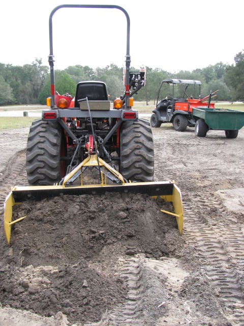

What makes the Bucket Spade a value to me is not the acquisition price, which is one time, but how much I have used it for non-commercial landscaping applications in ten years.
A compact tractor Backhoe is $7,000. The forged BS/BS is $469. The BS fulfills 40% of Backhoes applications, WHILE LEAVING THE THREE POINT HITCH AVAILABLE FOR AN IMPLEMENT, most often a Rollover Box Blade for me, to fill holes rapidly and function as FEL counterbalance. PHOTO: ROBB pushing fill dirt.
If one has 15' or more trenching to accomplish, a Backhoe is superior for that application.
