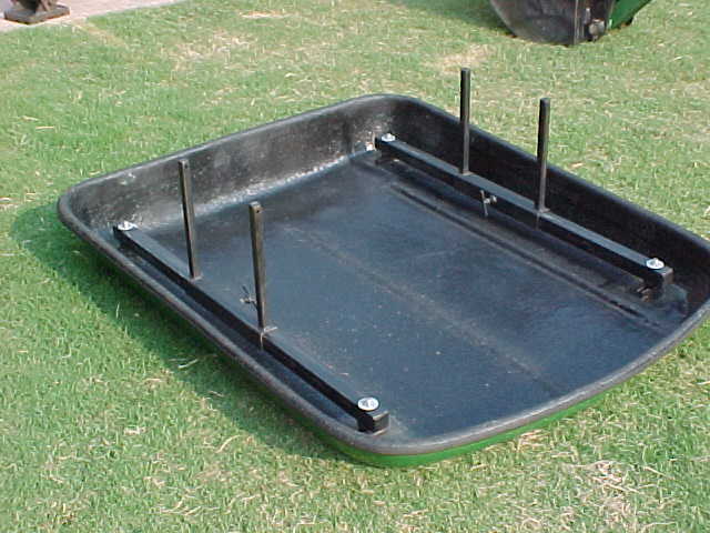

The bottom end of each riser has a hole drilled in it for a lynch pin. The pins act as stops when I raise the canopy, so the canopy is even, side-to-side and front-to-back.

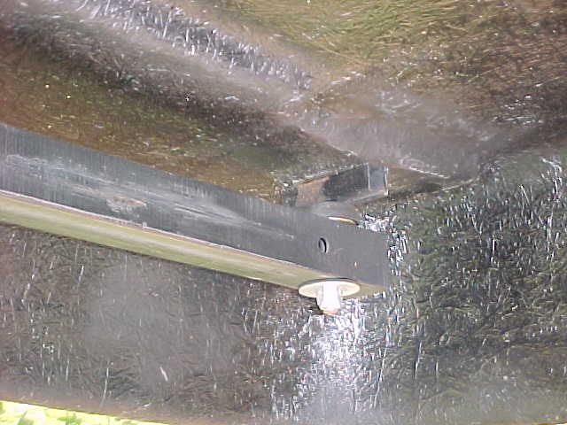

This view shows the risers welded to the bottom of the slider guide.

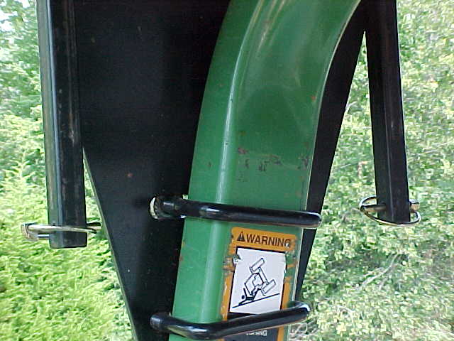

Here, the pin bumps against the bottom of the riser guide with the canopy in the raised position.

This shot shows how I dealt with a problem you probably won't have to contend with. I believe, Bob, that your 4710 and all the 4x00s and 4x10s have ROPS with parallel uprights. On the JD 55-series of CUTs the uprights of the ROPS slant toward the back of the tractor (from a side view) and they slant toward each other as they approach the top cross bar. That means that raising or lowering the U-bolt brackets that clamp onto the ROPS will narrow or widen the sliders. Drilling holes in the fiberglass top limits me to one position for the brackets on the ROPS (which may or may not be easy to find if the brackets ever need to be remounted). So, I made a short length of lipped channel from a piece of square tubing, and now there is a little leeway for adjustment....and no hole in the fiberglass top.

With the riser set-up on my canopy, just pulling the 4 lynch pins allows me to lift the canopy, sliders and risers right out of the riser guides. i.e. fast field removal/placement and no tools required. The brackets stay attached to the ROPS. Although the canopy is not heavy, it is just heavy and awkward enough to best be a two man job. You possibly could do it by yourself, but I wouldn't recommend it.
